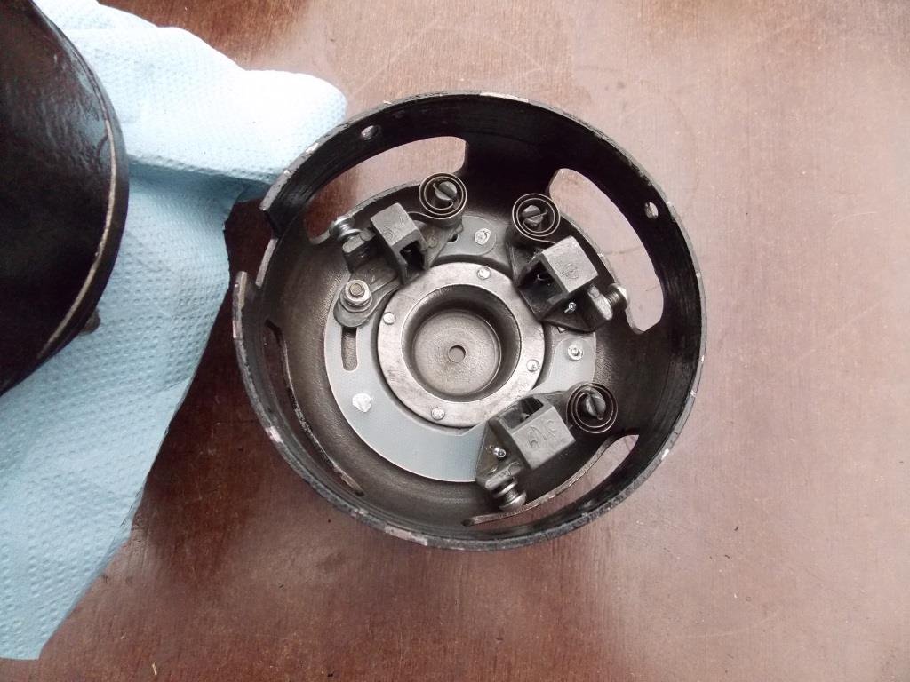

Preston,

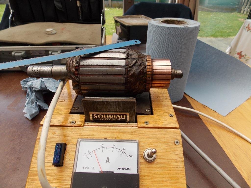

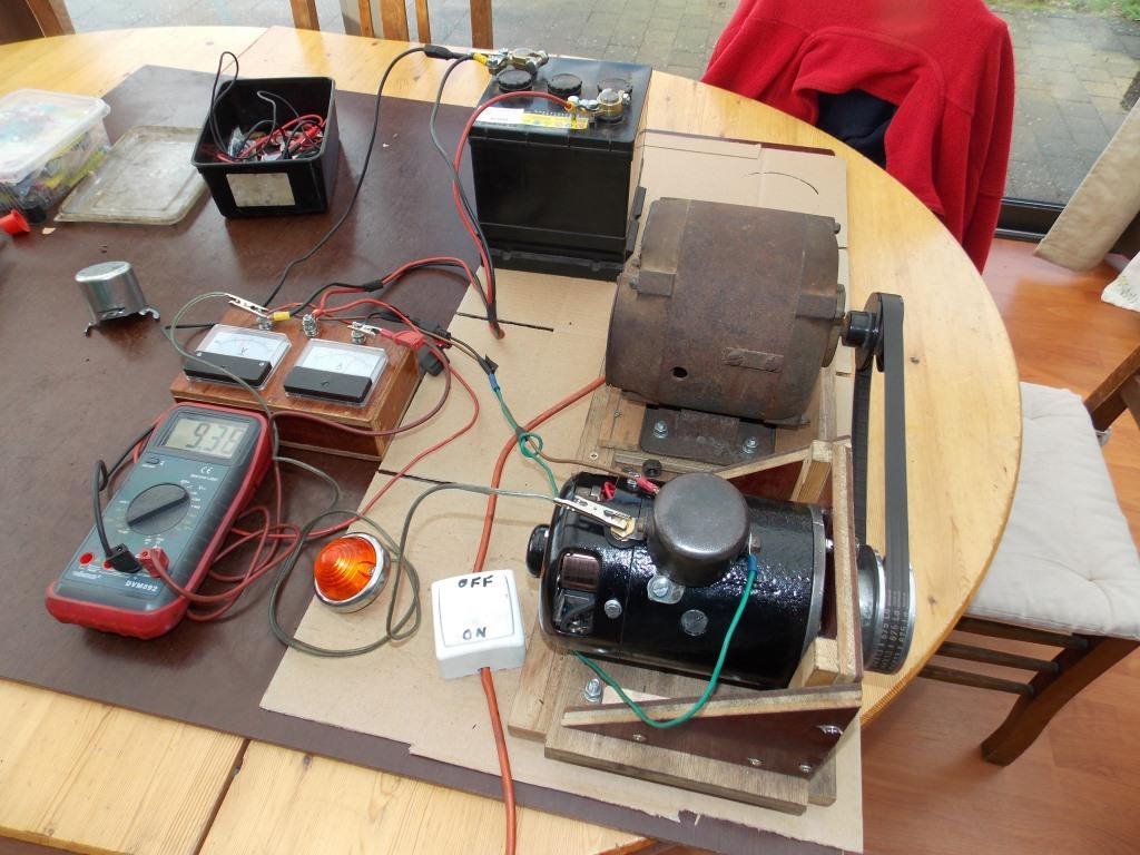

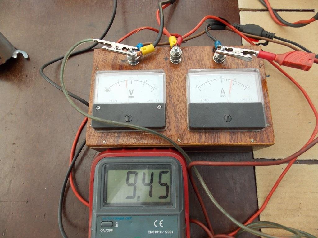

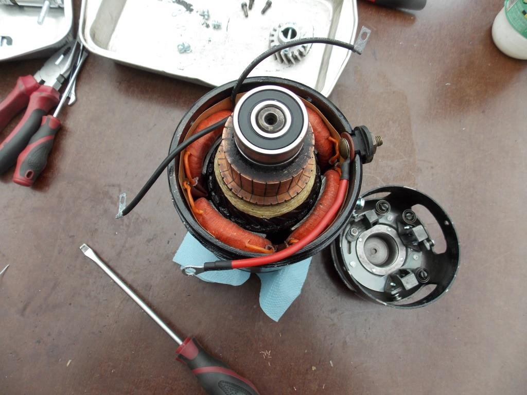

I just finished the rebuild of a generator.
Here is the way I put in the field coils , the brush plate and the terminal wire .
The other photos are from the test of the armature and the set up of the generator out put.
Maybe this will help.
Good luck
Andre

Make a control of the way the field coils are sitting in the generator body. The brush plate must be set on a way corresponding the way the field coils are set in the body.
Most of the generators have the field wires crossed for the connections. Some of them are not crossing. With the experience I have it are mostly the Canadian generators that have the wires not crossing but I have small experience and I can't walk on water.
Good luck
Andre

"The brush plate must be set on a way corresponding the way the field coils are set in the body."
That is just what I needed to know. Thanks Andre.

Preston,
I think your setting is just right. 6Amp is just ok.
Here is how I doo it.
If you watch my photo of the brush bridge, set the third brush all the way anti clock wise. Make the engine run at a brisk idle. Lose the four small screws and turn the brush bridge till you have about 1Amp charge. Tight the four screw and set the third brush till you have 5 to 6 amp charge.
Check the charge with the lights on and speed up the engine. charge should be 1 or 2 amp.
An old man told me to do so.
Job done
Andre
Belgium

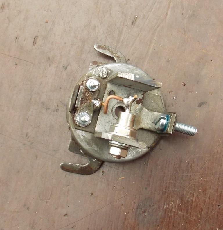

You can build your cut out your self with a diode available at most of the dealers.
In the photos my build 5 years ago and still standing. I works also great on a 12V system.

Re: Generator brush plate position
Post by Doug Keppler » Mon Jun 10, 2019 7:07 pm
Thank You Preston! after you told me about the VRs I emailed Fun Projects and they said they had a few left so got right on the phone and ordered one
1924 Touring car
There's No Substitute for Proper Lubrication
70shovelhead
Posts: 85
Joined: Mon Apr 22, 2019 4:57 pm
First Name: Preston
Last Name: Wells
* REQUIRED* Type and Year of Model Ts owned: 1923 Runabout, 1926 TT Truck
Location: Central Florida
Board Member Since: 2008
Post by 70shovelhead » Mon Jun 10, 2019 7:10 pm
