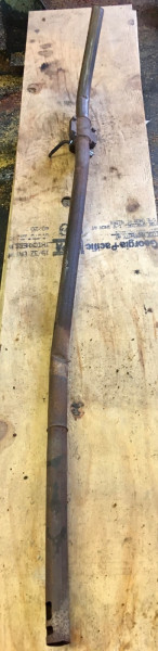

Trying to fix up the exhaust pipe that came with the T. It’s still solid enough to work with.
Looks old. Is it a possibility it’s an original or maybe an aged aftermarket?
Has an interesting seam going down the middle of it.

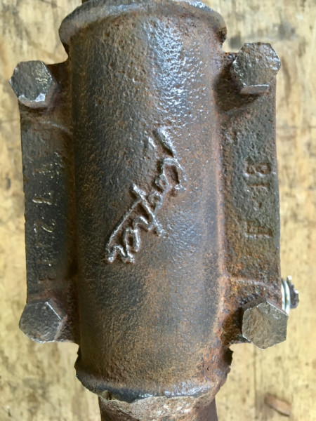

I managed to get the cutout to function with a new return spring. I can’t quite decipher the brand name. Obviously an add on.

I believe the script reads "Cooper".

Yuppers.... That's original

Cooper!
wow I see it. it was making me cross eyed. i wonder if there is a matching foot pedal for it.

The bottom end of the exhaust pipe in the top picture, gives away the fact that the owner has a late year, possibly 26-27 T and uses the muffler with stamped steel ends, and rear end of the exhaust pipe, actually is the center tube of the muffler assembly. Without cutting the rear 12 inches or so, off the pipe, a current available muffler can't be used. as they clamp on the pipe. If i'm correct, the owner mush use his original pressed steel ends and just replace the middle and outer shell. The outside shell measures 12" long and 5 " in outside diameter. I've forgotten the dimensions of the middle tube.Bryant wrote: ↑Wed Apr 30, 2025 10:02 amCooper!

You are correct I have a 26

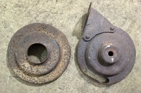

The original pressed ends where still on it but I removed them to Inspect. They are to bad to re use. The new repo muffler I purchased comes apart and fits nicely on the pipe.

As the new repro mufflers clamp on the existing exhaust pipe, I didn't think the repro front pressed end would work, so I don't know how you're doing it. The middle and outter shell, as well as the rear pressed steel end should work with no problem, though. P. S. Your pipe, although usable NOW, may go to heaven before you do, so it'd take it to muffler shop and have them make you a duplicate while you have a good one to copy..

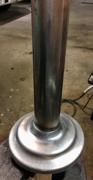

Fitting the pipe on the chassis it fits so close to perfect I don’t think the dent is anything more than a dent. I was just trying to use a part I had.
I can most likely make my own pipe as I have a bender.
But I will most likely use the pipe anyways because it’s still good. I will double check my muffler fit. Iam pretty sure it fit ok but maybe Iam mistaken.

Its an original pipe, so we'd expect it to fit "close to perfect". No one would expect a reproduction pipe to fit any better, unless it was made from Ford prints and specs. Maybe your original pipe has nothing more than surface rust. If so, you are indeed, lucky, but unless you take every precaution to protect it from future decay, it may, or may not, outlive, you. I wouldn't take the chance. If you've got a pipe bender and experience, why not take a 'shot' at it while you've got it off the car?Bryant wrote: ↑Thu May 01, 2025 3:26 pmFitting the pipe on the chassis it fits so close to perfect I don’t think the dent is anything more than a dent. I was just trying to use a part I had.

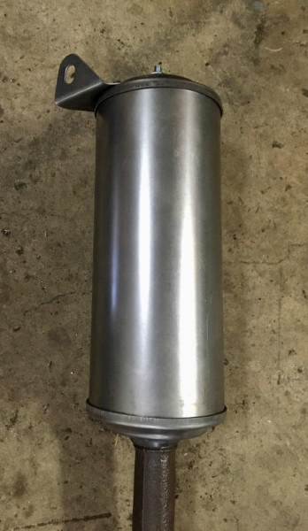

I don’t think it’s that complicated. I now have a pile of usable parts and fabricate for a living.
Dan the repo muffler disassembles with ease. I will not be using the inner pipe. The engine side muffler end needs resized to fit tight on the rolled ridge on the pipe. I will not just be clamping it on the end of the original pipe so it hangs out the back looking stupid
But as I said before I now know I most likely have an original pipe. The original question of this topic.

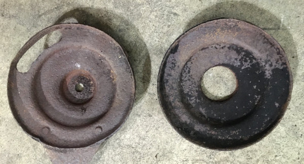

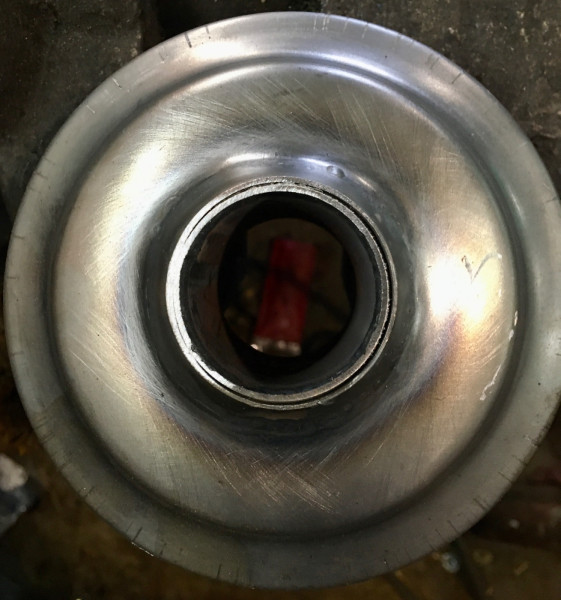

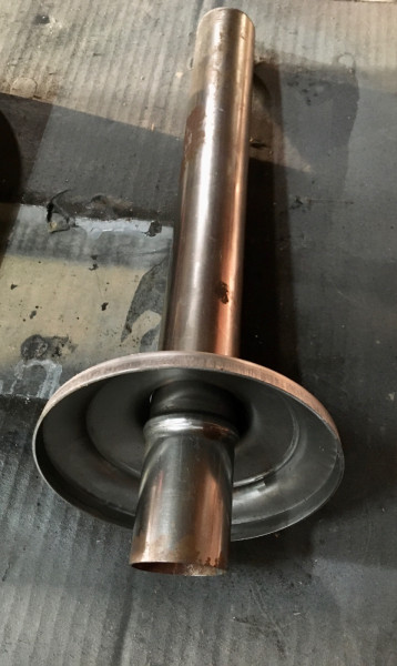

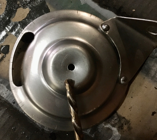

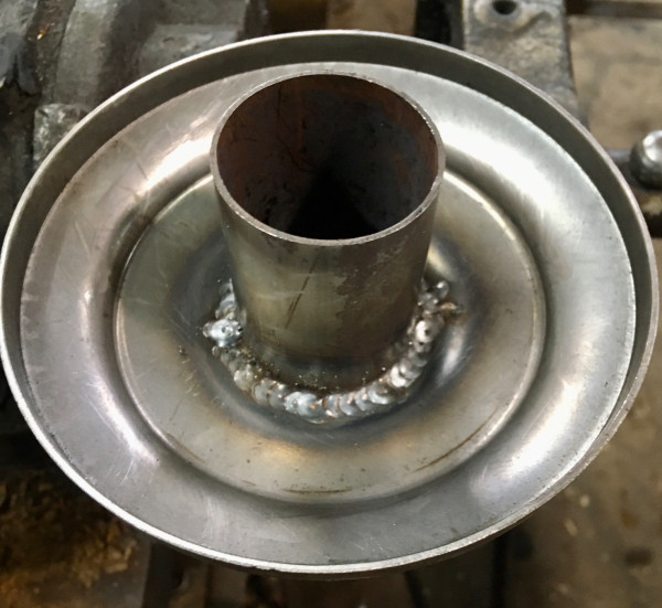

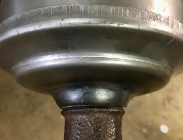

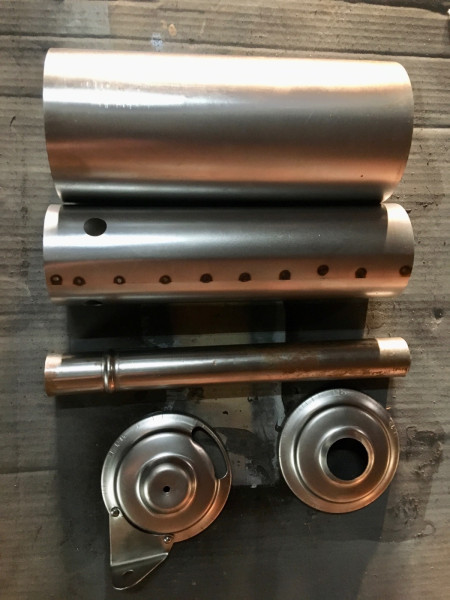

Because inquiring minds want to know. Here we go.
repo muffler broken down. engine side muffler end needs the ID shrunken to accommodate the original pipe bead because it is designed to be a slip over. Just flip the inner pipe around backwards. weld it. cut the excess off. nice and flush and smooth.“Whether you think you can, or think you can’t-you’re right.”

It may not be the way FORD did it, originally, but you seemed to have made it work.

Neat work Bryant. Your short length of pipe in the front cover allows it to mount exactly like Ford did it. You should use a heavy, slightly dished washer on the back end when assembling the muffler. This will spread the load over the whole inner "bump" on the end.
To my eye the materials used in the making of the end covers and the mounting bracket at the rear are lighter weight than the originals. Am I correct in this? Some original ends I have discovered seem to be pressed using TWO thicknesses of lighter material. Is this another example of Henry using scrap from other areas of manufacture?
The scoring marks around the outer flange on the ends indicates that they are pressings. i have mine made by a metal spinner using heavier material. The brackets are heavier too. On Canadian mufflers there is a deflector to direct gasses to the ground in front of the rear axle. This deflector is of lighter construction.

Allan, I have read on the forum, previously, about some of the pressed muffler ends, being of two layers of metal, laminated together. I think Ford did cut corners every chance he got.Allan wrote: ↑Mon May 05, 2025 9:42 pmNeat work Bryant. Your short length of pipe in the front cover allows it to mount exactly like Ford did it. You should use a heavy, slightly dished washer on the back end when assembling the muffler. This will spread the load over the whole inner "bump" on the end.

Henry Ford using scraps he had? makes me feel better about this whole project. maybe Ford did do things this way.
