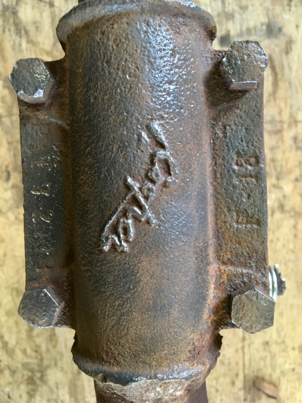

Trying to fix up the exhaust pipe that came with the T. It’s still solid enough to work with.
Looks old. Is it a possibility it’s an original or maybe an aged aftermarket?
Has an interesting seam going down the middle of it.
I managed to get the cutout to function with a new return spring. I can’t quite decipher the brand name. Obviously an add on.

I believe the script reads "Cooper".
Moxie26
- Posts: 2080
- First Name: Robert
- Last Name: Jablonski
- Location: New Jersey
Re: Original exhaust pipe?
Yuppers.... That's original

Cooper!
wow I see it. it was making me cross eyed. i wonder if there is a matching foot pedal for it.
boy they don't make them like they used to. 100-year-old exhaust pipe and it's still good enough to use!

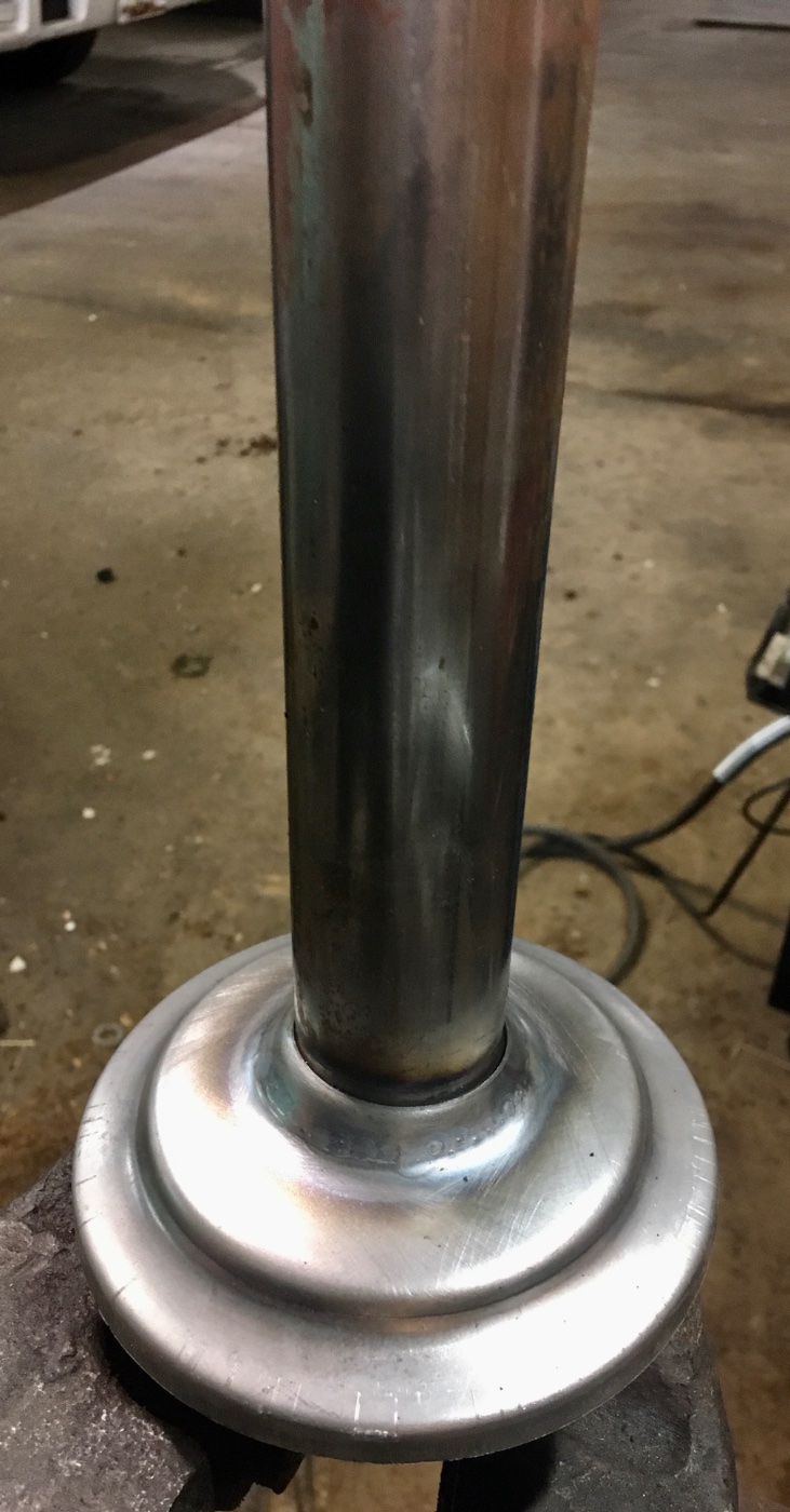

Because inquiring minds want to know. Here we go.repo muffler broken down.engine side muffler end needs the ID shrunken to accommodate the original pipe bead because it is designed to be a slip over. Just flip the inner pipe around backwards. weld it. cut the excess off. nice and flush and smooth.
Bryant
Topic author - Posts: 1236
- First Name: Bryant
- Last Name: Shafer
slide it over original pipe end and it will stop at the bead. drill 1/4 20 hole out to 5/16 to accommodate the original size carriage bolt. assemble muffler. wa-la
Bryant
Bryant
ModelTWoods
- Posts: 1598
- First Name: Terry
- Last Name: Woods
It may not be the way FORD did it, originally, but you seemed to have made it work.

- Posts: 7333
Neat work Bryant. Your short length of pipe in the front cover allows it to mount exactly like Ford did it. You should use a heavy, slightly dished washer on the back end when assembling the muffler. This will spread the load over the whole inner "bump" on the end.
To my eye the materials used in the making of the end covers and the mounting bracket at the rear are lighter weight than the originals. Am I correct in this? Some original ends I have discovered seem to be pressed using TWO thicknesses of lighter material. Is this another example of Henry using scrap from other areas of manufacture?
The scoring marks around the outer flange on the ends indicates that they are pressings. i have mine made by a metal spinner using heavier material. The brackets are heavier too. On Canadian mufflers there is a deflector to direct gasses to the ground in front of the rear axle. This deflector is of lighter construction.

here are the originals that where on it. they are indeed two-piece pressings. the mounting bracket measures approximately 12 gauge and the repo bracket measures 16 gauge. so, originals are definitely thicker.
Henry Ford using scraps he had? makes me feel better about this whole project. maybe Ford did do things this way.
Bryant
