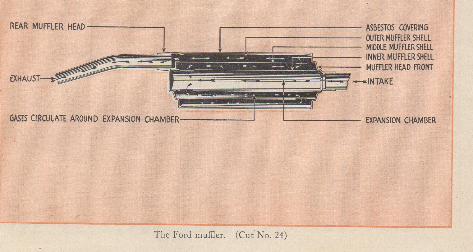

Kerry
- Posts: 1461
- Last Name: van Ekeren
Re: Muffler mounting.
I don't know why some think the engine pipe went all the way through the muffler?? from the earliest books on, it states to clean the muffler it can be removed without undoing the long pipe (engine pipe) slide back and drop after undoing the mount bolts, you have a few inches before the muffler will hit the back spring. One can see that the pipe is only in a few inches.

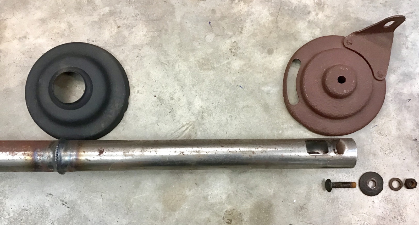

- Posts: 4388
The earlier mufflers up until some point in the very late '10s had a shorter head-pipe and just slid inside the front of the assembled muffler mounted by two bolts to the rear of the frame rail. This arrangement tends to rattle quite a bit, and some people use a variety of copper wire or brass shim gimmicks to reduce the rattling.
Later mufflers, the majority of production from somewhere around 1919 onward, had longer head-pipes which the muffler was assembled onto the head-pipe itself. They bolted with one bolt at the rear of the frame rail as the longer head-pipe provided the front support to the muffler.
The muffler shown in the diagram posted by Kerry is an early style. Later styles did NOT have the tail pipe on the back end as shown in the diagram.
- Posts: 7156
Mark is correct. The later mufflers did have the pipe going clear through the muffles to the back cover. They were bolted together as a unit with the exhaust pipe. This enabled mounting with just one bolt at the back, necessary flexing absorbed by the one pressed steel mounting. Fitting a clamp at the front will give the same rigidity as original set-ups, flex again being accommodated by the back mounting.
Kerry
- Posts: 1461
Found it in the parts books, the longer pipe in 1921, now I have to say I would and don't have any faith in clamping the muffler on a short engine pipe and relying on just a rear piece of tin bracket to hold it all up.
Reason for saying that is I had such a configuration on one of my T's and on a run it broke also taking out the brass flange nut as well. Wired it all up and tried for home, some miles later the fire wall was glowing. it made a good story for our club mag, someone with a little imagination had said I pis#ed on it to put it out but it was realy a can of degreaser (water based)

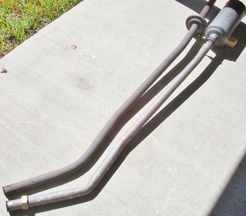

- Posts: 4052
Phil
Nice tooling!
Makes a real good roll just like original ‘21-‘27 exhaust pipes.
Here’s Orininal Smith’s first rendering I have with a welded ring for a stop. Your work is amazingly good.
Just needing the muffler shells to complete the exhaust system.
Nice tooling!
- Posts: 3913
- First Name: Larry
- Last Name: Smith
I had 50 of those made a few years ago. They all sold in a week! It's too bad someone with some bucks can't make them again. They used them from 1921 on. If Ford could do it, it can still be done. I have a NOS exhaust pipe, and it has the Ford script every 18".
- Posts: 3913
- First Name: Larry
- Last Name: Smith
One thing I just noticed, Dan didn't post the bar that goes through the last two slots that the carriage bolt goes through. The part number is 4032. Ford made two styles of these. The early ones were a channel, and the late ones were a simple bar. Bob Bergstadt used to have these, and probably still might?

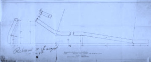

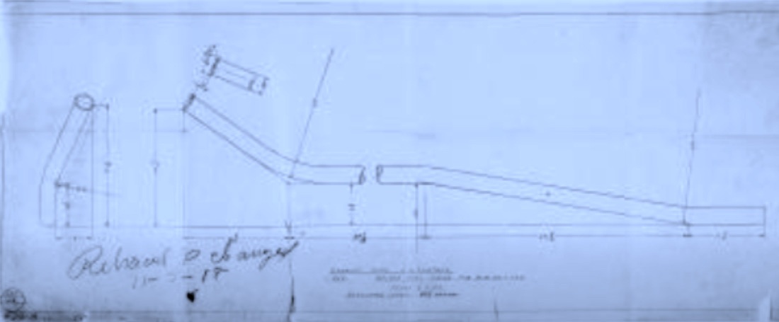

- Posts: 4052
I've found the vendor pipes to be satisfactory, but at times the original curves are missed by the modern pipe bending machines, that leave a crease in the bend. At times, I have had to shorten the pipe, as it was too long.
BTY, the exhaust pipe and muffler are on only one frame rail, they move with it, the two frame rails may twist in relation to each other in opposite ways, but a single frame rail won't really twist on its own.
Depends much on the muffler you mount, stock, repro semi-stock, or aftermarket tractor muffler
Factory print
Factory later x-long pipe and muffler front plate, '22-'27 (this is the one with pipe all the way to the end plate) Compared to repro pipe, (lower one in photo), modified with my bad bend
to help clear the hogshead, and clamped on repro muffler.
