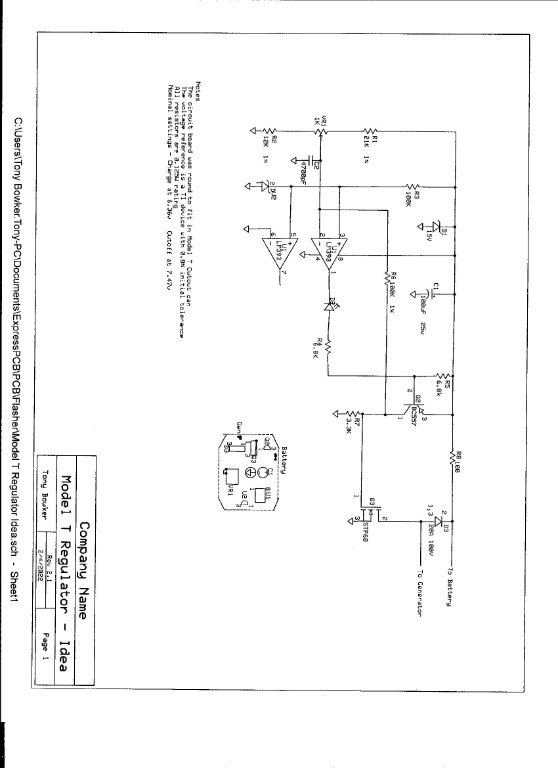

A $20 (or less!) DIY regulator, and other issues

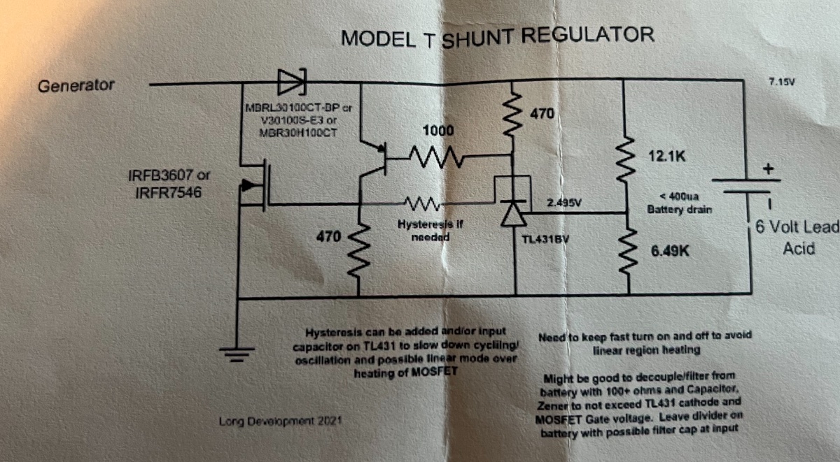

What do you think about this design it seems simpler to me. Sorry for the blurry picture.
Tom
Tom
JohnH
- Posts: 377
- Last Name: Hunter
- Board Member Since: 2002
Re: A $20 (or less!) DIY regulator, and other issues

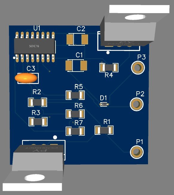

Very interesting. I've been working on something similar, using a programmable unijunction transistor and LED voltage reference. The simplicity and low component count is very attractive, and while it worked well on the bench, in car was a different story. It's easy to get a regulator working on the bench, but the generator has some peculiar characteristics that have been causing no end of trouble with the PWM circuits. The comparator circuit is far less critical because of its very low switching speed.
As it happens, I've only just got the TL494 working without instability in the car today. It needs a bit more work before I go driving with it, and then I'll have another look at the PUT circuit, and investigate your TL431 circuit.

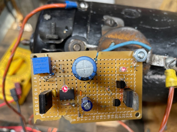

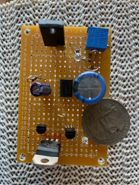

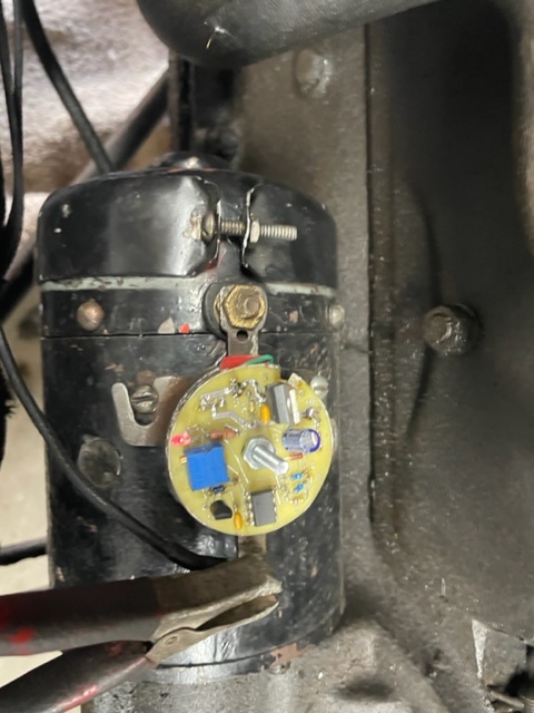

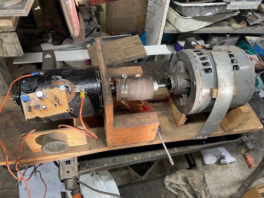

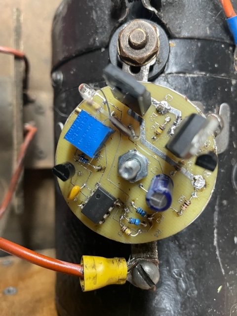

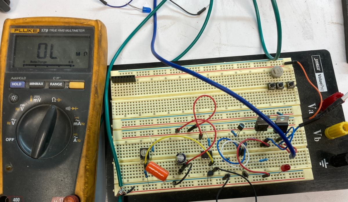

All the components have arrived for the testing of the 393 circuit. Well most as I forgot to order the 15 volt zener.
Below is a photo of the breadboard, I think it will compact down to fit in the Ford cut out housing. The quarter is to give some scale.

I applied power today and found my led only has 1.68v rather than the 1.9v on the prototype made by JohnH. I had previously been in contact with John who didn’t know the vendor part number for his led as he acquired them a number of years ago and of course they are unmarked.
I can reduce the 6.8k resistor to make it function but I wonder if this is a good idea if we are looking for a reliable and repeatable design.
I rather think I would prefer a cheap reference diode (LM385-1.2) which has know, stable initial and temperature characteristics. The cost is essentially the same as the led.
Any thoughts?
Any thoughts?

Tony, the LED voltage is not critical in itself. The important thing is that it is constant - which it should be. I found that with each of the LED's I tested, there was only about 6mV variation in forward voltage for the particular LED, over the normal operating range.
As expected, different LED's will have slightly different forward voltages, and for this reason a trimpot must be used to set the voltage.
It is quite in order to alter the 6.8k as you have done, if the LED voltage is such that there's not enough adjustment in the trimpot.
I totally agree, that for a repeatable design, especially if there's any ideas of using precision fixed resistors instead of a trimpot, that a precision voltage reference is preferable. A final version for mass production would undoubtedly be along these lines.
A quick glance at the data inidcates that the LM385 looks ideal for the purpose. Its current drain is in the low microamps which is far less than the TL431, or the existing LED. The choice between the 1.2V and 2.5V version is probably not critical, although I'd probably be inclined to go with 2.5V.

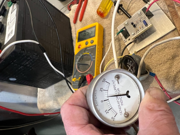

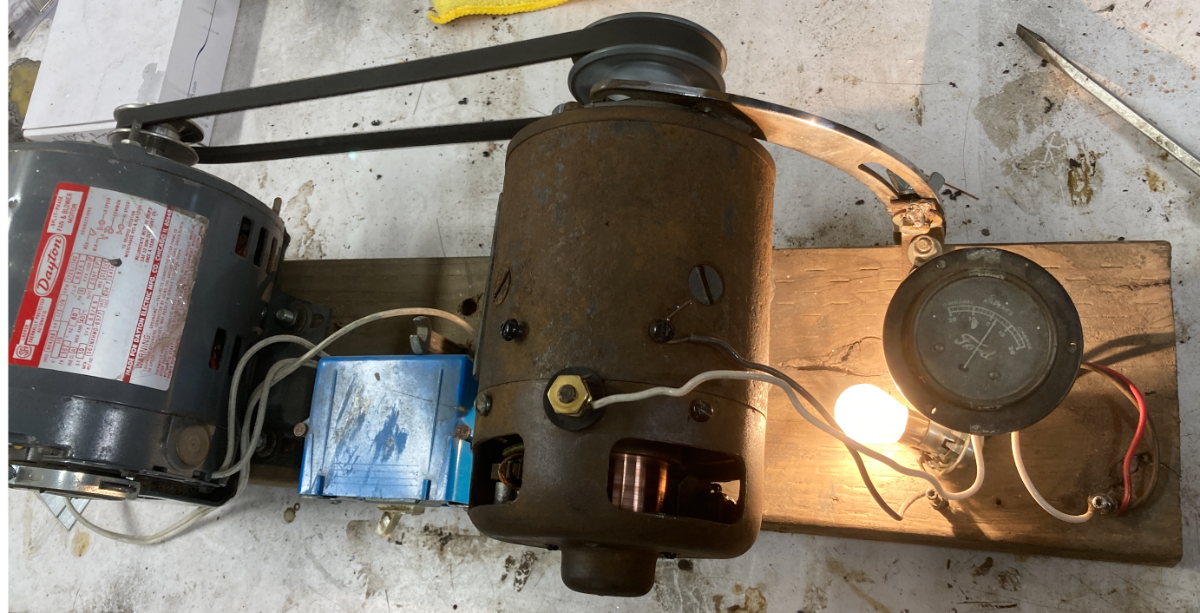

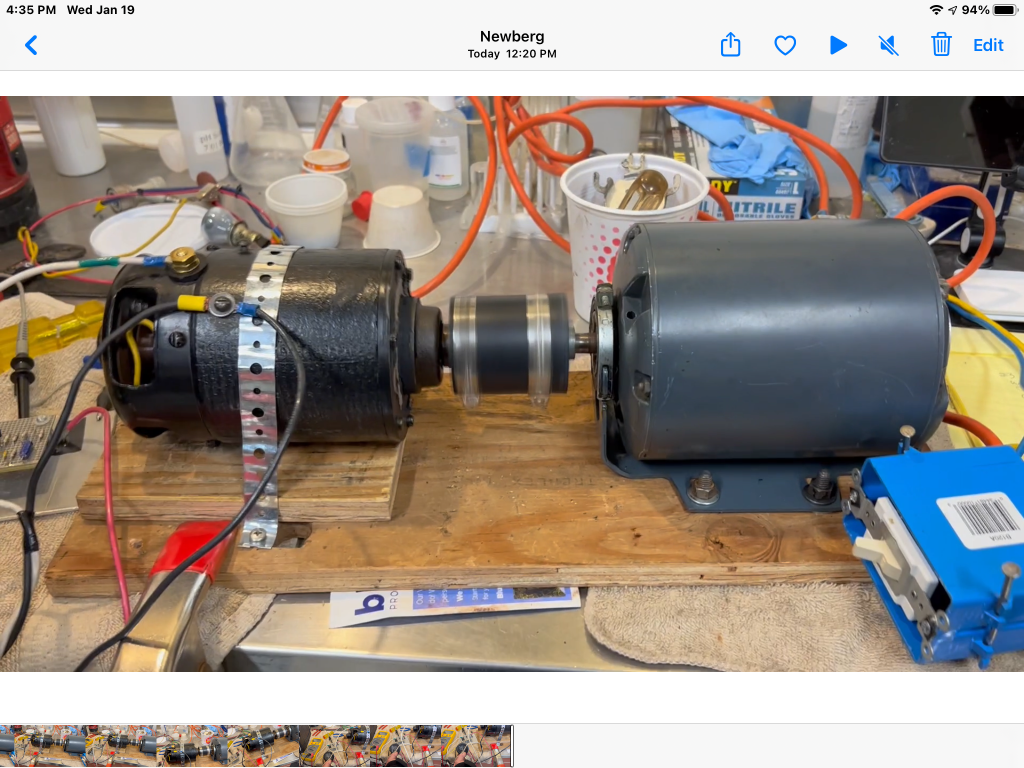

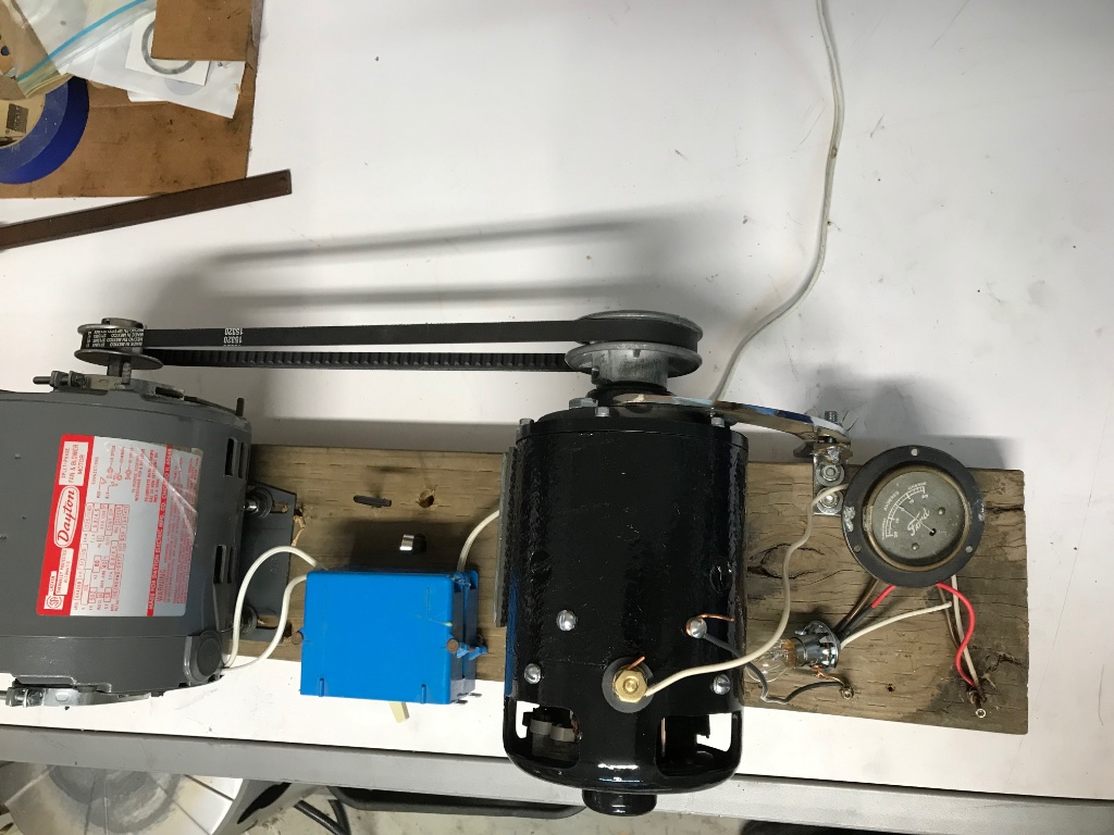

I connected up the rest on the bench and the device does function with a 180k across the 6.8k to compensate for the lower voltage of my led.
Right now the battery voltage goes from 6.3 to 7 volts. Which seems about correct.
Next is to mount the breadboard on a generator and try it out on my generator test fixture.
I agree that a 2.5 volt reference would be the best solution, my next version will use one. I have dug out an old SPICE circuit simulation program and I will verify if we can eliminate the potentiometer . I suspect with 1% resistors for the positive side of the LM393 and the 1% reference, we will be ok. The cost increase is only a few cents and we will save the cost of the potentiometer. I’ll have to learn how to use SPICE again as it’s been close to twenty years since mine was last used.

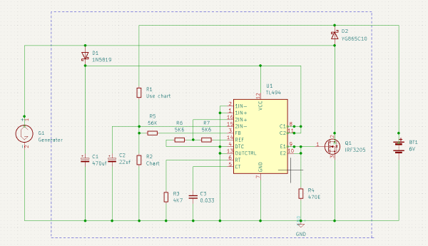

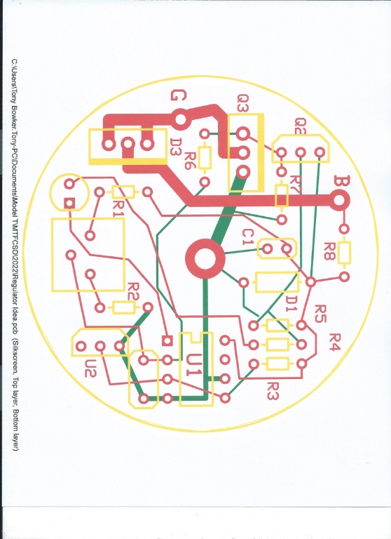

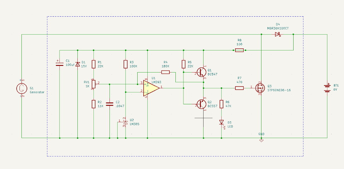

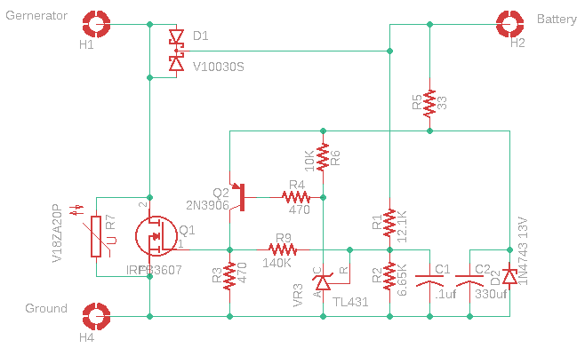

There has been quite a lot of discussion off-forum, and a lot of work going on in the Blue Mountains over the past couple of weeks, thanks to JohnH.
As a result of that here are the latest updated circuits for the two current designs using an LM393, or TL494. John's website goes into some detail regarding the operation of each design, it is well worth consulting if you'd like to know more about them.
There's a trimpot in place for the moment in the 393 diagram, but for the final design this would most likely be replaced by fixed resistors. Likewise the 494 diagram shows 'use chart' for the two divider resistors. We've yet to work on that but for an initial test at 6V the previous values we've put up should be close (and/or you could put a trimpot there as well).
What we need now is a few people to construct and test these, then maybe it'll be time to decide on which one to progress to a PCB, or perhaps both?
LM393 (note the updated cct, thanks to TonyB for spotting the reversed transistor!)
TL494
TL494

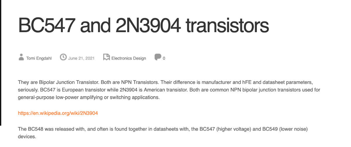

Jeff,
I suspect the BC series of transistors are much more common in our part of the world, and probably the UK, than with you. As you've identified the type isn't that critical in this application so what you have should work fine.
Actually I meant to leave D3 out of the diagram posted up here - it and R6 are entirely optional, they just provide visual indication of the regulator operating, which is useful for development but probably of little value on a regular car.
The Vref used in this LM393 cct is U2, a low-current regulator, however you could use a zener, and as you'll have seen John's used a handy LED in the past. You can also use bipolar transistors, except they tend to work around 6V and would need a divider, but many of these other options will require some current to operate - important given the 'always on' nature of the design. The other main reason for the precision regulator is that it makes the design more replicable - especially if one wants to construct several that leave out the trimpot and use fixed resistors to set the regulating voltage.
It looks like this thread viewtopic.php?f=2&t=24523&p=188170 gives some reasonable information on generator RPM.
I too have much unloved experience of making boards for various projects, hopefully once we've settled on a design someone will lay out a PCB and we can investigate options for making those generally available - Mike has had some good ideas around this, but first we need to have a few regulators prototyped and tested on cars before we go any further...
Luke.
Luke.

Jeff
As Luke replied D3 is and indication that the generator output is off. The voltage reference is U2 and initially we used an Led but the next version will probably use a low current (20uA) 2.5 volt reference. This will lower the static current as this circuit draws current even when the ignition is off. Hopefully we can get it below 1mA which is negligible.
Yes we could use 2N3900 family parts, and by golly they have been round forever. When I first left college at my first job in 1959 I initially used OC44 and then more modern 2N3904 parts. Seems like a lifetime ago.
The generator is geared to run at a 50% faster than the motor. So my test stand uses a1750 rpm motor which I suppose is equal to about 37mph in the car.

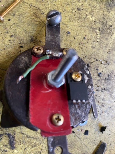

I now have to get out my big soldering iron to connect the circuit board to an old cutout base. Tomorrow is eye doctors all day, so Tuesday should be the big trial on an actual Midel T generator.

Scott you left me a little confused so I took out my calculator and when the generator is running at 1725, the T motor with will be at 1150rpm and with a 3.63:1 rear end and 30” wbeels the car will be running just over 28 mph. That’s a little slower than I normally run as both the 24 coupe and 14 touring seem happy in the mid thirties.
Interesting that you found the generator output falling off at higher speeds. I doubt it will effect our circuits that much as all the circuits do is to reduce the generator output. On the recent running around I thought the generator output was fairly stable once I moved off idle. Maybe at forty I’m so busy keeping it on the road I don’t notice the ammeter….

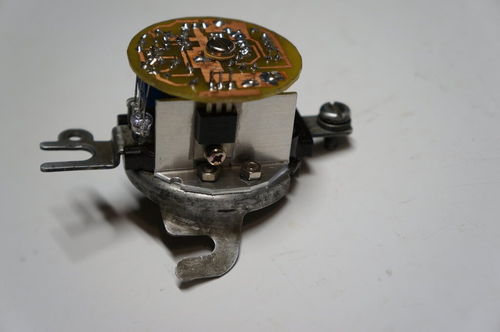

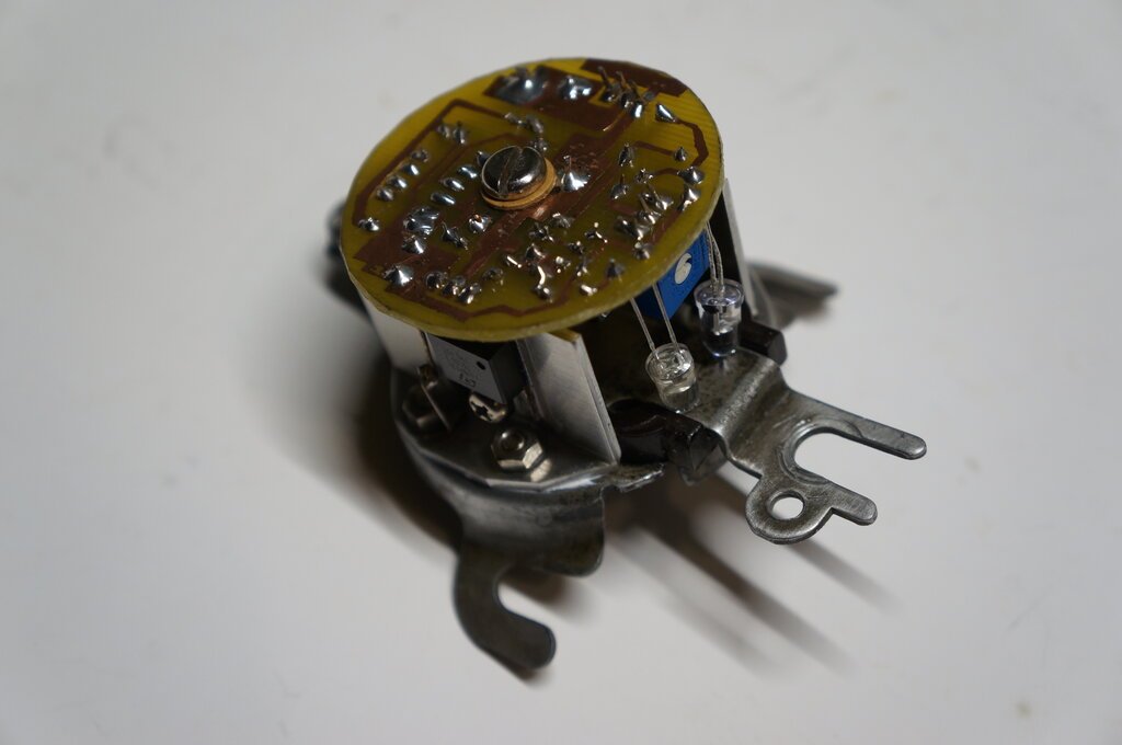

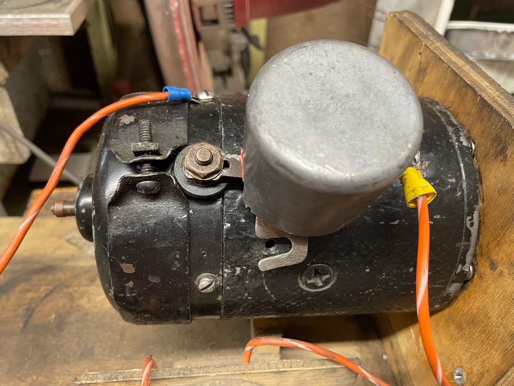

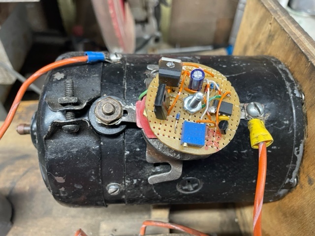

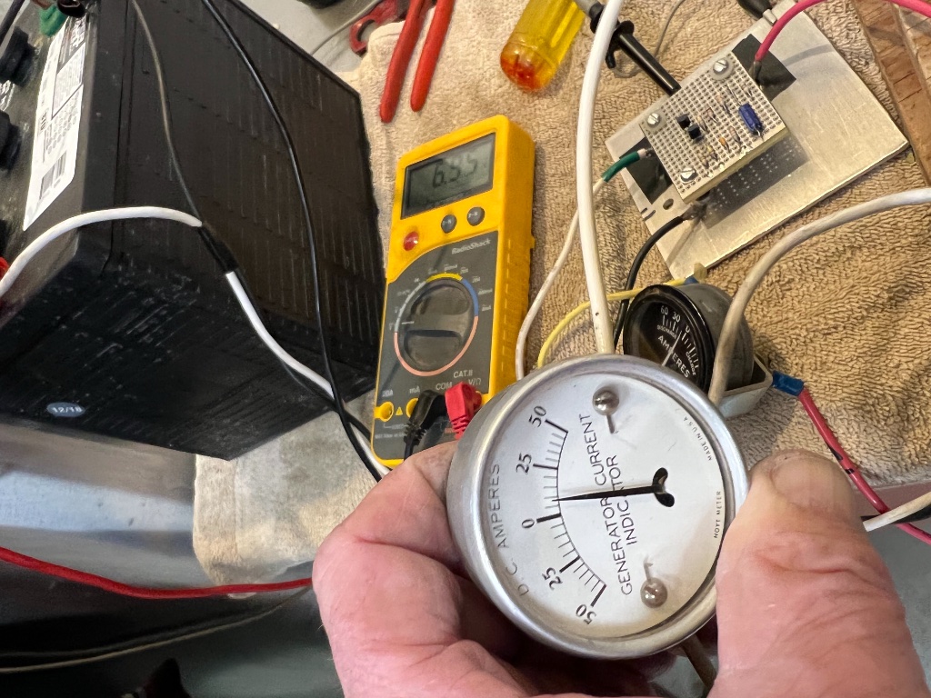

After a few mis-steps the LM393 curcuit is working on a generator.
My first problem was I dropped the breadboard and it cracked across the middle. I fixed that but the 22k resistor on the 393 pin 1 broke. I fixed that. Then the generator in the test fixture died. I’ve not investigated that yet. I found another generator on the bench and the controller works perfectly. I want to run it for a good few minutes checking the temperature of the FET. Also I want to disconnect the 2200uF capacitor to see if it provides any useful function. After that I’ll run the SPICE simulations and determine the values of the resistors on pin 3. My current set up is to turn the charging off at 7 volts and back on at 6.3 volts.
Are these good values to keep a battery fully charged?
Tony,
Good to see the progress. I'll be interesting to see what temperature your FET & Schottky get to without a heatsink.
The ideal charging voltage will depend upon the battery chemistry. As many Pb batteries today use calcium as a component the requisite voltage for proper charging is a little under 2.67V per cell or 7.4V for a 6V battery.
If it's not a calcium battery you should lower that to around 2.35V/cell or ~7.05V for a 6V battery.

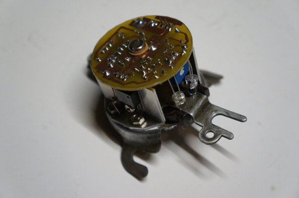

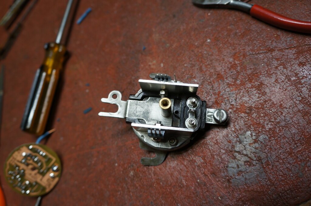

I have continued testing the breadboard and everything appears to be Ok. Initially I ran it for about 20 minutes and then suffered a failure. Two items were found faulty, the insulation on the base of the cutout failed and the soldered lead to the 22k on pin 1 intermittently broke. I think both were caused by the excessive vibration from my test fixture. For the next long term run I moved the board from the generator base and everything worked perfectly for 30 minutes. This included adjusting a load to the battery to increase the frequency of switching to about once per second from the ten per second cycle with no load. The FET only went over ambient by one or two degrees. At a continuous 20 amp load the diode ambient increased by about 7-10 degrees F.
My next move will be a new circular baseboard that will fit in the cutout case. It will delete the 2200uF capacitor, both LEDs, the potentiometer and add the LM385-2.5 voltage reference. I also have to rebuild the cutout base to eliminate the short to ground.
So don’t look for too much for a couple of weeks unless someone is working on a PCB layout

The 2200uF was a legacy of the FP regulator which I initially carried over to the LM393 comparator design. As I subsequently found, the 100 ohm & 100uF provide sufficient filtering in themselves, as observed on the CRO. No difference in circuit operation has occured by deleting the 2200uF. Notes on this are in the design article https://www.cool386.com/ford_regulator/ ... lator.html

Tony,

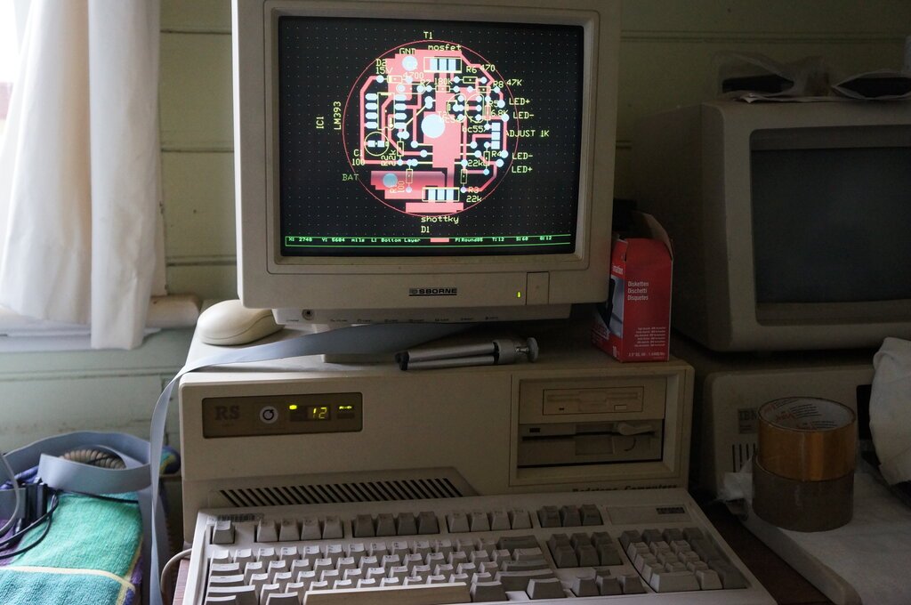

A few posts back you'll have seen the concept PCB I came up with for the 494. I've not done one for the 393, there will be people out there who are far better at that sort of thing than me.
Before considering a PCB design we need to be assured each cct design works well for a number of people. Then things like placement of the high-current components, and whether to use through-hole or SMD for the board components will come into play. Efficiency matters too; although I did a circular PCB I expect it'd result in quite a bit of waste if it were being processed somewhere, and could be difficult to produce at home, so it may well be better to use a square board for the final layout...
For you, as you know, it's a pain having to make a prototype board from ground up, however your experience will give valuable input into confirming the cct design - so thanks for trialling it out and providing feedback.
Luke.

With the help of a friend we have built a prototype based on TL431 design I posted. More details to come. We have been bench testing and hope to test in a car soon. Looks promising
Tom
Tom

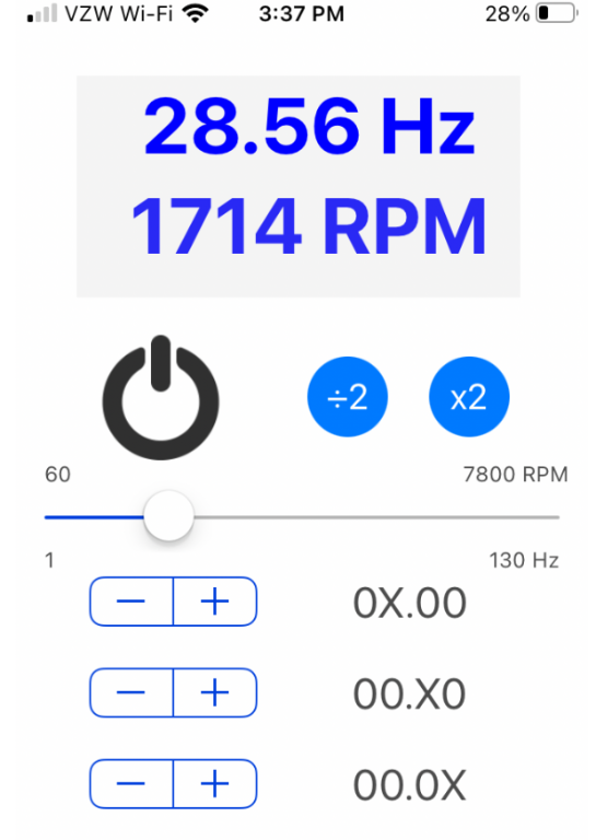

Im so close... Of course I didn't have a generator laying around so I had to build one from an old core. So that took me 1/2 the day, mostly bc the unit I started with was a rusted, sticky, oily mess. I just finished putting my Starter/Generator rebuild station together so that was timely. I forgot how much I detest rewrapping generator field coils.... But the Generator worked right out of the gate so I haven't lost my touch!
Everything is mostly hooked up and the circuit is built. I forgot to order the 15v zener, but I have some 7.5v zeners. 2 in series should do it. I'm still recovering from COVID from last week so I completely ran out of steam this afternoon. I'll fire everything up tomorrow (hopefully, no fires). I did completely fill my shop with smoke from a battery charger that completely bit the dust. That was entertaining. I now know my new panel & circuit breakers work.
My test rig is running at 1714 RPM at full blast (I use an app called Strobelight on my iPhone to get RPM). I'll be able to vary the RPM and current output of the gen by loosening and tightening up the belt. That will be interesting. Now I just need to find my frigging Oscilloscope. I know I packed it before I left CA...
AdminJeff
Initial results are interesting.
I still can't find my oscilloscope, but from what can tell, the circuit does work. Mostly.
Gen was set at charge current of 4.5A @approx 1700 RPM
Brand new 640 CCA 6V battery, resting voltage is 6.45V
In shunting mode (when Q3 is conducting, ie we're not supposed to be charging):
charge current at battery = 1.8A @8.3V
Q3 temp reaches 300++ degrees with a substantial heat sink. It gets VERY hot. D4 gets warm to the touch.
I couldn't get the circuit to shunt completely (unless I biased Q3 manually) so it always charged.
In non-shunting mode ( ie battery is charging)
charge current at battery is ~2.5A @8.9V
adjusting RV1 changes the charge current up and down, as expected.
I did order a few of each component and swapped out Q3 just to see if anything changed, but the 2nd one got really hot as well.
If the rotation speed increased and the gen were to put out 8-10A, I'm not sure Q3 would survive very long.... or it would need a much larger heat sink.
Anyway, these are my initial observations. I'll keep looking for my oscilloscope. I hate to do it, but I might have to buy another one.
AdminJeff

Doesn’t sound good and based on my experience with the same circuit, I believe something is wrong.
Once I had found the broken 22k resistor on the lm393 pin 1, mine switched very slowly. The speed with no load on the battery was charging for about a second then off for 7 seconds. As I increased the load on the battery to about 5 amps it was on/off for about one second. Then when I increased the load to 20 amps, the generator was never turned off.
I had checked my setup prior to putting the board on the generator by connecting the circuit to a battery with a bulb as a load. Then I connected a battery charger to the battery terminal. I kept it on until the second led came on and immediately took the charger off. All this while monitoring the battery voltage. In this way I could be assured it was wired and working correctly.
Where I failed was when I cracked the board when connecting the mess to the generator.
I hope this helps.
I hope this helps.

It sounds as if the switching transistor isn't being driven correctly. If you could locate your 'scope it'd be good to check the gate waveform/voltage.
John E,
It gets around a bit, that regulator
Luke.

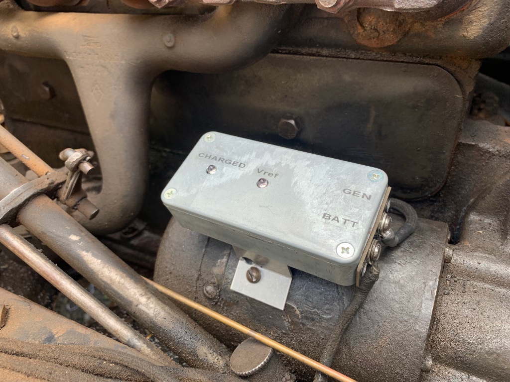

I’ve finished my second prototype
I left the forum a couple of weeks ago to build up a second prototype that I hoped would fit in a Model T Cutout case. After studying the circuit for a while I had some personal technical reasons for not being happy with the npn/pnp driver, so my version is revised with one less transistor and slightly less current draw when the generator is off.
Initially I also deleted the led attached to the output clamp but I subsequently missed it when testing, so I put it back which explains the 2.1 version. I also used a precision voltage reference in place the original second led.
So this is my current schematic. Next was build a second prototype to fit into the existing cutout case. The insulation on my original case failed and shorted out the generator permemently. I purchased some thin insulation and a day later I had a new insulation set. Then I made a round board to fit in the case. And then adjusted the major component to fit around a central mounting and ground screw. A photo of the finished design is below The position of the led is not optimal as it cannot be seen with the cover on!
Of course with the cover on, it looks just like the original. I have not had it on a car but it runs just fine on my test fixture which is a good simulation, indeed the vibration on the fixture is greater than on the car. I have run the generator for about an hour with minimum load on the battery when the led is on most of the time during which time nothing overheated (especially checking Q3). When a large load was applied to the battery (5 amps) the circuit was firmly turned off, again nothing got hot (especially D3). The voltage a which it stops charging is about 7.2v and charging is resumed at 6.3v. These numbers were confirmed by a SPICE simulation which gave theoretical results of 7.19 and 6.19. The theoretical range of adjustment with the 500 ohm potentiometer is about 0.14v though this has not been confirmed on the prototype as yet.
So yet another “393” model works with no apparent glitches.

AdminJeff
Tony,
I like the simplified design. I assume that you left the unused 1/2 of the op amp there "just because"? It serves no purpose that I can see... I finally spent some time with the original circuit today trying to figure out why it generates so much heat, and found that in fully charged mode, the gate voltage at the MOSFET isn't sufficient to turn it on completely, thus operating outside of full conduction and therefore generating excess heat. That puts the issue squarely in the emitter follower circuit. Either I have a leaking NPN transistor or something else is going on. I ran out of steam today, but I'll try your new mods tomorrow.
Do you have a larger version of the schematic? It's hard to make out the values of you resistors.
I did buy a new oscilloscope as mine is hopelessly lost somehow in the move, so I might try the TL494 circuit as well, now that I can "see" what the PWM is doing. The only real benefit of that design that I can see is the lack of ammeter fluctuations.
AdminJeff

I installed the regulator on the 24 coupe generator and it works just fine. Initially after startup the ammeter is charging at full rate then after a few minutes the needle swings back and forth and a couple of minutes later it drops to zero. I measured the voltage at the battery and it read 6.37 volts. I turned on the headlights and the generator started up again.
Next I have to puzzle out if I want to put holes in my cutout cover to see the led and adjust the potentiometer.
On the second comparator, it is there and I alway connect the inputs to unused parts just to avoid any unwanted problem such as superiors oscillation. I have puzzled how to use it. My objective to use it was to reduce quiescent current when the ignition was off. I came up with nothing!
Jeff
If you send me your email address I can send a better copy of the schematic and a full parts list.
This goes for anyone else who needs more info
PC board
I am going to attempt to design a PCB. It will be based on my second prototype wired board.
Wish me luck.
Jeff
PC board
Wish me luck.

AdminJeff
Tony,
I'm on your updated design with the single transistor switch.
After I figured out and corrected the wiring on R6 to U1, pin 2, I saw the exact same thing... not very elegant. It would be better if we could achieve both hard ON when battery is fully charged and hard OFF when charging or large current draws. During the swings, the comparator is in that dreaded middle ground, ie not enough hysteresis. This is when I saw the MOSFET heat up substantially. In that state the MOSFET is sinking a few Amps because the gate is not fully triggered. When fully triggered it exhibits a very low current draw.
I know I've seen op amp comparator circuits that can better account for this effect, especially with noisy signals (which we have here in spades), but it does add to the complexity. I'll have a look around and see what I can find. A really good discussion of this effect is here
https://www.analog.com/en/analog-dialog ... resis.html
Thank GOD I got another oscilloscope... I'd be lost without it.

The NASCAR race from LA was boring and I thought I would give an old simple PCB layout program as try. It seems to work, well at least I have a picture of what a layout could look like.
This is the layout. The red lines are the copper on the component side. Most lines are 0.01” except for the high current line around the diode and clamping FET.
The green lines are the copper on the “solder” side, that is the opposite side to the components.
The yellow lines are the silk screen lines. This being a low cost prototype, they may be deleted on the first run of boards. For that reason I added the various component designation in copper on the component side.
The board is round, well actually it’s a series of straight lines but it’s close enough. It’s about 1.90” in diameter with a mounting and signal ground hole in the center. Actually the center is 0.012” off center as I built it on a 0.025” grid.
The schematic is on my previous thread, originally it had a small error which is now corrected.
Next see if I get a few PCB fabricated.

AdminJeff
Tony,
Ok I’ve verified your new circuit. I had better luck with a 75k resistor for R6. I also put a 0.0068uf cap across that resistor and it seemed to help dampen the on/off oscillation. After researching hysteresis on several sites, a couple recommended this approach when in noisy environments. As best I can see, there is severe noise spikes at about 38khz. I didn't do the math on the cap value but something small like I used is helpful in dampening that spike. I’m sure others with a better scope can get closer to the noise spike frequency and a filter calc might get the cap value closer.
My ON voltage was 6.4v and my OFF voltage was 7.4v. Very close to yours. I’m not sure we should get rid of the trim pot as resistor tolerances of +/- 5-10% will necessitate fine tuning the trip points.
Anyway I ran the test setup for a couple of hours using a 4ohm 50 watt resistor and a light bulb on the battery as a load so that it drained the battery slowly. My on/off cycles were about 4-5 minutes and there was no oscillation after changing R6 to 75k and adding the cap in parallel.
I also varied the charge rate on the gen and settled on 5A.
AdminJeff

There is obviously a constructional fault if your MOSFET is not being driven to saturation. The comparator output is either on or off - it is not a linear device. After many hours on the bench never once did I see the comparator output midway between on and off. It changes state within microseconds.AdminJeff wrote: ↑Sun Feb 06, 2022 6:59 pmIt would be better if we could achieve both hard ON when battery is fully charged and hard OFF when charging or large current draws. During the swings, the comparator is in that dreaded middle ground, ie not enough hysteresis. This is when I saw the MOSFET heat up substantially.
After driving it with now for something like 300km I'm very satisfied with the performance.

Yup. Tony's original "new" design had the feedback resistor on the wrong input of the comparator. I figured that out and replicated his results above with a small mod.
Jeff

Luke
Topic author - Posts: 617
- First Name: Luke
- Last Name: P
- Location: New Zealand
Jeff,
I've responded in group email suggesting that you and Tony might want to try the design at the full output of the generator, as well as at the 5A level. That way the FET will be sinking max current, and the Schottky passing max, so we'll get to know what, if any, heatsinking is required.
I agree the 3524 is a useful looking IC, however I'm still a proponent of the 494 which in practice should provide similarly smooth PWM control and perhaps be more accessible.
Hopefully Tom will also let us know how his 431 design is going. At that point I think we might have enough designs to be going on with, although I guess we could consider a microprocessor design using something like an ATtiny85 or similar. That'd make the voltage settings easy but perhaps make it less attractive to the home builder...
Tony,
I think there's no doubt these are original designs (as much as is possible given we can't stray too far from the chip design parms and typical app notes etc) regardless of where they end up.
Good work with the PCB, it will be interesting to see the result.
Luke.
Tony,
Luke.

In all my tests my generator has been set to 10 amp output.
Previous to this work I use a regular diode in place of the mechanical cutout and they never overheated.
My second prototype has run for over an hour with various loads and has not “burned up”.
John has run his model some 300km, which at 30mph, is approximately six hours.
Please don’t spoil our fun, if you don’t like what we are doing, don’t read the thread.

I just wanted to share some information about the design I was able to work on. First I was just the tester as this electronic stuff is a little beyond me. It was my best friend, an electrical engineer, who designed this after I asked him what he thought about designing a regulator for the model t. I gave him all the information that had been posted and he came back a said I can do that. And here is we have. I should also note that I have been using a FP regulator for 20 years with no issues. So I have been quite impressed with the idea of having a regulator.
“The hysteresis in this design produces a 1-2 second on-off cycle between ~6.7 and 7.2 volts, no charging or cycling above, no cycling if enough current is being drawn. The value of R9 can be reduced if you want slower on-off cycles and wider voltage break points. R1 and R2 may need to be changed if you want much more hysteresis to keep charging below 7.2V. I would recommend that both power devices be heat sinked and connected like the original design. 10 amp traces would need to be around 300 mils wide, best to leave both power devices down on the can base with direct connections to the terminals. About the best you can do on the Schottky is .5V and at 10 amps would be 5 watts. Junction to case in air is 60 C/W which would put the junction at 300C. Even at 5 amps 150C is too hot. If the MOSFET is driven with at least 6 volts the on resistance is low enough to only produce around 1 watt. This means no diode drops and minimize the drop on the filter resister. I also recommend using the Varistor, R7, to protect the MOSFET. The Varistor capacitance helps with dv/dt breakdown and gate shoot through and hard clamp protects from overvoltage and ESD. Zener D3 protects Q2 and VR3 from over voltage. C2 should be a low ESR style like A759MU337M1VAAE22, the value could probably be reduce but its not very large or expensive. Parts should be chosen for at least 85C and preferably 105C or 125C. The engine compartment can be very hot. Also, I would suggest very similar mounting to the original design with multiple mounting points for the PCB which can also bring the connections to the board. Lots of heat and vibration to consider.
Hope this helps (my friend Paul)”
Tom
Tom
AdminJeff
VERY interesting. I just ordered some TL431s. I’ll breadboard this design as soon as I get them.
AdminJeff.
AdminJeff.
TonyB
- Posts: 663
- First Name: Tony
- Last Name: Bowker
- Location: La Mesa, CA
This my second try as the pictures were too large and some how the whole post dissapeared.
My PCB arrived and I populated one for test over the weekend. There was some finger troubles, I must be getting too old for this game. After a couple of challenges it works fine on the bench and on the test fixture. It worked quite well but the switching voltages are a little different from the simulation which is concerning. I then installed in the coupe. Again it functions but just before it reaches fully charge it oscillates s little and once at full charge turns ON and OFF as expected. Testing was cut short as the coupe ran out of gas
The only difference I know of between the test fixture and the coupe is the age of the generator. The one in the coupe is probably 20 years old and the commutator is well worn. The generator in the fixture is essentially new with nice fresh under cut on the commutator which may reduce electrical noise.
Today I refilled the coupe with gas and tried again this time with more success. Overnite I added Jeff’s capacitor across R6 (the feedback resistor) and it quieted down the on/off oscillation and made the voltage setting more or less agree with the simulation.
So we can add mine to the list of working LM383 models that that work well.
I’ve got a couple of tours coming up but I’ll build up another model for the speedster

I had the PCB fabricated because it was fun. I have little interest in building a hundred or so models but anyone can feel free to have a go. To that end I will clean up the design with any additions the groups wants. I have priced out a round version of my design and the quote was about $387 for 100 boards. The components for the LM393 design is less than $10. So this is well within our initial price range. I sure it would be very little different with either of the other two proposals. I would freely do those PCB designs as well if someone needs it done.
A caution though. These components are quite small and need a small soldering iron and practiced touch, not everyone will have access to suitable tools. So In my opinion it is unrealistic to expect people to populate their own PCB boards. Indeed the shipping for one set of parts exceeds the cost of the parts. So it would be much more reasonable for someone to build up the boards and owners install them in their own cutout housing. Even this may not be universally attractive.
So where do we go now?

I have had success with my bread board 494 version. As I have experience hand soldering SMD parts I thought producing a board sing these components would allows for a smaller board, in this case 35mm X 35mm which fits on the bottom of the original cut out can. D2 and Q1 will fit on reverse side of the board (not as pictured) and folded back under the board and bolted to the bottom of the can. This is my first attempt at designing a board! I am using the free EasyEDA software and struggling a bit. Bit of a way to go with routing but If I have success I will be happy share the gerber files.
Luke
- First Name: Luke
- Last Name: P
John,
Thanks for putting that up and well done with your first attempt, it will be good to hear how you get on with it. Good to see someone trying out the 494 cct as well.
While I like the look of Tony's round board (and the one I did earlier) it has to be acknowledged they're not very efficient in terms of PCB material, your square design is much better in that regard. The SMD will further assist that as you've noted.
Are you going to produce the board yourself, or send the files off and have it done? I guess the smaller board etc will assist costing, although Tony's was hardly expensive. Presumably if one was to have these populated by a board manufacturer SMD would be cheaper than through-hole, have you investigated that at all?
Luke.
Luke.

AdminJeff
So far, I’ve tested Tonys circuit on 6 different generators now and 3 different batteries. So far so good. I’ve tried charge currents from 5A-10A. My board is on top of a Fun Projects regulator can. The diode and MOSFET are heat sinked to the base of the cutout can. It gets warm but not hot to the touch.
I have yet to drive the car but hopefully I will as it’s supposed to get above freezing here this week.
When I have my ignition on with my distributor, fuel pump and led headlights on, it never stops charging. I expect this as all systems draw about 6 amps. But if I turn off my fuel pump, eventually I get a full charge. I run a Winfield carb and need the fuel pump so this is an outside use case 95% of the time will not be seen.
Jeff
Jeff
TonyB
- Posts: 663
- First Name: Tony
- Last Name: Bowker
My round PCB in production quantities of 100 has been quoted at less than $4. The leaded components from Newark are less than $6. Indeed the postage for the components for five boards exceeded the cost of the parts.
So far I have not needed a heat sink on the output FET but the diode will need a heat sink for sure. I could mount the diode directly on the base of the case and use the device leads to connect to the PCB. Alternatively I could revise the board layout. Time will tell.

So it finally got to 53F today and I drove around for a couple hours with the regulator in the car. A few things I noticed
- the good news is the design functions exactly as it was meant to. When the battery reaches full charge, the mosfet fully saturates and cuts off the charging.
- my current draw under normal driving is about 9-10 Amps- I have a Holley fuel pump (5A) for my Winfield, and I drive with my LED lights (1-2A) on for safety, and I have an inverting USB charger holder for my iPhone(less than 0.5A). My third brush is set to charge at about +6-7 amps right now while driving. Of course this is all measured on the T ammeter but at least it's instructive. After sitting all night and then using the starter, I get 10 min of ON charging and then the reg starts oscillating from charge to off about every 30 seconds or so.
I'm not sure that's a bad thing, other than being visually annoying and potentially hard on the jewels in the ammeter (I'm assuming there are jewels in the mechanism like modern meters, but I could be wrong here). However, I think I might reduce the gen charge rate to 4-5 A and just see how it reacts. That would still keep the battery charged but the lower charge rate might also reduce the oscillation.
I must say it was pretty distracting watching the meter swing as much as it did while driving. You certainly know when the regulator is charging.
We might also consider adding a simple RC timing circuit addition to more slowly ramp the drive voltage of the base of the transistor controlling the MOSFET or even at the gate of the mosfet? If nothing more than to eliminate the severe meter swings when the mosfet turns on/off. A single electrolytic cap and 2 resistors would probably do the trick.
Thoughts?

Jeff, unfortuntely a slow ramp up of the transistor base current will cause the MOSFET to operate in its linear region, which will cause excess power dissipation.AdminJeff wrote: ↑Wed Mar 02, 2022 4:21 am
Thoughts?
You might prefer the TL494 circuit since the meter reaction is much more slow, and the meter gets a lot less of a workout.
On that subject, VU meters are one example of a meter continuously fluctuating. I'm also not aware of it being a problem with cars with an ammeter and mechanical voltage regulator.

Yes, I do realize that but if it's only for a couple of seconds just to slow the transition it shouldn't really make that much difference,esp since that device is already operating at room temp, and it's heat sinked. I'll give it a try and see what happens.

I'm with John, it won't take much to heat that transistor up, making the transition ramp shallower is not ideal. If you do carry out the experiment you might want to put a thermistor on the transistor body and do something with that (if only to closely monitor it).
Otherwise good to hear it went well in real-world conditions. I agree that cycling of the meter is probably not going to be too detrimental to it, however I'm a fan of the 494 cct which, as JohnH suggests, would be a lot easier on the mechanism and perhaps less distracting for the driver

Using the LM design will this oscillation of charge from ON/OFF at about 5-10 second intervals once the bat is charged have a detrimental effect on battery life?
Would the TL design be a better option?
What are the optimal floor and ceiling charge/discgarge voltages in this application? We use 6.2V and 7.3V was a general rule.
Any other design considerations we should think about?
Any other observations from an expert in this area would be instructive.

Back on March 1 I mentioned that my tests with a flat battery had shown that I needed a heat sink on the diode. The simplest method was to bolt the diode to the base of the cutout and then solder the diode leads to the PCB. It’s a bit messy but after drilling a very carefully placed hole and cutting away some of the new insulation it seems to work quite well.
As you can see by the led being lit, the device still works as before.
I probably have enough parts to build three more regulators, I need one for the speedster, would anyone else like to try one as part of the ongoing tests. If so, let me know by email and I’ll see what I can do.

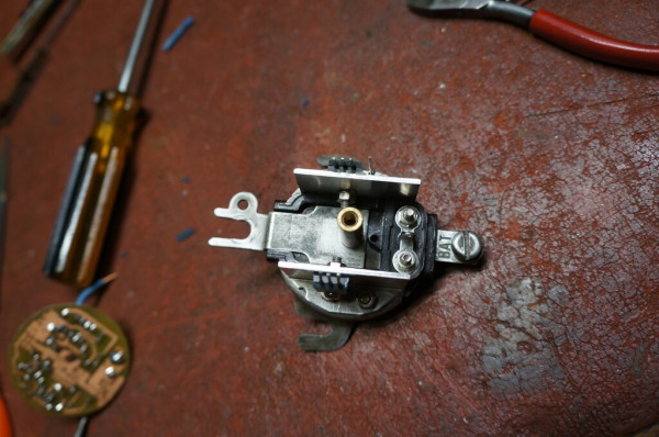

My cutout housing version with PCB is now complete. I designed a PCB with DOS Protel on my 386, and used the toner transfer method of applying the board resist. The circuit is exactly the same as my prototype, which has proved itself over the past four months.
Details of the process are here https://www.cool386.com/pcb/pcb.html
Because of the unusual construction of my particular (repro) cutout housing, I had to fabricate special brackets to mount the two power semiconductors. This in turn required a board design specific to this unit. However, I'm pleased with how it all turned out.
I decided to retain the Vref LED in view of its advantages, and to make this and the Charged LED visible without drilling into the cover, I simply rely on the LED's shining through the gap above the generator terminal strip. I'm happy with the results. However, it's obvious the mild steel body of the cutout housing is inferior for heatsinking, as compared to the diecast aluminium boxes I've used for the prototypes. The whole heatsinking arrangement I've used would not be suitable for charge currents of more than 5A unless a diode with much lower voltage drop was used. Full details on the design are as before, here https://www.cool386.com/ford_regulator/ ... lator.html

Fantastic job John documentung the PC board fabrication process, building the pcb version of your design and installation in a cutout housing. Thank you for sharing your knowledge and experience.

John,
Great to see Protel again after all these years, and inspiring to see that basic simple methods still work well for making PCB's.
Well done
Well done
AdminJeff
looks good John! It brings back fond (?) memories from years gone by... "give me a DOS prompt or give me death" was a favorite saying of mine. I cut my teeth on DOS 2.11.
I've settled on Tonys modified LM393 design as the most stable of the designs for me and my use case. I like the ammeter simply telling me if it's charging or not at a simple glance. I also finished the cutout housing and drilled a hole for the indicator led in the top of the housing.
I have driven about 250 miles with this unit and it's been rock solid. The spare cutout is in my tool box just in case Murphy's law decides to kick in. But I expect my new 6v battery to last a good long while now that I have an actual working voltage regulator in place.
AdminJeff
