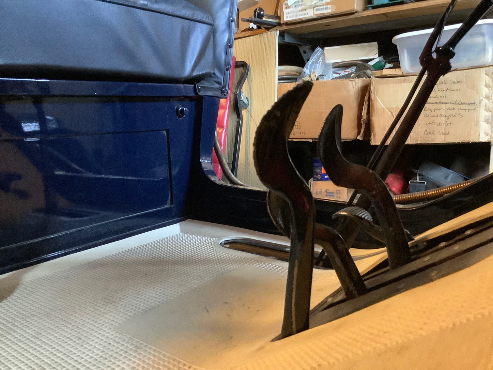

I was going to measure one but not sure when I'd get back from barn.
this might be good enough for you:

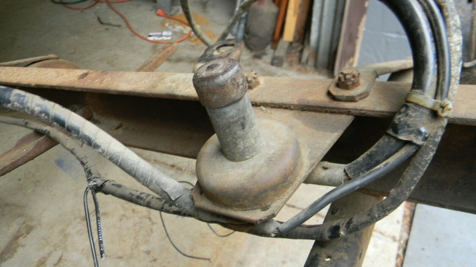

If it were me, I would use a solenoid with hidden button and not cut a hole in the heel board.

With a 14, why use a foot switch? You can easily use a small momentary push button to activate a solenoid. It’s an easy, clean way to operate the starter. I painted my switch to match the body. Nobody has ever asked what it is for, most people never notice it. Because I drilled it through wood I could, if I wanted to, remove it, glue a dowel in the hole, and repaint the area and nobody would ever know.
I mounted the solenoid just behind where the brake lever crosses the frame rails. I just made a bracket for it that uses the same bolt holes as the hand brake assembly so I didn’t have to drill my frame.
