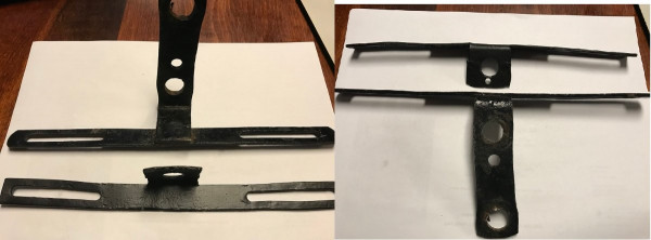

Posts: 6590
Re: License Plate Bracket on 27 Coupe
Post by TRDxB2 » Sun Jan 17, 2021 2:17 am
Not sure if the two hole one is correctly constructed

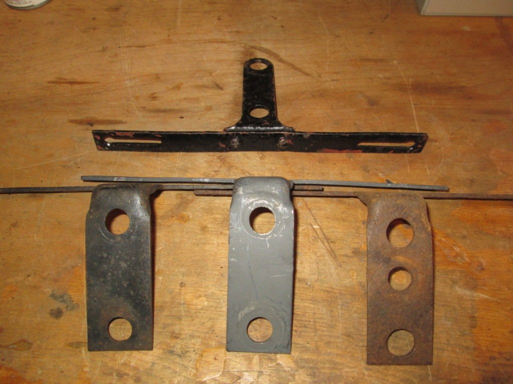

Posts: 5599
Post by RajoRacer » Sun Jan 17, 2021 7:12 pm
These are examples of original Ford front license plate holders sans the early 2 pc. ones. The 3 side by side are stamped '26 - '27 - why the one has an additional hole is puzzling. The single one at top is pre '26.
