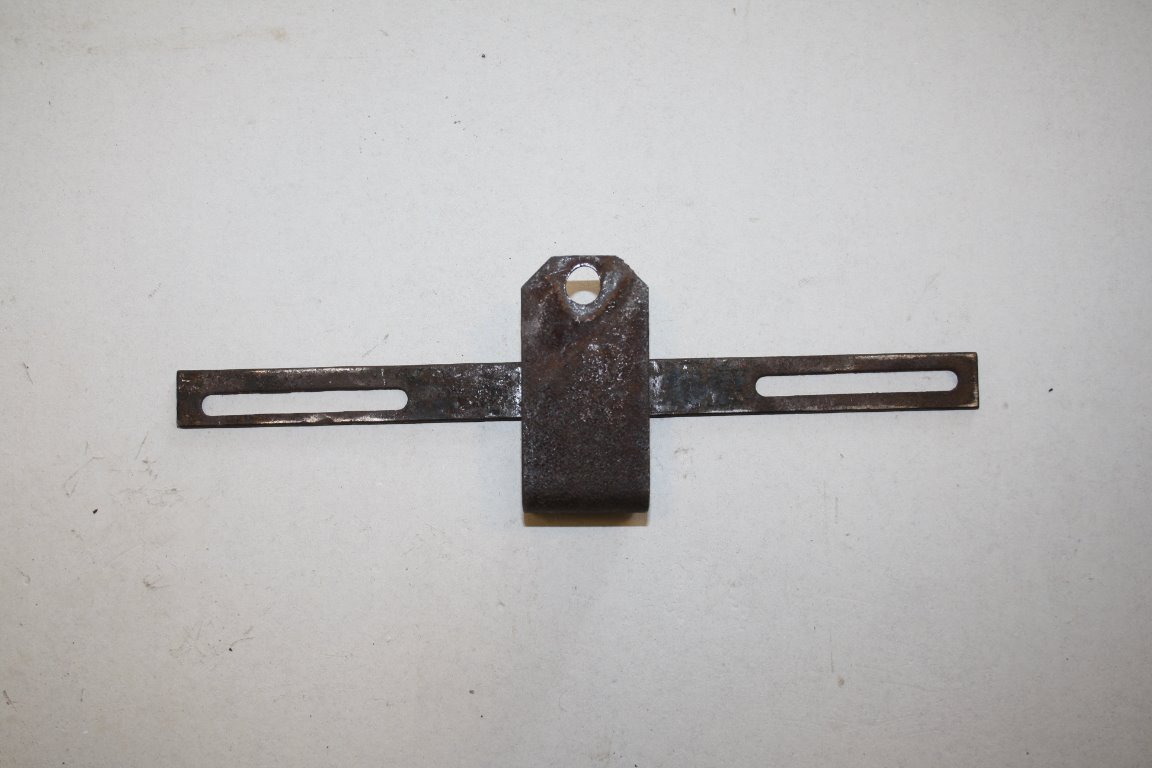

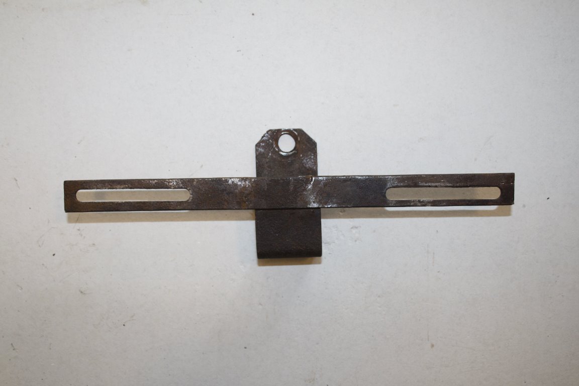

Ken Buhler
Posts: 540
First Name: Ken
Last Name: Buhler
Location: Kelowna B.C.
Board Member Since: 2012
Re: License Plate Bracket on 27 Coupe
Post by Ken Buhler » Mon Jan 18, 2021 2:03 am
This is my Canadian bracket, if any one would like more detail, I'm here.
