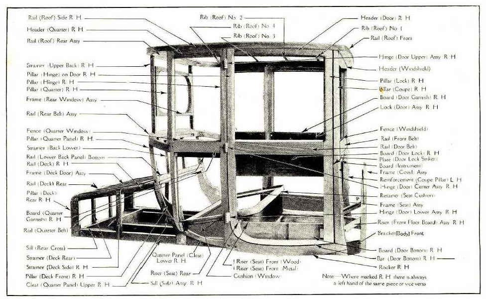

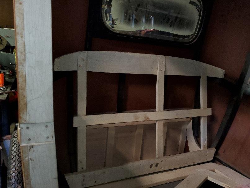

			I am putting my grandfather's 1923 coupe back together after it has been apart for about 50 years.  I have just about all the parts, but I am not sure if I am missing any of the wood pieces for the interior/seat frame.  Does anyone have pictures of how the wood goes, so I can see what I am missing and how it goes together.  Drawings of the pieces would be nice as well incase I need to remake anything.

If a 22-23 this should help.

Awesome thank you.  Do you had to have anything on how the seat frame goes in?

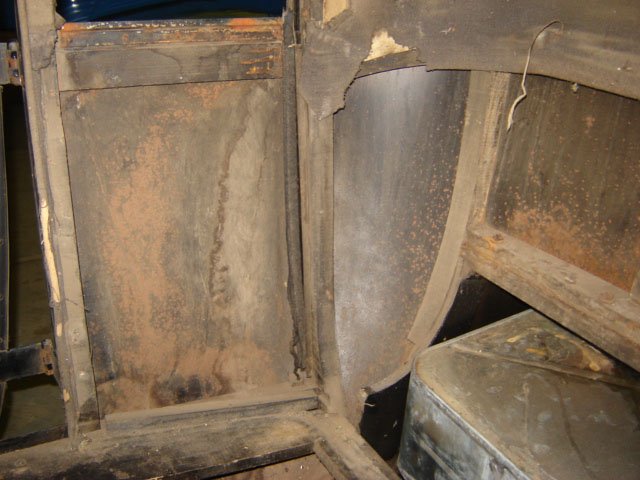

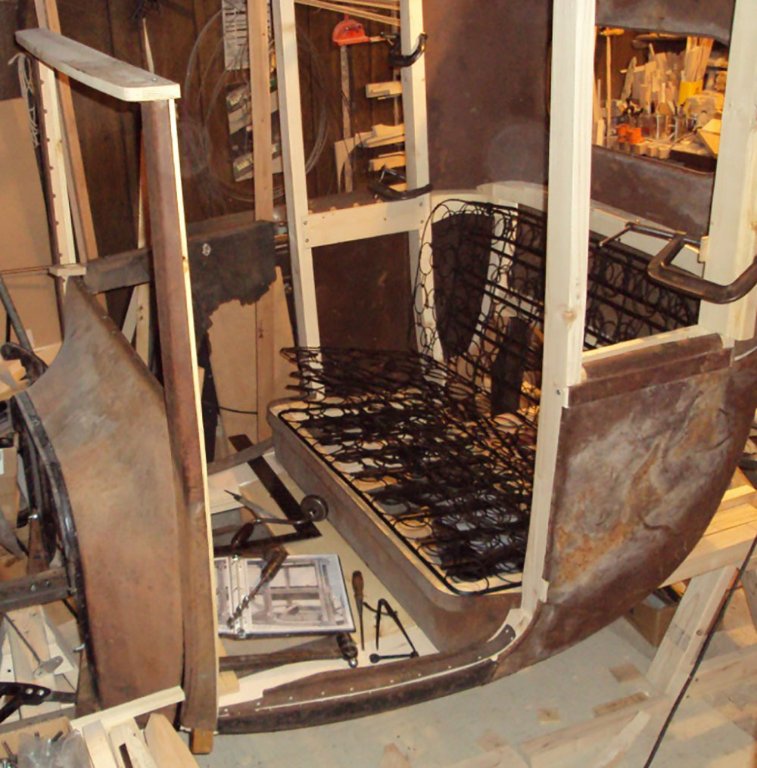

These might help. One shows the new springs sitting in the frame.

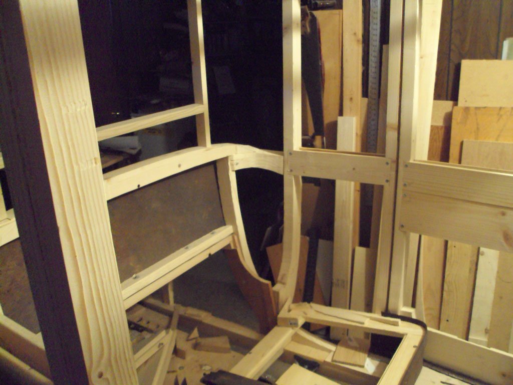

I just found this link and think it has some better photos.
http://www.mtfca.com/discus/messages/41 ... 1390321264
Though it's a '19 much could be similar.

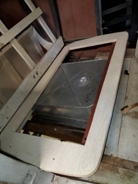

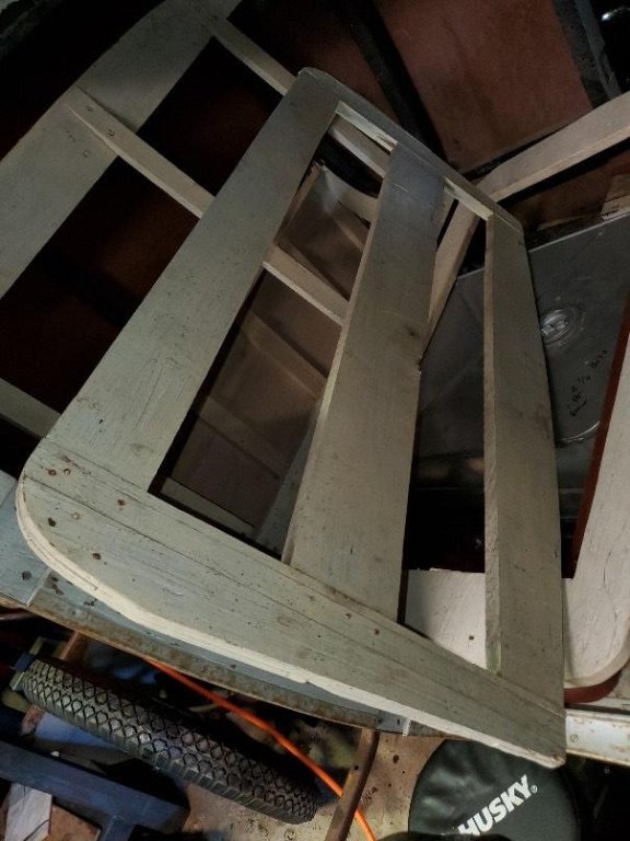

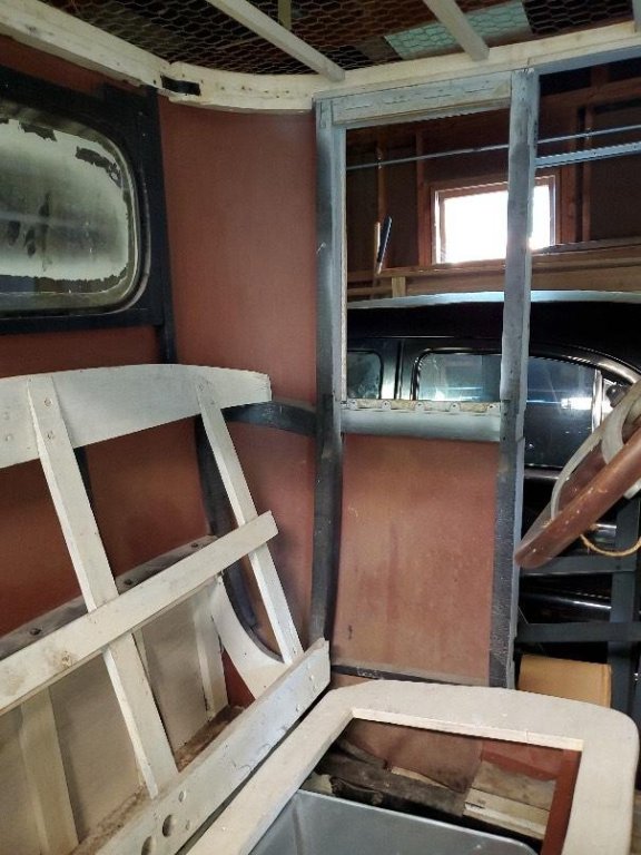

Thank you for all the help.  It looks like I might have a few extra piece.  Mine look closer to the last link of a 19.  I attached pictures of what I have.

Comment: 1923 Coupe with fuel tank under the seat?

Re: 1923 coupe interior
Yes.  This one was has the truck bed kit on it.  So when the back end was cut off there is no where for the tank to go.
