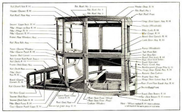

If a 22-23 this should help.

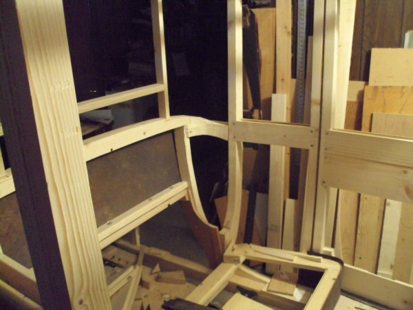

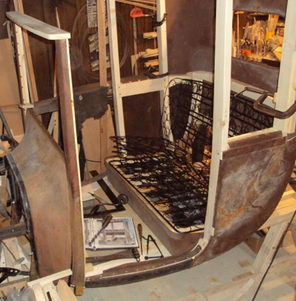

These might help. One shows the new springs sitting in the frame.
http://www.mtfca.com/discus/messages/50 ... 1431709442

I just found this link and think it has some better photos.
http://www.mtfca.com/discus/messages/41 ... 1390321264
Though it's a '19 much could be similar.

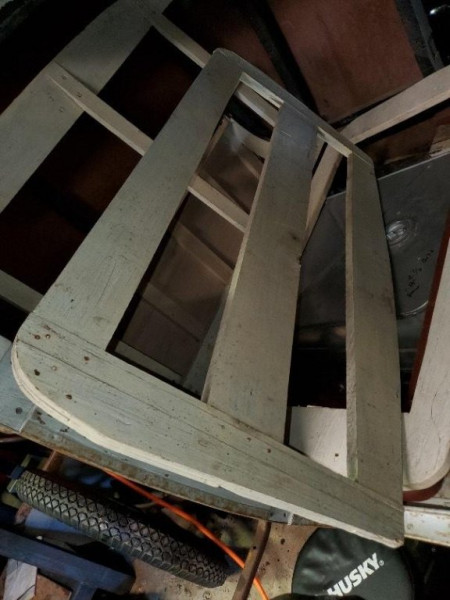

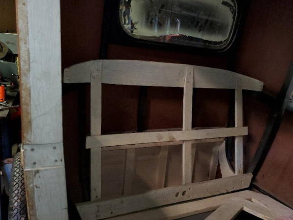

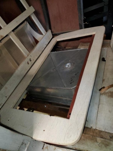

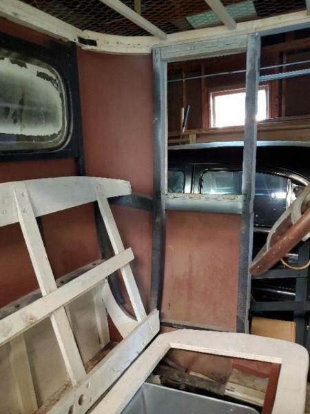

Thank you for all the help. It looks like I might have a few extra piece. Mine look closer to the last link of a 19. I attached pictures of what I have.

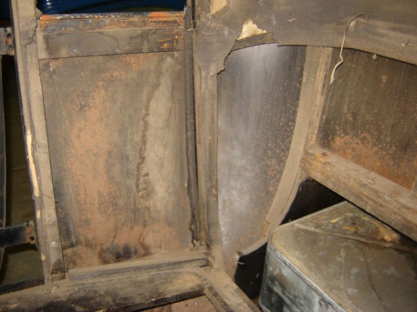

Comment: 1923 Coupe with fuel tank under the seat?

Yes. This one was has the truck bed kit on it. So when the back end was cut off there is no where for the tank to go.
