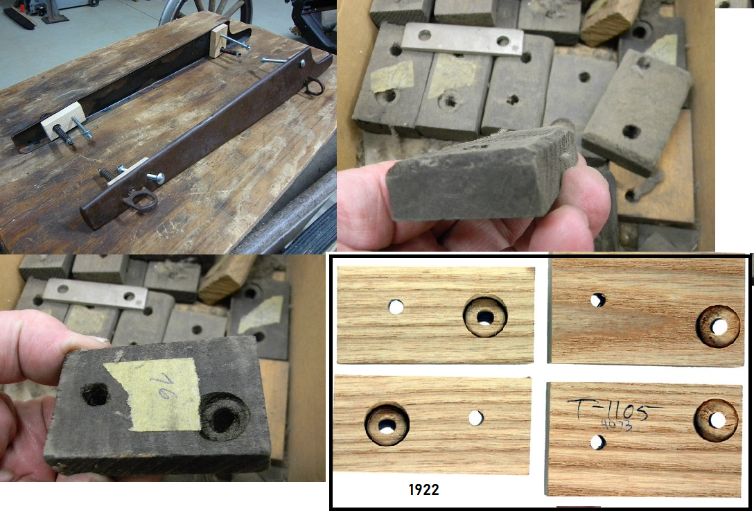

Looking for a drawing or measurements of the hood shelf blocks for a 1922
Thanks.

Unless you're looking to have some fun it would be easer to buy from the vendors. There are a lot of angles both in the wood and the holes for the hood pins.

The 22 model ones for low radiator cars are a simple rectangle, rather than the more complicated ones for high radiator cars. You still have to set the angles for the hood latches and the corresponding angled recess for the hood latch springs. If you make one set, without getting the angled holes wrong, you have done well. I cut six blocks for my current project, just because the piece of timber allowed me to, and used all six!

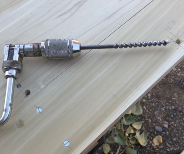

Possible alternative to a Forstener bit. Power tools have advantages, but you make mistakes more slowly with hand tools. I couldn't do without a brace and bit.
Get a horse !

I already own a forstener bit, that cost is negated. Comparing my one original to a reproduction, the reproduction holes are drilled wrong
