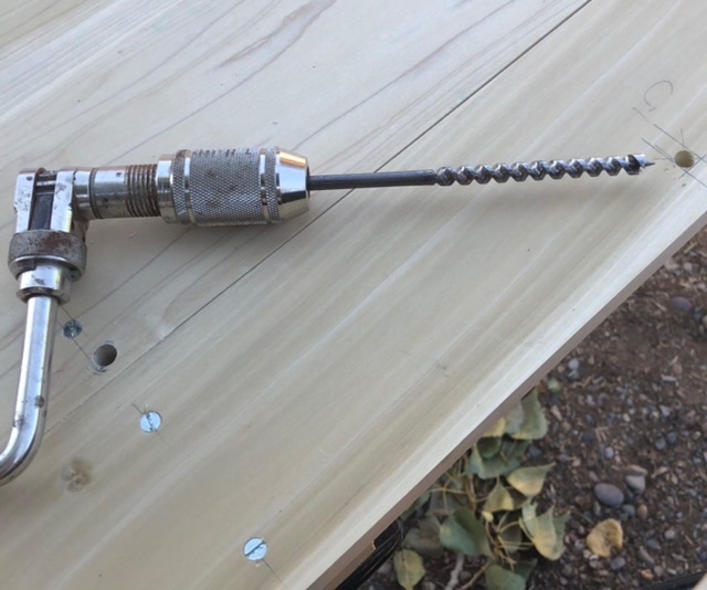

Possible alternative to a Forstener bit. Power tools have advantages, but you make mistakes more slowly with hand tools. I couldn't do without a brace and bit.
