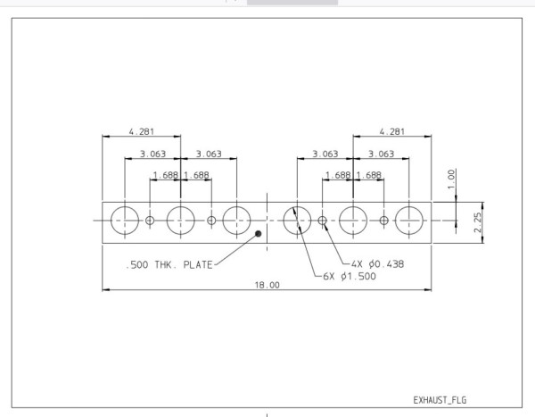

Is anyone making a header plate or have accurate drawings they would be willing to share? Not a plate to adapt the Model A manifolds to the block but one where I can build a set of headers. There was a PDF posted a while back for one, but there was a conflict in some of the dimensions? If not, I'll have to stop being lazy and make my own, but there are only so many hours in the day. Thanks

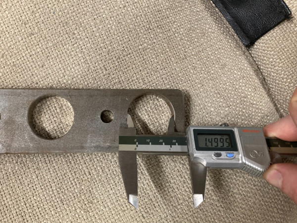

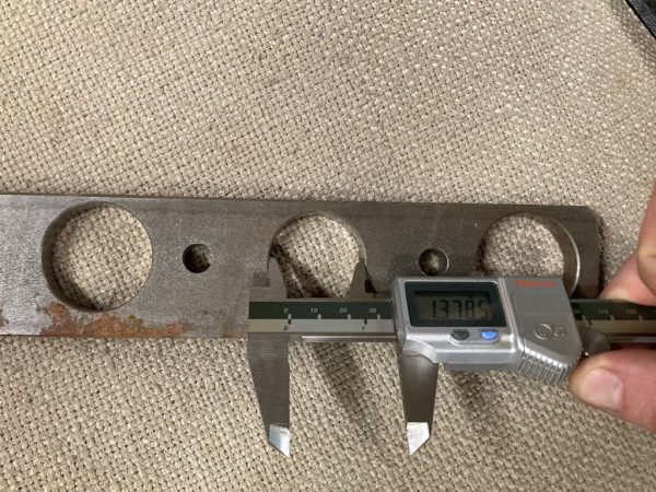

I’ve got a 1/2” thick plate laying around for a T flathead. If I remember right, it was bored 1.625” for exhaust tube and 1.500” intake. I will dig it up and post pics later...

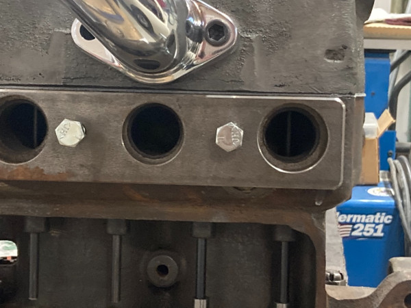

I made a few a while back, and set the tube centers at 7/8” from the top to prevent the plate from sitting on the edge of the head gasket.

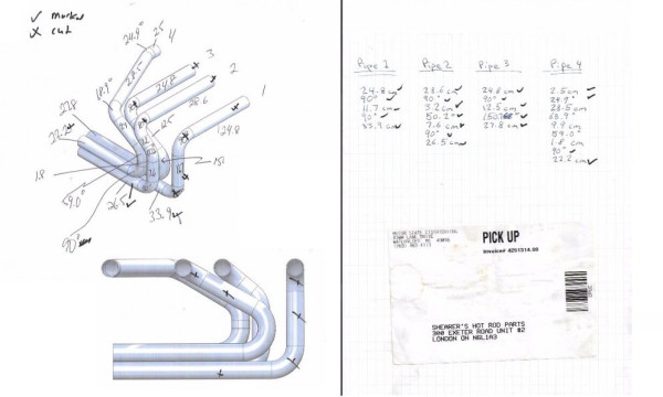

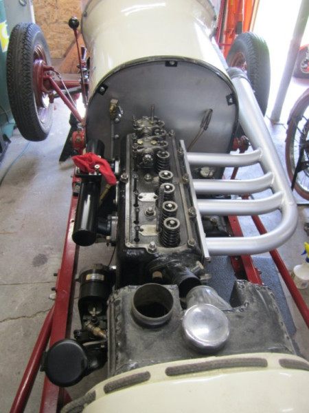

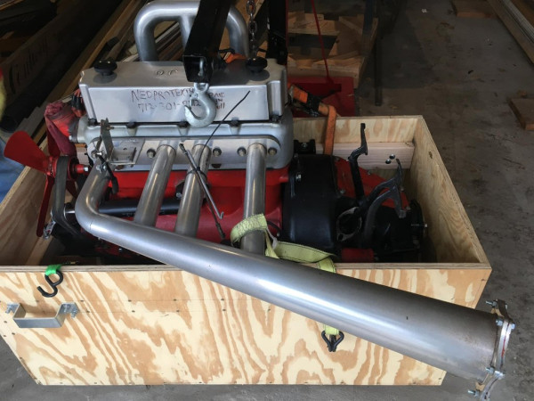

I'm actually going with a style that is going to require very few bends.
This is the one I did for the Rajo, much more work!
