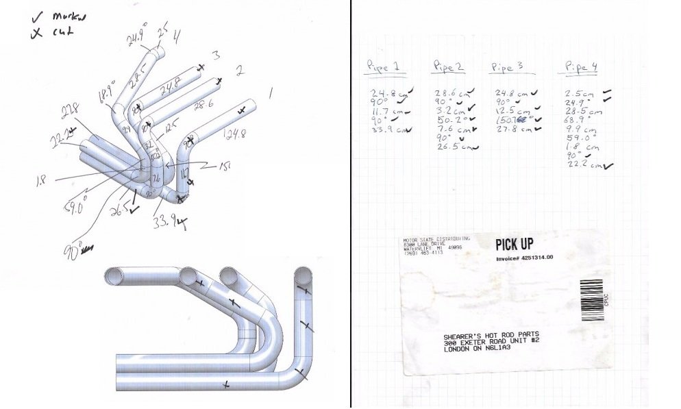

I'm actually going with a style that is going to require very few bends.
This is the one I did for the Rajo, much more work!
