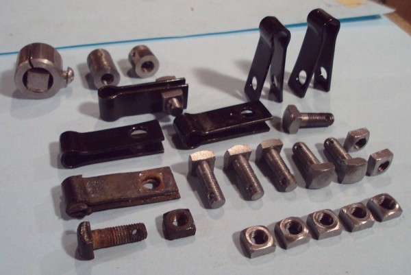

P/N 3088 is engine pan bolt 09-12 uses 7 of them. 1/4" x 9/16" I believe they were 28 tpi and have square heads bolts drilled for cotter pins.
Yet used square nuts. (!)
P/N 3088B is engine pan and hood board bolt and nut '09-'15 1/4" x 3-1/4" (short) (2 req)
P/N 3088C is engine pan and hood board bolt and nut '09-'15 1/4" x 3-5/8" (size) (? req)
I wish I could be more help. Maybe someone has some pics of original "engine dust shields," bolts, and nuts.

Keith, what are the clamps in your picture for? Tim
Posts: 1497
First Name: Keith
Last Name: Townsend
Location: Gresham, Orygun
Re: Engine pan hardware?
Post by KWTownsend » Sun Aug 04, 2019 1:15 am
The clamps are for acetylene headlamp gas lines.

I'm resurrecting this post because I have a question as to the length of the earlier style engine pan hardware with the square heads. I'm making my own bolts and ned to know the actual length from under the head to the end of the bolt. I saw two dimensions posted 9/16 and 25/32. Can anyone with the hardware give a dimension from under the head to the end of the bolt?
Mike
Posts: 7393
Post by Steve Jelf » Fri Mar 25, 2022 9:56 pm
This list claims they're the same, 1909-1927.
Bolts_nuts_threaded_items.pdf
(129.63 KiB) Downloaded 122 times
Scott Rosenthal
Posts: 397
Joined: Sun Jan 13, 2019 11:29 am
Last Name: Rosenthal
* REQUIRED* Type and Year of Model Ts owned: 12 Towncar, 12 Touring, 09 Touring
Location: Cincinnati OH
Post by Scott Rosenthal » Sat Mar 26, 2022 9:23 am
Hello Mike:
I too made my own square head bolts, and built to the lengths shown here. I put the cotter pin holes as close to the ends of the screws as I could get.. Parts are a tight fit, but they do fit. I can imagine that repro gas line clamps of incorrect heavier gauge, could be a watch out here.
