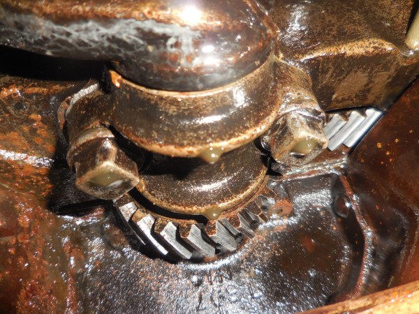

My 1927 T roadster pickup has a 1920 engine/transmission and at low to moderate RPMs it is smooth, but at high RPMs it starts to have lots of vibration under no load or running down the road. What would be the first suspect? I thought maybe the rear main bearing may be worn so I pulled the oil pan. I see no way with out my little 2 year old grandsons hands and arms to get to the rear main. Also, nun of the rod caps had dippers on them. Should they? The connecting rods all looked like they had plenty of oil all the way up into the piston skirts.

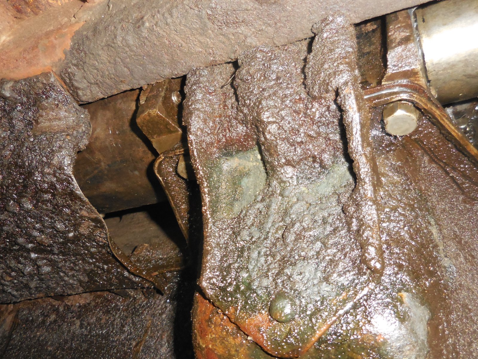

Do your engine pan arms have wood blocks? You can get a lot of vibration if they are missing.

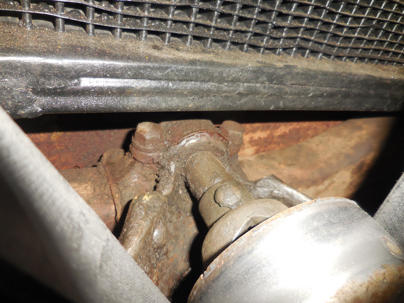

No wood blocks for engine mounts. Some really great suggestions. Look like it is now down to flywheel or transmission.
Phillip
Phillip
- Posts: 4388
Re: Vibration at higher RPMs
Try putting in the wood blocks and side bolts. It has ceased vibration in several cases that I'm aware of. At the very least, it's an easy thing to try. Do you know what wood blocks I'm referring to?
Phillip
Topic author - Posts: 50
- Joined: Mon Feb 11, 2019 2:33 pm
- First Name: Phillip
- Last Name: Lee
- * REQUIRED* Type and Year of Model Ts owned: 1927 Model T Roadster Pickup
- Location: College Grove, TN
I do not know about the blocks you are referring to.
The motor mounts I saw are one in the front under the hand crank and one on each side. Driver side by the starter. Should there be wood blocks somewhere on this.
- Posts: 2060
- First Name: Jeff
- Last Name: Humble
- Location: Charlevoix, Mi
- Board Member Since: 2006

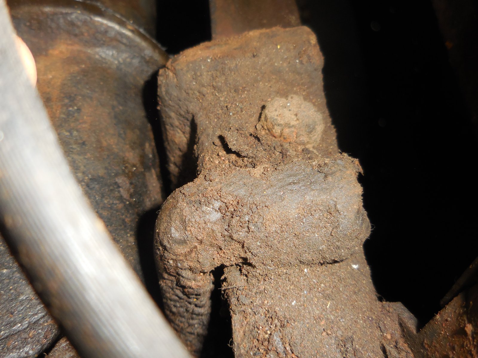

Yes, wood blocks should be in the frame cavity at the rear pan mounting brackets. Cannot tell from your picture taken at that angle, yours might be there. There should also be a bolt going through the side of the pan ear through the wood blocks horizontally, again, cannot see from those pictures if you have it or not.
From the pictures you posted I would rule out the left ear and front motor mount as being a cause of excessive vibration.
