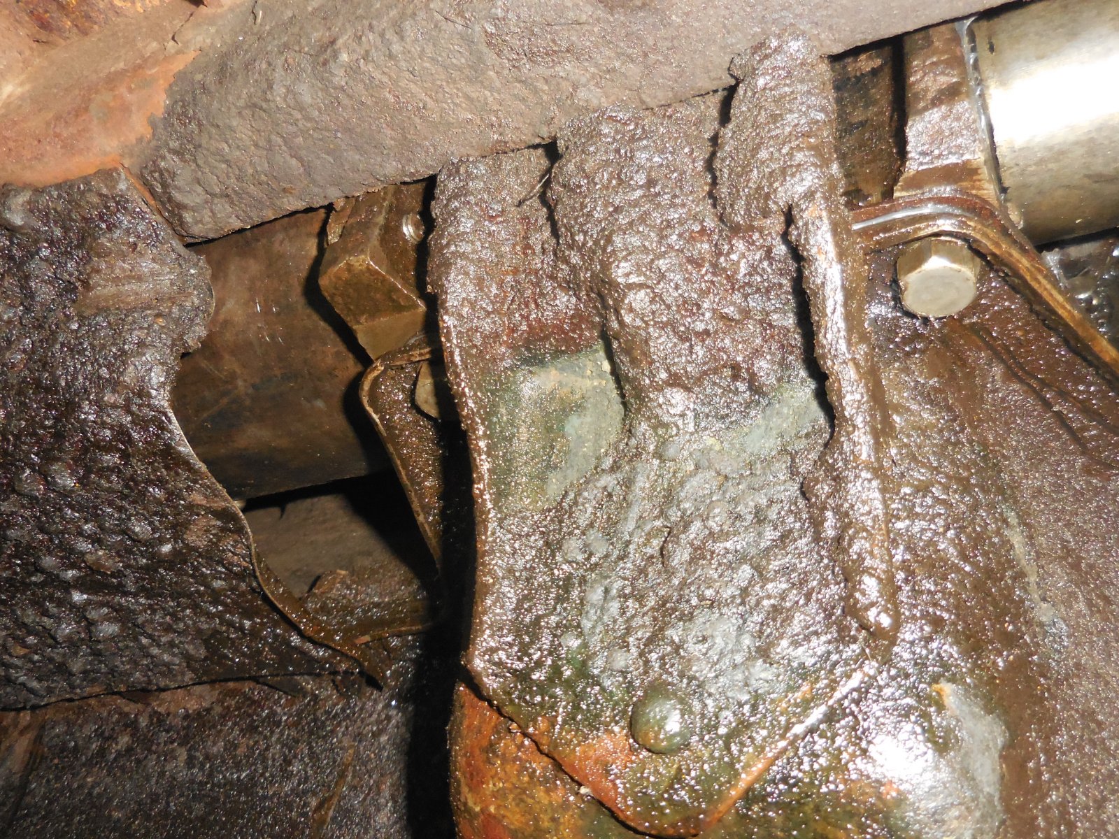

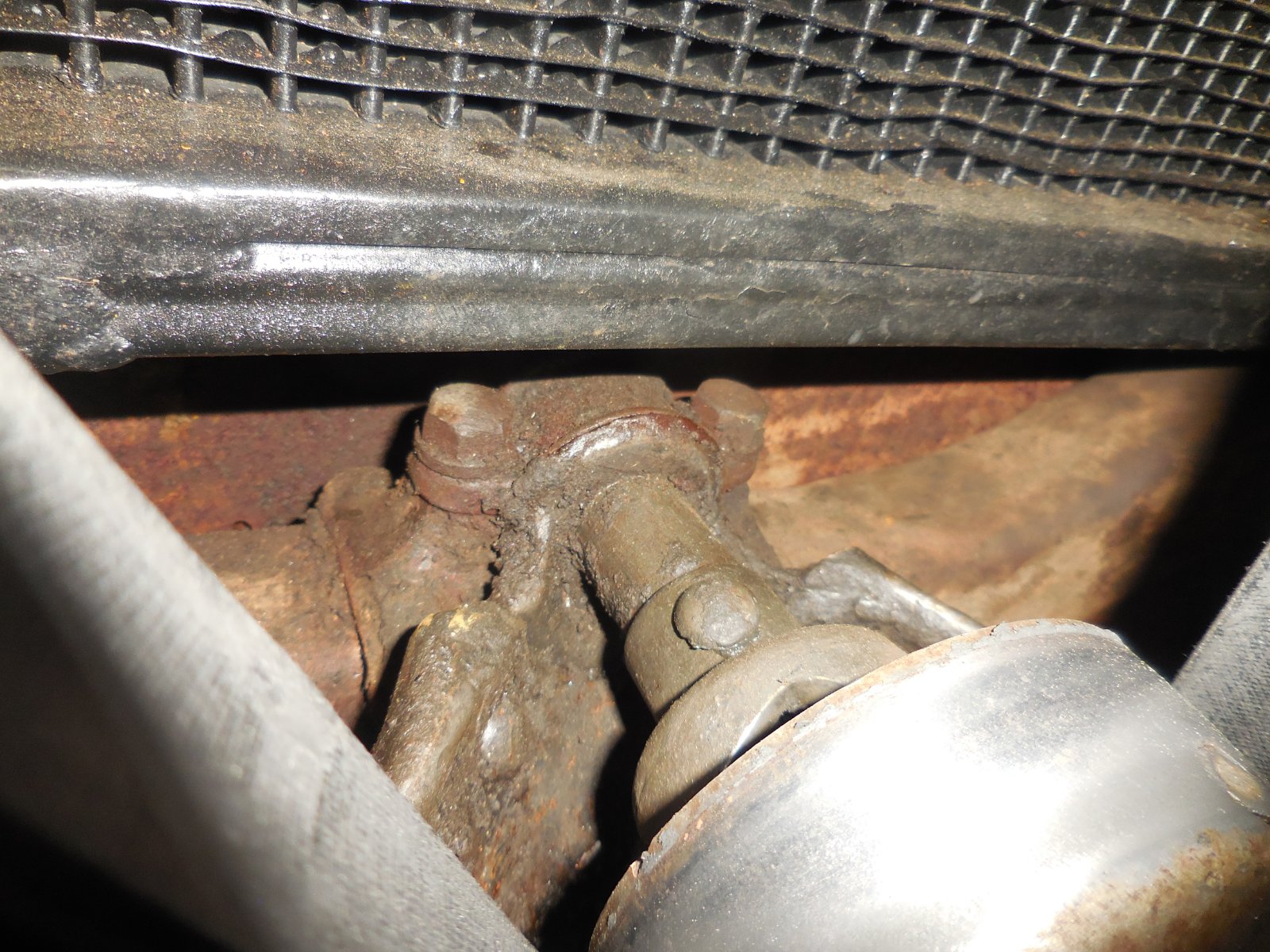

- Posts: 2037
- First Name: Jeff
- Last Name: Humble
- Location: Charlevoix, Mi
- Board Member Since: 2006
Re: Vibration at higher RPMs
Yes, wood blocks should be in the frame cavity at the rear pan mounting brackets. Cannot tell from your picture taken at that angle, yours might be there. There should also be a bolt going through the side of the pan ear through the wood blocks horizontally, again, cannot see from those pictures if you have it or not.
From the pictures you posted I would rule out the left ear and front motor mount as being a cause of excessive vibration.
