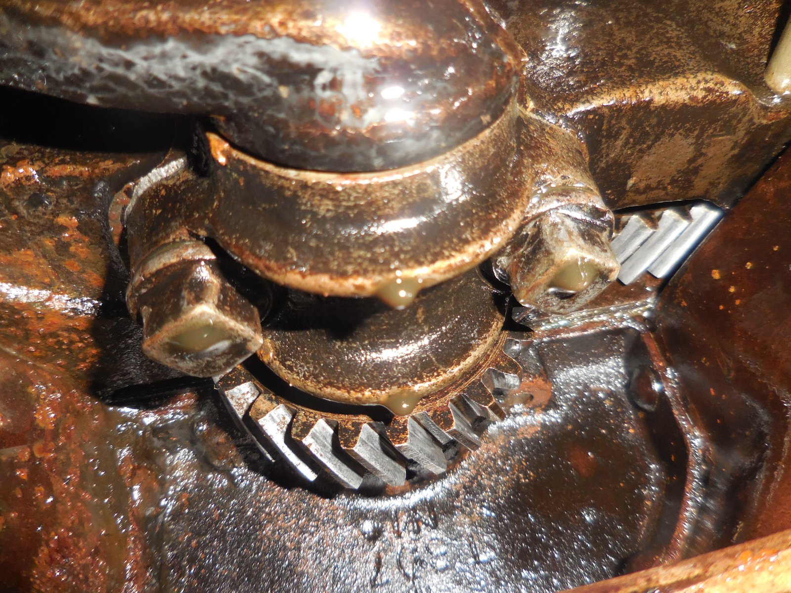

My 1927 T roadster pickup has a 1920 engine/transmission and at low to moderate RPMs it is smooth, but at high RPMs it starts to have lots of vibration under no load or running down the road. What would be the first suspect? I thought maybe the rear main bearing may be worn so I pulled the oil pan. I see no way with out my little 2 year old grandsons hands and arms to get to the rear main. Also, nun of the rod caps had dippers on them. Should they? The connecting rods all looked like they had plenty of oil all the way up into the piston skirts.

- Posts: 1991
- First Name: Jeff
- Last Name: Humble
- Location: Charlevoix, Mi
- Board Member Since: 2006
Re: Vibration at higher RPMs
Yes, wood blocks should be in the frame cavity at the rear pan mounting brackets. Cannot tell from your picture taken at that angle, yours might be there. There should also be a bolt going through the side of the pan ear through the wood blocks horizontally, again, cannot see from those pictures if you have it or not.
From the pictures you posted I would rule out the left ear and front motor mount as being a cause of excessive vibration.
