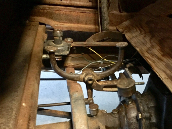

I added a Ruckstell, but haven’t added a shifter.

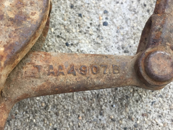

I heard of people who used Model AA shifter to shift a Ruckstell. The only thing I could find in the forum is this thread from 2010:
http://www.mtfca.com/discus/messages/11 ... 1270097310

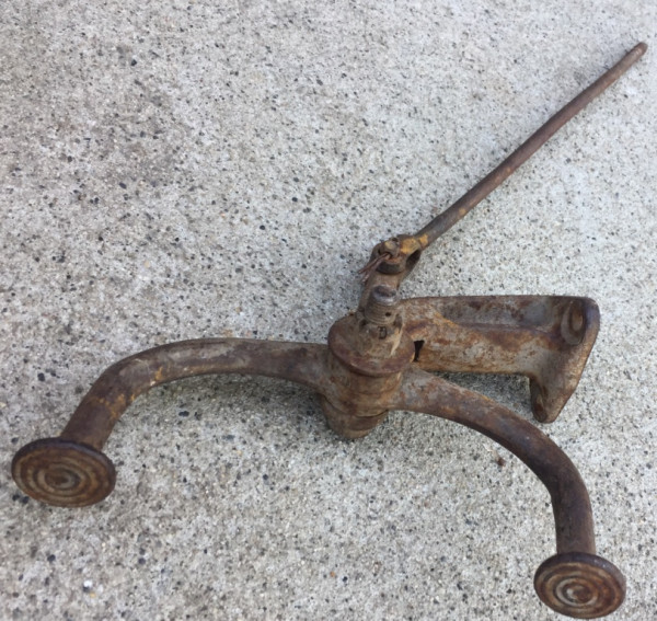

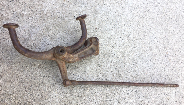

Today I got this from a friend:
I like the idea of a foot shifter rather than having one more lever in my way.
Anyone use one of these?
Matt

Hi/lo pedal foe early 28 AA ford truck

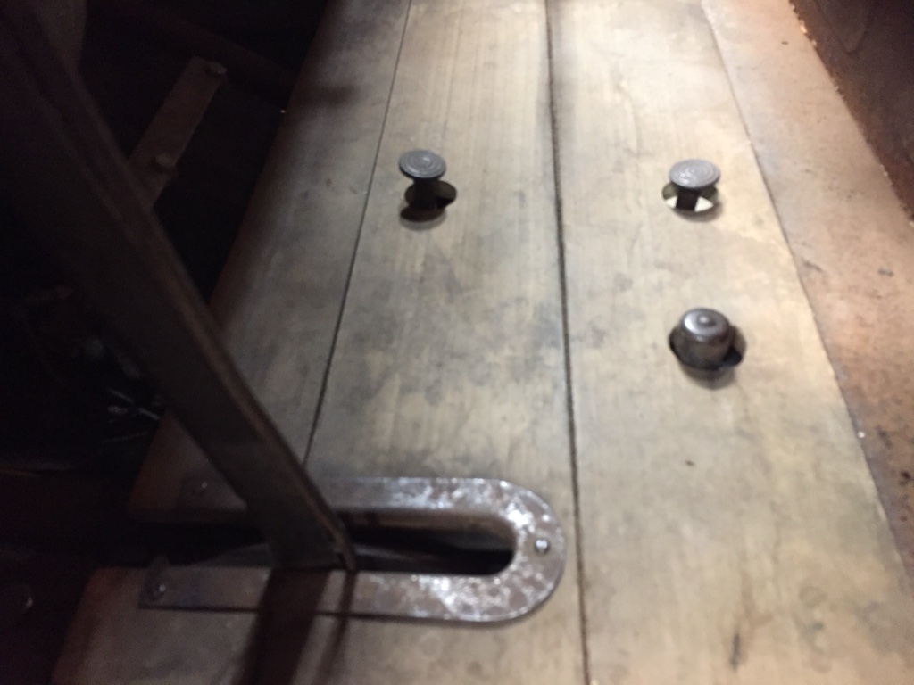

I like the idea that I can use my hands for the throttle in my right foot on the shift. So I’m moving forward.
I understand the concern if there is enough movement. I measured less than an inch of movement on the Ruckstell shifter. The foot pedal seems to have twice that.
Here is the first progress photo:

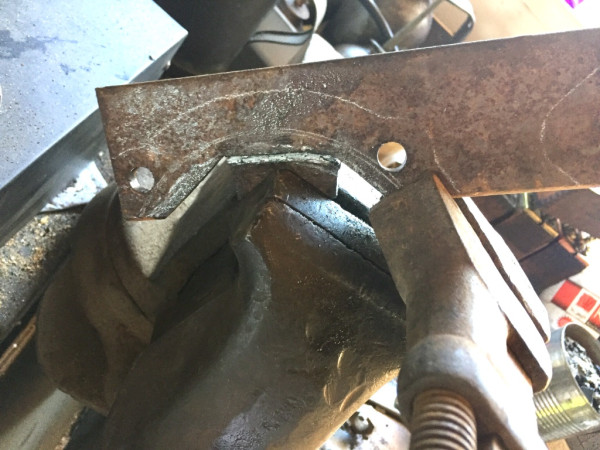

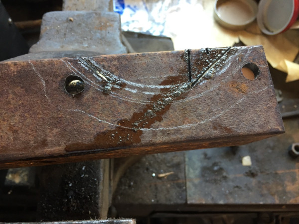

You make some good points. No mater what a model T with Ruckstell can keep the arms and legs busy. I am locating this on the left side of the forth main. Your point about a straight rod is true. Unfortunately had to make some bends for battery box. Perhaps if I did it again I would have mounted to the other side of the fourth main.

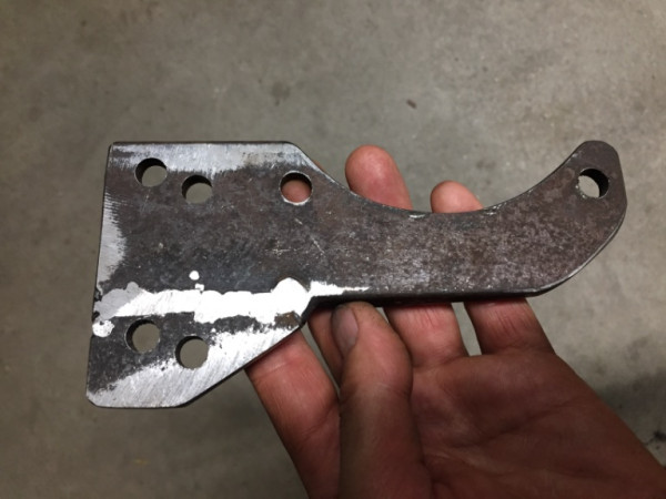

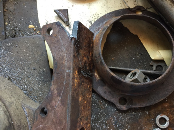

Here are some progress photos:
Cutting with hand saw:
Breaking using chisel and bend:

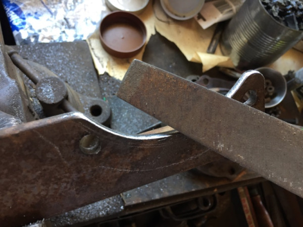

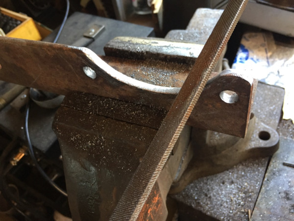

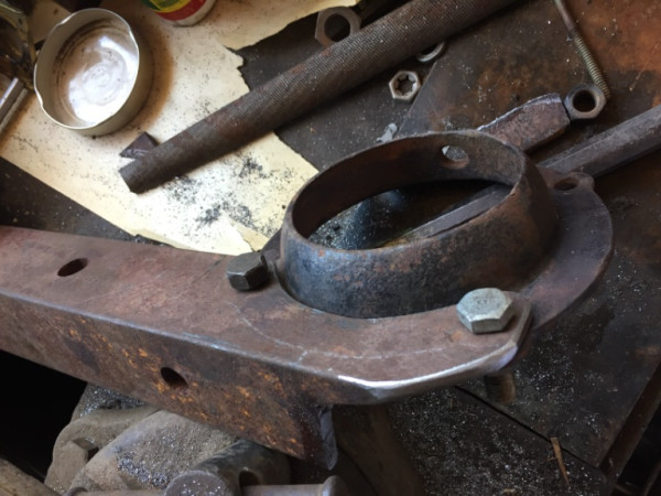

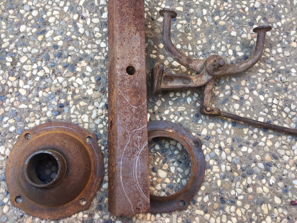

Post by Matt in California » Sat Jun 11, 2022 3:42 am
Course filing:
Fine filing:
More cutting:
Test fit:

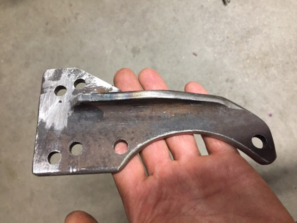

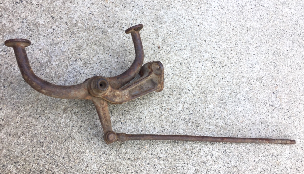

Post by Matt in California » Sat Jun 11, 2022 5:34 pm
Finished Bracket.
All hack saw and file plus a weld.

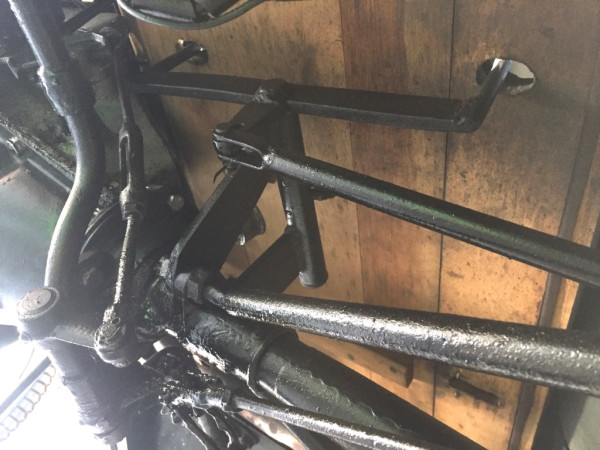

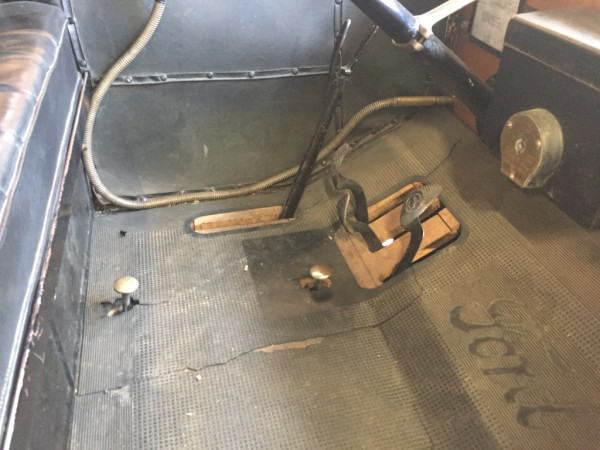

Post by Matt in California » Sat Jun 11, 2022 5:36 pm
Installed

Seeing it installed, thinking maybe, wondering if the pedals will be high enough where they stick out of the floor? By time you take up any play in the clevis ends, bowing in the rod between, both pulling and pushing, you might run out of needed travel by time you reach the floorboards. If you are going to have floormats, that will reduce the usable travel even more.
Don't take this as a criticism, I think it is a fantastic idea that may require a little more tweaking to make it fully workable.
The linkage rod needs a length adjustment. Pictures show the pedal faces almost the same height.
The rux should be in direct or rux, where by, one pedal face should be up all the way & the other down all the way. As shown, its in a near neutral position.
Neat idea & execution. Use will tell if the pedals are in the way of one's feet in operation, ingress, etc. Do let us know.
Thanks for everyone's comments!
Mark, yes you and others are very observant. After I took the photo I made final adjustments and when engaged the pedals come just above the running board in either the high or low positions. If you see the earlier photos of the finished bracket you will see two sets of smaller holes. I am currently using the lower ones and it seems to be working fine and not hitting anything. But if I added the a floor mat I would likely need to lift it. At this point, I don't even own a floor mat.

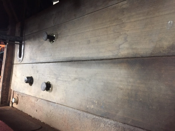

Here is the setup that Don’s dad built.
As you can see the pedals are higher and wider spaced.
You can see I connected it differently. The designer seemed to take in account the concerns that were brought up here with a bit more leverage. In the 1914 the fender bracket is not in the way like it is on my 1920
As far as a proof of concept Don really likes the set up.
