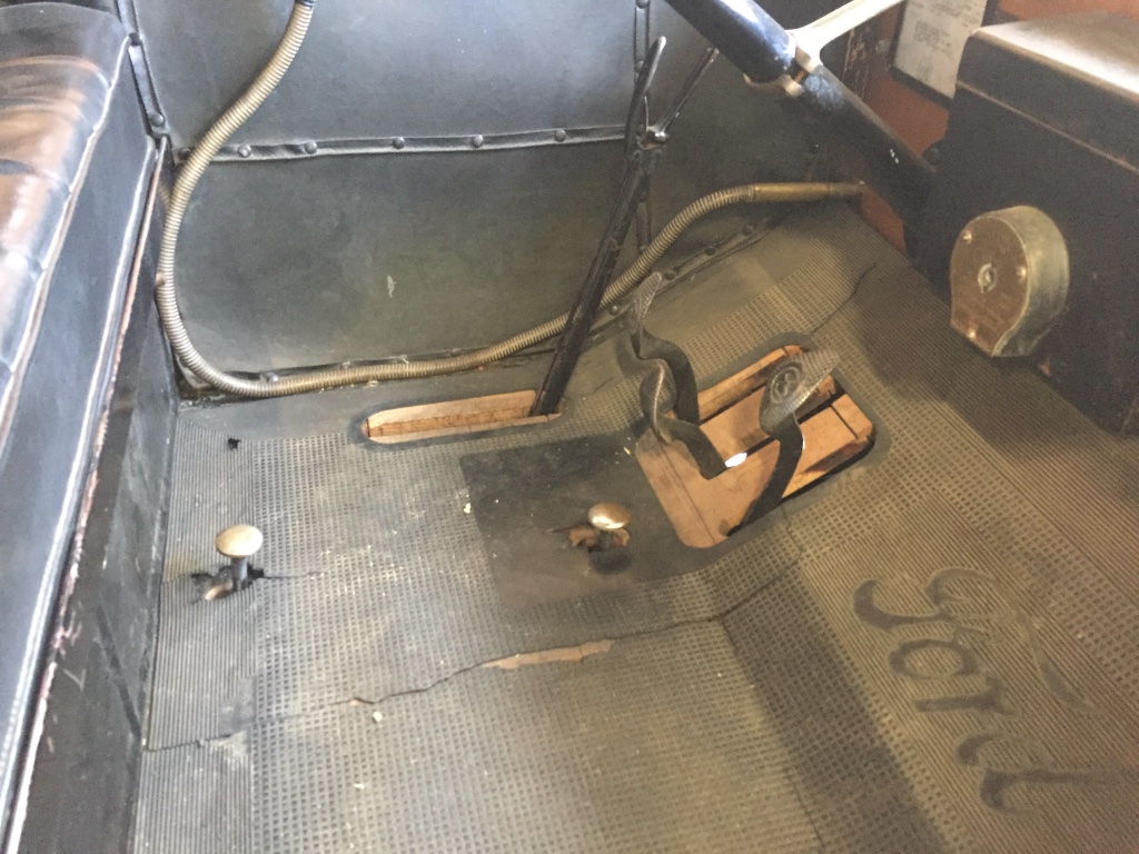

Robert, thanks for your helpful advice on shifting. I am starting to learn how to shift. Regarding driving in Ruckstell under drive for normal driving: I am doing it now to learn to shift, but would rather not wear it out. I can see why people enjoy running it to add the missing gear. I enjoy running a T as it was designed to be and plan to use the under drive only when needed.
I do want to make clear, as insinuated in the first post, this idea was not original to me. Actually, fellow member, Don Azevedo, showed me his 1914 Touring using the same concept. Don loves it and the car has had the set up many years because his dad installed it. I figured when I posted on here I would find others who have done the same, but evidently this solution was not common.
Matt
Matt in California
Posts: 778
Joined: Sun Jan 06, 2019 5:42 pm
First Name: Matt
Last Name: G
* REQUIRED* Type and Year of Model Ts owned: 1926 Touring, 1926 Fordor Project, TT C-cab flatbed farm field find, TT dump truck project
Location: California
Re: Ruckstell Foot shifter
Post by Matt in California » Thu Jun 16, 2022 1:14 am
Here is the setup that Don’s dad built.
As you can see the pedals are higher and wider spaced.
You can see I connected it differently. The designer seemed to take in account the concerns that were brought up here with a bit more leverage. In the 1914 the fender bracket is not in the way like it is on my 1920
As far as a proof of concept Don really likes the set up.
