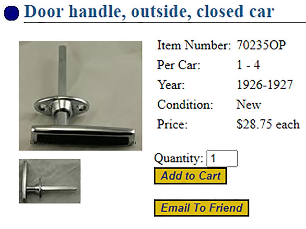

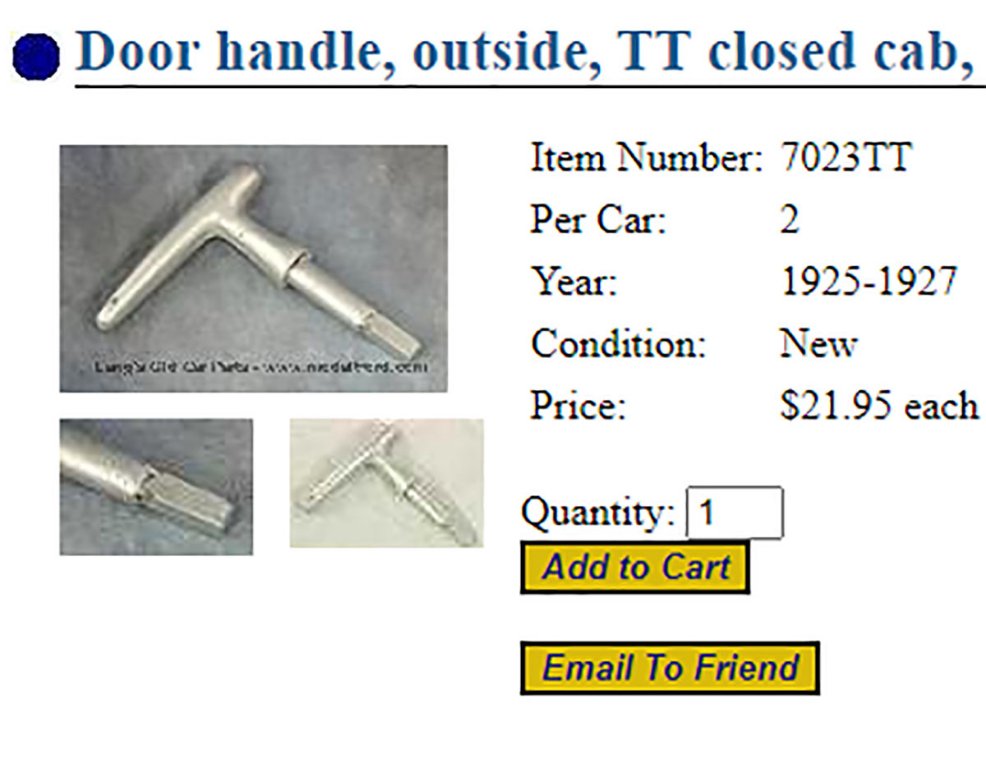

Here are some 23-17? Closed car. Maybe earlier.
and:

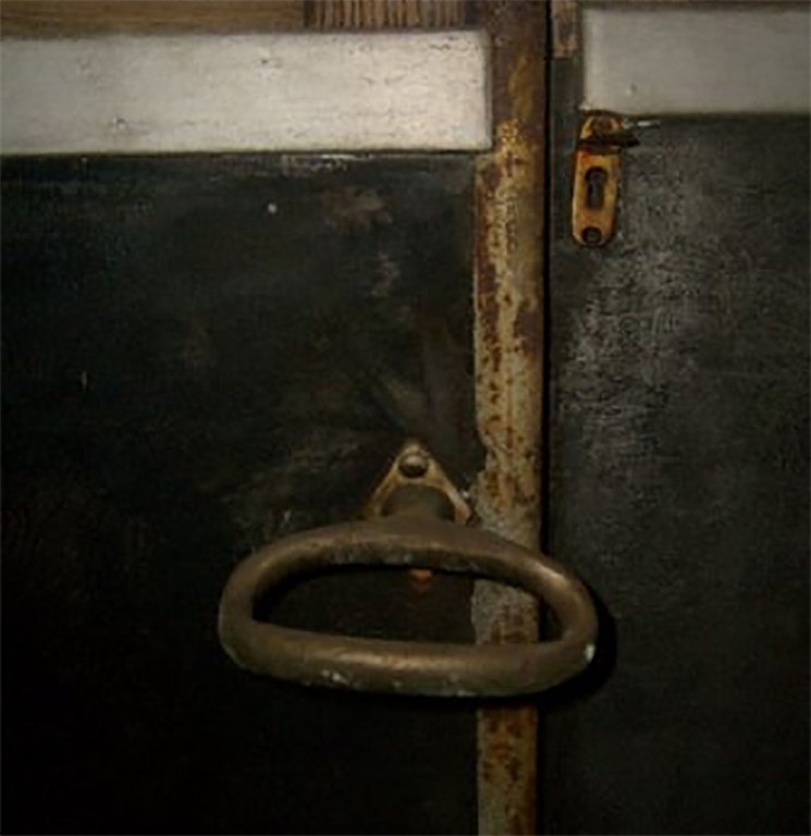

Re: Trivia: Exterior Door Handles?
Then there was the stirrup handle used on the early Coupes and Centerdoors.

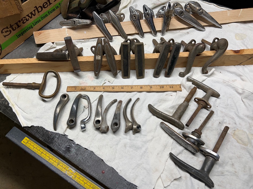

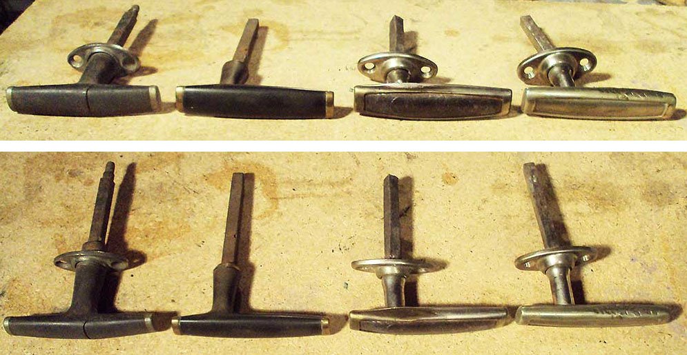

Im also curious about styles used for different years.
I recently added a number of handles to my collection thanks to ModelT Matt. Some are similar to what Rich Eagle posted above. I presume the top row are newer, maybe Model A?

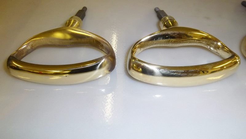

I would also like to know if anyone has seen the curly handles in the second row, far right.
- Posts: 5597
Yes to top row - one with key in the center is for the rumble seat or trunk lid. I believe the fancy ones are Model A Fordor Sedan.

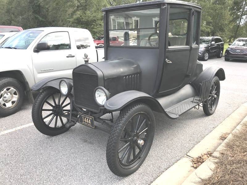

I was able to find out on the Coupes.
1919-1920 - Had Bail or loop style handles.
1921 - Had "T" style handles.
1922-1923 Had "L" style Handles.
I have been unable to find any reason for the changes.
I feel Ford saw the changes as improvements.
