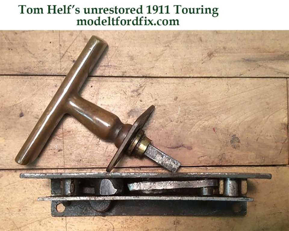

Can any one give an explanation about the styles of open and closed exterior Model T door handles from 1908 to 1927?

Generally the open cars have outside door handles until late '12. Then latch handles extended out the top of the door or later on the inside of the door.
Closed cars have door handles on the outside and inside since there are windows.
