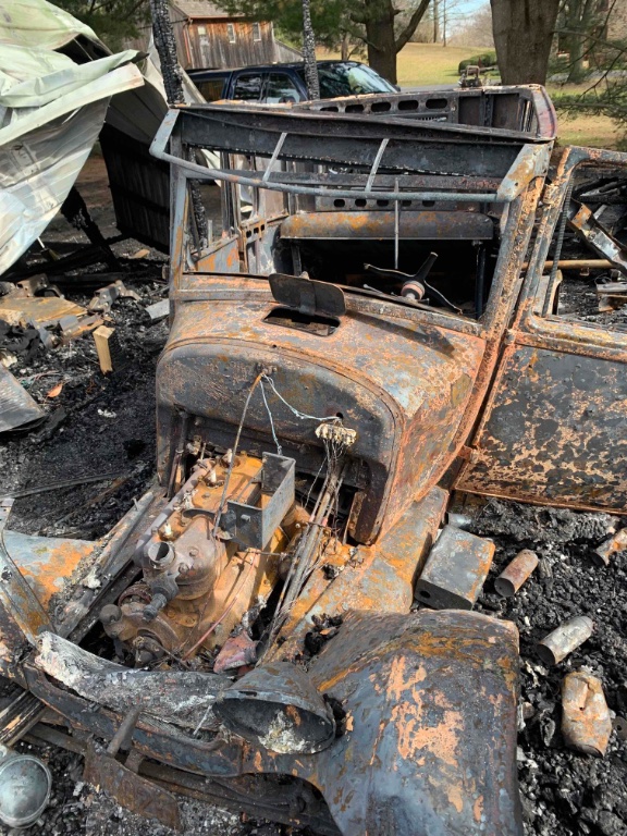

A club member had a devastating fire that destroyed his garage and 4 antique cars. Attached is a picture of his 26 coupe. It was burned the worst. It was a very nice car with Warford and Rocky Mountain brakes. The engine turns. He does not want to restore it himself but was wondering if the car or any parts should be saved or is it all scrap? Any thoughts / opinions are welcome.
Thanks, John

Sure, a fine, restored car has been devastated, but I'm willing to bet 90% of it is restorable. Careful disassembly and attention to stopping corrosion which the fire itself and/or water and chemicals used in fighting the blaze causes can bring the car back to life for someone willing to tackle the project, or at least provide a wealth of usable parts for others who are in need of them.
Logistically it can be daunting for space, energy and time, but simply scrapping the whole would be a sad loss for the hobby. The same goes for the other cars that were in the fire. Condolences. I hope they were insured for value !

I have had the opportunity to work on fire damaged vehicles in the past. The amount of corrosion that will accumulate very quickly is surprising. The heat warps the sheet metal sometimes beyond repair. The amount of damage seen in the picture is extensive. I would have concerns about every part of the car. I wouldn’t scrap it, as some parts will be viable, but get it into a covered building as soon as possible.
What a terrible shame to lose it.

Scott is correct. The heat of the fire scorches the carbon in the steel and and at that point it pretty much makes it 'un-workable' from my experiences too.South park zephyr wrote: ↑Mon Feb 13, 2023 2:47 pmI have had the opportunity to work on fire damaged vehicles in the past. The amount of corrosion that will accumulate very quickly is surprising. The heat warps the sheet metal sometimes beyond repair. The amount of damage seen in the picture is extensive. I would have concerns about every part of the car. I wouldn’t scrap it, as some parts will be viable, but get it into a covered building as soon as possible.
John, I would suggest you do a favor to the entire hobby and talk your friend into destroying the vehicle where even the smallest of parts cannot be (unknowingly) filtered into another hobbyist's hands for reuse.

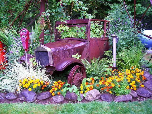

Restoring it to showroom condition would certainly be difficult. I doubt that it is beyond making runnable as a "Bran find" or barnfire car. It is hard to know if the fire was hot enough to damage the engine and differential significantly.
Often it depends on an interested individual.
Maybe a yard ornament?

There are good parts that are still good at least inside the engine. Depending on how hot and long lasting the fire was the body metal is still usable if it didn’t badly warp from the heat.
The frame and differential is definitely good.
The fender brackets are still good also. As far as I know those parts aren’t being reproduced yet.

There's not much to save there. The fan hub melted away. That's at least how hot it got. The only thing I'd save would be the sun visor frame. Those are really hard to find and that one looks salvageable. I wouldn't want any oyher piece of that car in any car of mine, sad to say.

The biggest problem with fire damaged cars is that in order to put out the fire as fast as possible the fire fighters put a lot of water on the fire. This amount of water cools the car’s metal down way to fast making it brittle and warping it. It is very hard to impossible to fix this damage in order to re-restore the car. If the fire was not to hot the chassis parts can be saved but if the fire was hot enough to warp the car’s front and rear spring then many chassis parts may also be damaged past being reusable.

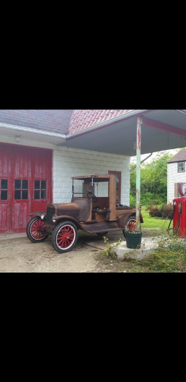

My T went through a barn fire in 1981, in disgust it was picked up and put in a shed. It was a sharp 25 coupe. When I got into Ts I bought it in 2012 and built this out of it. I've painted quite a few tractors and 2 model Ts, personally I enjoy not having to worry about the paint. Lower your standards and up your averages,

I'd want to get oil on everything ASAP. Nuts and bolts and hinges and latches on the body and fenders are loose from the heat, but they will lock up very quickly if not oiled. I'd want to get it out of the wreckage and remove all loose debris, paying attention to places where loose debris will have accumulated. A cheap garden sprayer with a mix of motor oil and diesel would do to spray everything down with. Drain the crankcase and put light oil in the cylinders. After that, I'd take the sheet metal off the chassis and see how much damage has been done to the frame and running gear. It may be minimal. Heat rises. As for the sheet metal, if protected with oil, it won't deteriorate if kept out to the weather. Taking the sheet metal assemblies apart will allow storing them in a smaller space. Some of it may be repairable, and most of it could yield parts for a rough but runnable car.

I don't quite understand Brent thinking it should be destroyed completely. The ruxtell should still be reusable, alot of parts reusable.
I wouldn't dismiss it completely.
As a former volunteer fireman,I have saw that sort of thing,only to find a book under it still having readable pages.
If there is still oil in the rear axle,the ruxstell would be usable.
The aux trans,was under all that,heat rises, if it has oil in it,should still be repairable.
Those extras are expensive and should be salvaged.
If the frame is bent bad,well,of course there are alot of chassis out there,
I do understand that destruction of the parts maintains high prices on remaining parts.

I'm with Matt in the previous post, heat rises, the lower in the blaze, the better are the chances of parts having survived. Sheetmetal maybe not much salvable due to warping and decarbonizing, but the frame, engine, axles etc. are likely very good for restoration still.
Important though to give the whole car a good rinse with clean water and then some kind of rust protection with a spraying of diesel, wd40 or anything lightly oily.
Then slowly take apart and evaluate what to save and what to scrap.
Hope someone picks it up as a project(s)

Yes,Kaiser is inline with my thinking.the sheet metal,some of it is warped and so forth,but the engine block, drive train,should be easily salvageable.
Similar or worse has been salvaged and enjoyed by 100's of hobbyist for decades,why shudder the ideas and hopes of the future generations of saving stuff just as we have?

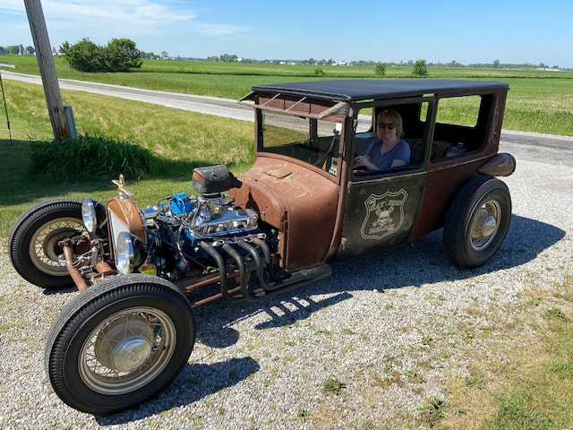

The sheet metal could be made into a nice parade car or just a "fun car" at modest cost. At worst, it still looks like a T, and it's still century-old Henry Ford steel, not plastic. Everything doesn't have to be a high point restoration.

A radiator would be highly susceptible to heat damage, as would an alloy pulley. The sheet metal would be excellent for a "rat rod" or "full custom" vehicle. Only direct examination can determine what might be salvageable from the chassis. China has plenty of strategic scrap metals. No need to be in a rush to send them more.

If the vehicle is insured, the only way to remove parts to try and reuse, would be to retain salvage from the insurance company. I would check with the state law about this, as some states do not allow this practice. I tried to buy a a salvage car to rebuild from Wisconsin and was unable to.
Almost 30 years ago my 1968 Mustang GT convertible was destroyed in a hit and run. I was lucky that I had a stated value policy because the insurance thought it was worth very little. I was able to get the appraised value for the car, but it cost me 30 percent to retain salvage. It was luck it didn’t burn because it would have been beyond repair.
Some parts might be salvageable from the fire, but as it was stated, would you want them on a vehicle you would have a loved one ride in?
Only after an in person inspection of the car/ and or parts would a determination be able to be made as to the viability of any given part.
I have almost 40 years of auto body repair experience that have formed my opinions, but is is only my opinion.
If this was brought to my shop, I would pass
Scott

Are we putting the cart before the horse? Yes all of what has been said is true but.............
Everything must be retrieved before a decision on any specific item being salvageable or not. For sure the longer one looks at it the less the possibility.
Model T have survived the elements, rodents, pigeon droppings, collapsed barns, car wrecks, and who knows what else...
Most of what I see, if it fails use for a Model T reuse, is 100% repurposed as art.

I’d like to see more pictures of the coupe to see why the top roof frame is so misshapen. Jim Patrick
- Posts: 4502
Re: Anything Salvageable or Scrap?
Aside from being nearly melted, it's very likely that some of the burning building fell on it.jiminbartow wrote: ↑Tue Feb 14, 2023 7:13 pmI’d like to see more pictures of the coupe to see why the top roof frame is so misshapen. Jim Patrick

To sum things up, has anyone on this thread ACTUALLY SEEN IN PERSON the damaged and burned cars?
Do pictures, opinions of pictures and judgements of things not seen in person actually tell the complete story of what can or cannot be salvageable?
And NO this isn’t about you knowing what an insurance company would do. They would claim it’s a total loss and its needs to hauled to the nearest scrapper.
Just wondering so speak up and have you made a judgement.

OP asked for advice based on the picture and story outline. More pictures would allow for more informed advice.
OP: "Any thoughts / opinions are welcome."

Most salvageable opinions are based on their personal end use of it.
As a restorable Model T doubtful. Some parts likely
As a body for a Rat Rod very possible - depends on the popularity of them in the area. There is always one looking for a deal.
As Yard Art, again depends on a vision

In that last picture is a very valuable brass, nickel plated tall radiator shell that could sell for $600.00 or more. The owner could remove and sell it and the garden art with the rusted radiator would still basically look the same without the shell. Jim Patrick

the 1 in the flower garden looks a heck of alot better than anything I started with.

Thank you to everyone who replied with comments and opinions. They were very helpful to the owner.
Someone asked about how the fire started. The owner was working on the car and put gas in it. He cleaned up gas that he spilled with a rag and put it in the running board. He then reached into the trunk and pulled a muscle in his ribs. He was in such pain he left the garage for the house and closed the door of the garage. The garage is heated with a propane heater (built in). When the heater came on the fire started.
Follow up on the cars. Several local Model T owners and club members have expressed interest in the cars for parts to complete their projects. This has been cleared with insurance so not all is wasted or scrap.
Thanks again to the Forum and members - what a tremendous resource!
