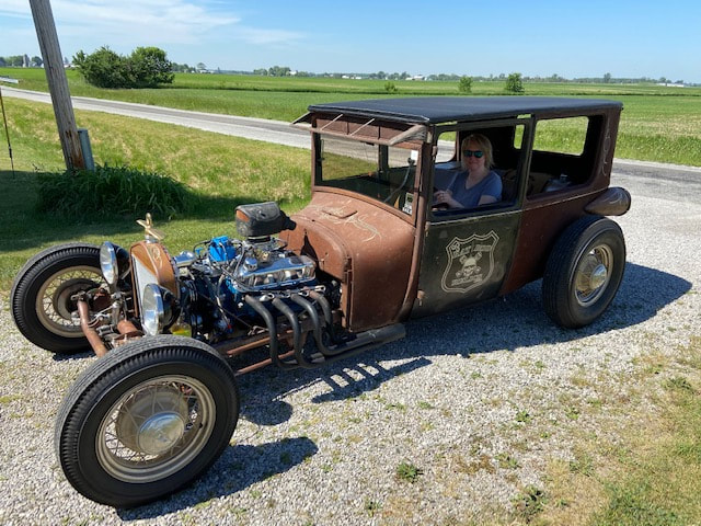

Post by TRDxB2 » Wed Feb 15, 2023 12:24 pm
Most salvageable opinions are based on their personal end use of it.
As a restorable Model T doubtful. Some parts likely
As a body for a Rat Rod very possible - depends on the popularity of them in the area. There is always one looking for a deal.
As Yard Art, again depends on a vision

Post by Bryant » Wed Feb 15, 2023 1:13 pm
then there is the possibility of it becoming a tractor ;)
