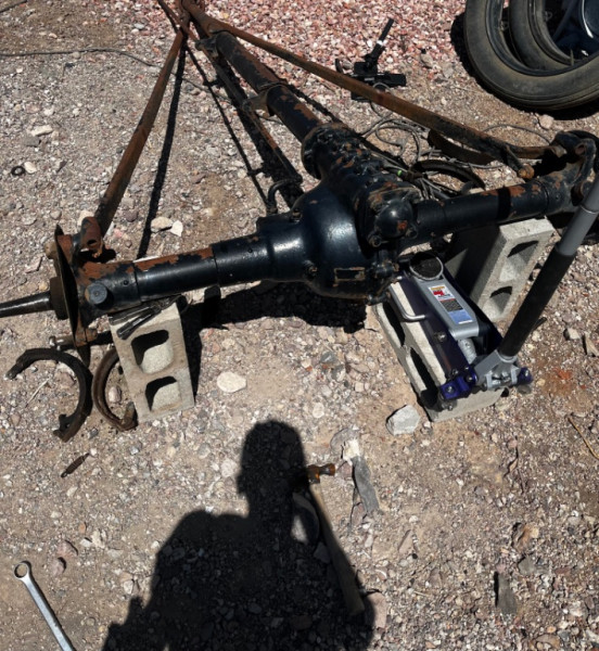

I recently acquired a TT ruckstell for my truck and I want to open it up and figure out what I need to replace. Also, I want to find a shifter that goes in the middle of the floorboard and not through the handbrake hole because I want it to be next to my Warford shifter. What type of shift assembly do I need for this setup? Do I need any special tools? What size wrenches do I need? When I open it, I will keep this thread updated on what I find.
Thanks in advance, Jacob Mangold

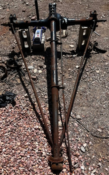

Thank you Tom. Really any shifter that mounts to the u joint bolts should be able to work. I have an early TT Ruckstell with no shift lock so it will be interesting to see what I find when I crack it open. I will probably get into it in about 2-3 weeks.[attachment=0]

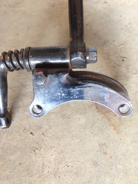

This won't really help get you the TT Ruckstell shift lever you want since I plan on using this one on my 1926 Closed Cab TT. However, here is what a TT lever looks like. Rich C.

Thank you Rich. That is ok because I hopefully already have someone who possibly has one that I will buy.

I think you might run into some fitment issues putting the shift lever where you are thinking with the Warford mounted behind the end of the transmission. The L shaped lever at the front, puts the shift rod more or less going through the Warford, it will need to go around it.

I was thinking about that as well. I might have to do some fabrication because my frame was also extended for the Warford. I will have to see and example from someone else who has both of them on their TT.

My first suggestion was to clean off the outside but I see you've already done that. Some of the housing half bolts can be a bugger, there very little room for sockets on a couple. Have some kind of support, those housing halves are really heavy. When I split them now i have a stack of pallets 5 high with a piece of plywood on top. It allows you to rock the housings and pull off one half. Be ready for the sludge that is inside, you hope it's there, it will have protected the parts inside from moisture.

Thank you Bob. I’m in no rush to put it on. I still have to remove rust, check the perches, prime it, paint it, and then figure out how to get the shifter and rod to connect because I have a Warford and an extended frame.
