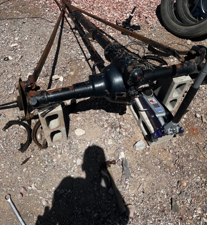

I recently acquired a TT ruckstell for my truck and I want to open it up and figure out what I need to replace. Also, I want to find a shifter that goes in the middle of the floorboard and not through the handbrake hole because I want it to be next to my Warford shifter. What type of shift assembly do I need for this setup? Do I need any special tools? What size wrenches do I need? When I open it, I will keep this thread updated on what I find.
Thanks in advance, Jacob Mangold

Thank you Tom. Really any shifter that mounts to the u joint bolts should be able to work. I have an early TT Ruckstell with no shift lock so it will be interesting to see what I find when I crack it open. I will probably get into it in about 2-3 weeks.

My first suggestion was to clean off the outside but I see you've already done that. Some of the housing half bolts can be a bugger, there very little room for sockets on a couple. Have some kind of support, those housing halves are really heavy. When I split them now i have a stack of pallets 5 high with a piece of plywood on top. It allows you to rock the housings and pull off one half. Be ready for the sludge that is inside, you hope it's there, it will have protected the parts inside from moisture.
