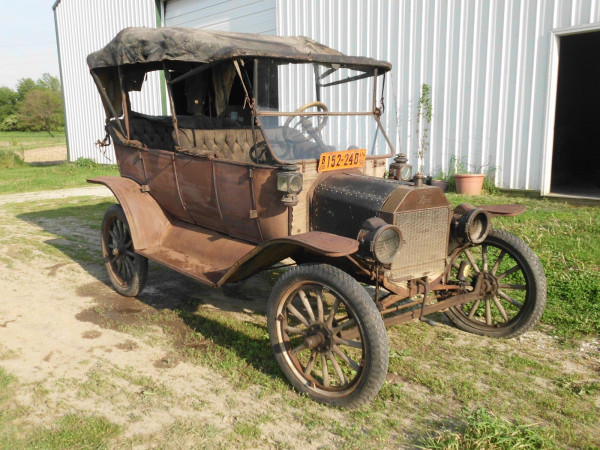

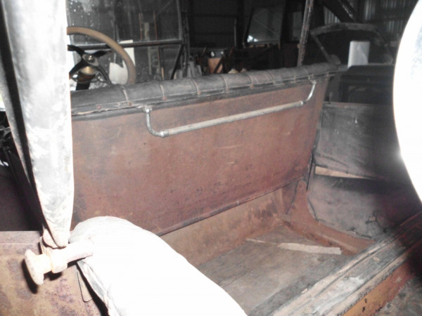

My Jan. 13 Touring has almost no paint left on the body but it looks like some evidence would be left behind if it had stripes and so far I can not find anything on it. If I were to restore the car it might show up because the surface rust would not be as deep where the stripe layer was like it did on my 25 Indiana Truck when I sanded it down to bare metal. I knew the truck had a stripe because it was still there before I sanded it but it still showed up in the metal after all paint was removed. I don't plan to restore the 13 at this point but if I ever do this is one thing I will be looking for. Till then, I plan to inspect this car very close up when time permits and see if anything shows up.
Because of this I would have to agree with Larry on this.
I would like to know if any stripes would have been on the back of the front seat or on the seat riser front panel of the front and or rear seats as mine still has paint in these areas.

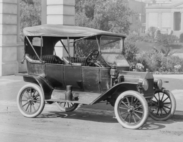

I harvested this picture of this pinstriped Canadian 1913 touring off of the interweb.
There is a pinstripe on the back of the front seat but only to the top of the body. The hood is not striped. If a hood is striped, the pinstripe goes vertically along the radiator all the way to the center hinge, along side of the center hinge to the firewall, then all the way back down to the bottom, just like on Russ' car. There should be no "boxes" on the hood. By late 1911 there was no pinstripe on the heel panels.

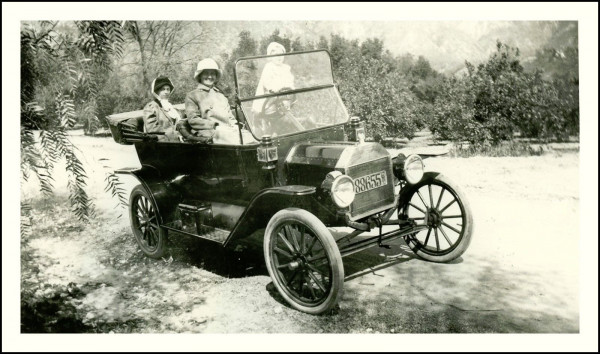

I know this will not make Larry happy, but here is an original photo of a 1913 touring with a 1913 California license plate. It sure look like it has pin striping on the body! Russ Furstnow

Here is another photograph of the 1913 "California 88655" car Russ first posted above.
Seems to have a set of Black & Brass "John Brown 19 style" headlamps that have been electrified.
The front fenders may be the short bill early style as well.

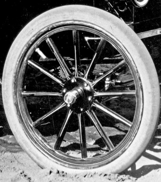

This is a late 1912 pin striped wheel from a photo of a brand new car with Henry Ford driving. The photo is property of the Henry Ford Museum used under license.
