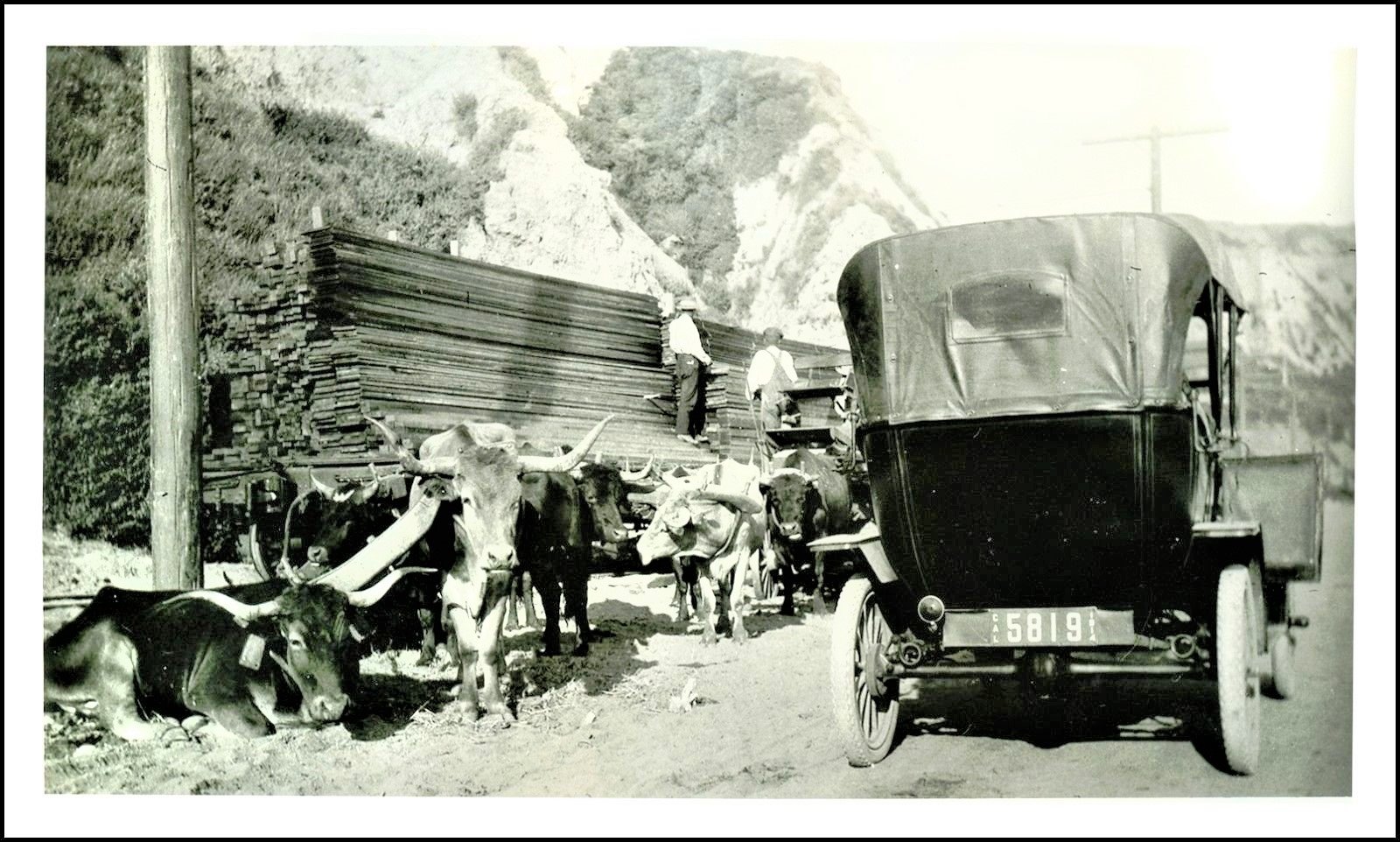

Here is another 1913 touring showing the pin strip at the rear, and another that has had a problem with a train!! Russ Furstnow

I wanted to thank Russ for the image of the 1913 from the rear. There are very few images of pinstripe from the back.
Here is the same image, but I have enhanced the contrast a little to bring out more detail:
Click on the image to see it better.
I wonder what the stripe looks like at the bottom of the 1/4 panels and the back panel. What does yours look like, Russ?
I also wonder about the "screen" behind the license plate...
