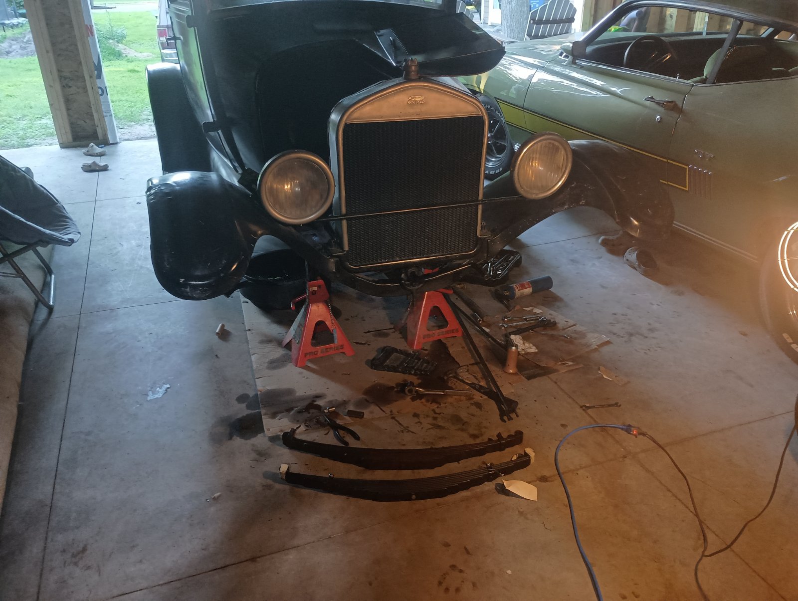

I had a little bit of time to work on it today. I got the spring perches half way out. I loosened them up by putting a braker bar through the hole and twisting them. And then beating them with a big hammer. They are rusted pretty good.
I do have one question. I is this wishbone ball still good. It looked a little out of round but not horrible. Just checking what you guys think.

The best check on worn balls and sockets for the wishbone is to fit the cap with no springs. If there is a rattle still, the ball/socket are well worn. You can buy new caps for the socket, and a shim in the socket may belp, but a built-up ball will be the real fix.
And if you can't build up the existing ball, use this. https://www.snydersantiqueauto.com/prod ... &cat=41901
