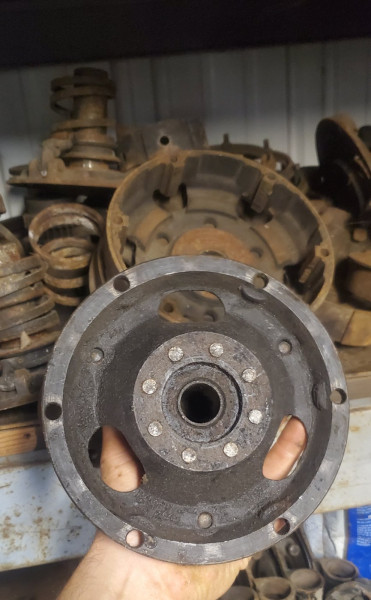

Re: WTB Drive Plate for 1925 Brake Drum With lugs
I can look thru my stash I may have one
First one I grabbed measures 6 11/16 across the pattern
- Posts: 4977
Thats not what he is looking for. What you have is for a wide drum.Karl Von Neumann wrote: ↑Sun Jun 15, 2025 5:58 pmFirst one I grabbed measures 6 11/16 across the pattern
Put it on your narrow drum & notice the OD is too small. The OD should be the same as the drum band surface.
