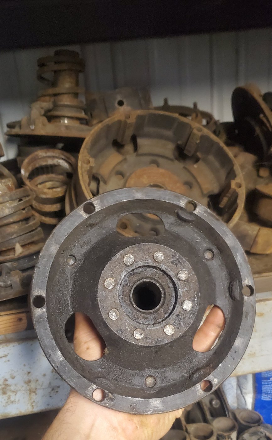

I can look thru my stash I may have one

First one I grabbed measures 6 11/16 across the pattern

Thats not what he is looking for. What you have is for a wide drum.
Put it on your narrow drum & notice the OD is too small. The OD should be the same as the drum band surface.

I have like 10 or 15 more I guess I misunderstood what the difference was I still may have one
