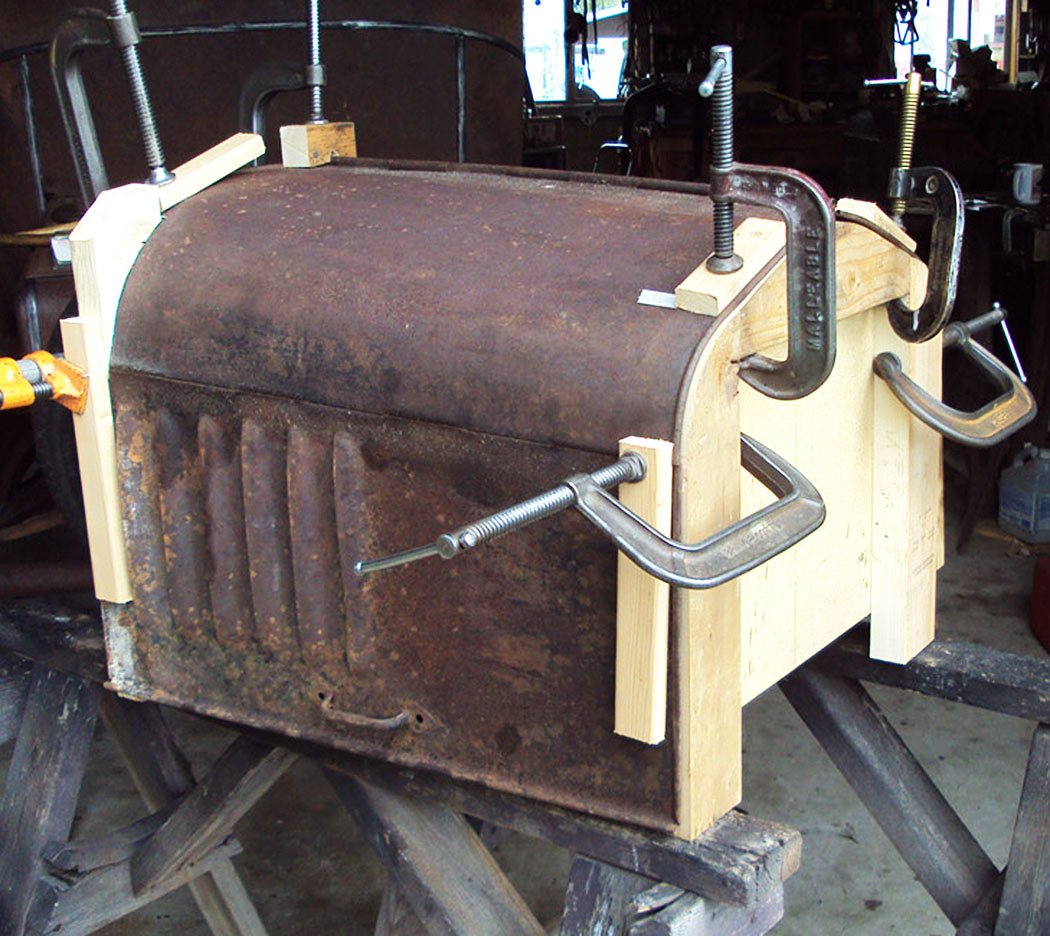

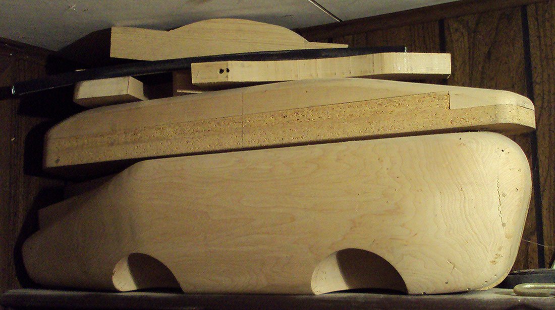

Straightening panels seemed to elude me so I started building a few new ones. The more I did the better results I had. Getting the feel of working the metal helped me learn enough to tackle things I couldn’t do earlier.
I wanted to try to save this quarter panel for my ’14 Touring as it was the only one with the correct fender bead. It was so bad I had nothing to lose. Reversing a wrinkle without stretching the metal any further is the key. Using simple tools I used in fabrication I could persuade the metal nearly straight again. Clamping large areas with lumber and pressing steel flat are shown here. Further smoothing and flattening might return this to show quality by someone with more time and expertise. As this car was not to be given a glossy finish the work done was good enough for now.

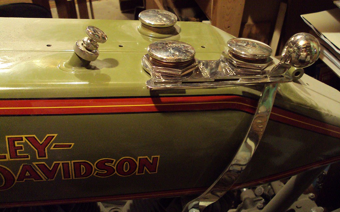

I broke what I call the regulator handle on the side window on my 1925 coupe. Looked for several years, and seemed I would never find one. One day, I decided I would make one. Took three pieces, welded them up, and nickel plated it. I thought it turned out pretty good.

Holy cats Mike! That regulator look a lot like the ones for a late Center-Door project I had been waiting for and wait to do.

Beautiful work Mike. Thanks for posting it. I have found when you make things like this that you can't find they show up at the next swap meet.

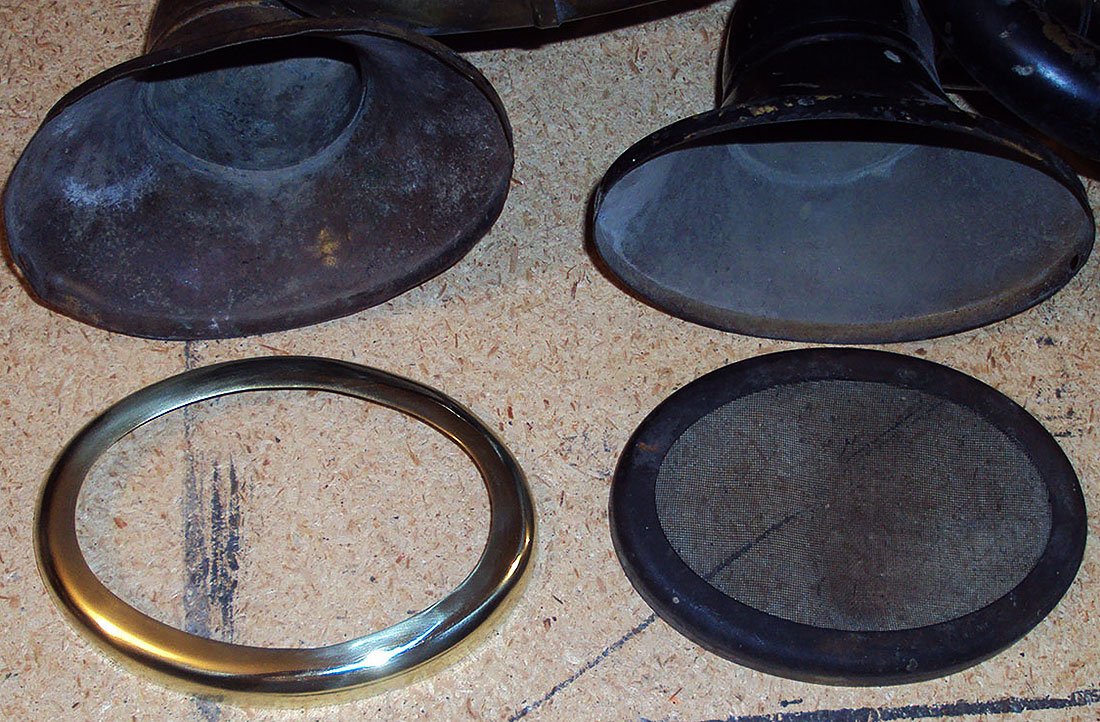

My brass radiator was missing a side. These are available but I had some sheet on hand and decided to make it. This shows some of the steps and tooling.

Rich - You possess two "qualities" that are unbeatable! You have fantastic metal-working skills, and extreme patience! This has so far become one of my favorite threads on this forum. The examples you have shown,on this thread as well as over the years on the old forum are nothing short of amazing! One of the first examples of your beautiful work was several years ago when you designed and built (...not sure of the right terms here) an exhaust heater assembly that fit into a Model T floorboard. Talk about "a work of art"! When you get time, why don't you show (or provide a link to) that "project" that you built,....? That was a "thing of beauty" for sure!!! .....harold

My 1919 Harley Davidson has given me opportunities to learn some new skills. The gas and oil tanks were rusted out but I could see how they were constructed. The sides and pockets for the intake rocker arms were soldered in place. There were baffles and a divider in one tank that separated gas from oil were visible through the rust out. I made some maple forms to bend some sheet metal on. The filler necks were bronze and turned from bearing stock. The caps, nuts, shifter gate and shifter lever were made of steel and nickle plated. Since I knew the distance between necks I could enlarge a catalog cut of the shifter gate and trace it onto steel plate. The little pump in the tank sends extra oil to the crankcase when needed. Everything in the pictures was hand made except the frame the tanks are mounted on. Although I let car projects take over my time the Harley has increased in value more than the Ts since I bought it for $75 in 1973.

The battered horn for my '14 needed a door for the screen at the front of it. I have one with my better horn for another car I used as a pattern. Forming .025 thick brass over a maple form was my plan. You can only form the brass so far before annealing.
I made a second form the right thickness to allow trimming and filing to the final dimension. Too much extra material made the buckling bad but kept me from not having enough. It's a learn as you go thing. Hose clamps worked well at this point. Low and behold, with a little patience the bumps work out and the brass can be filed and sanded and then polished. As the wrinkles work out the brass becomes thicker as it is being compressed. By the time you file and sand it it gets close to the original thickness again. Pretty neat. This was one days work forming the brass. Another day could make it much nicer but this one is good enough for this horn. Yes that is the same piece I started with and the hole I burned through will not show. Now, where did I put that screen I bought 20 years ago?
The brass buckles badly but can be worked. I started out with soft hammers of rubber, leather and hardwood but soon steel seemed to be the only thing that worked. Clamping shoes left over from cutting out the form worked well at one point.
Feeling the propane torch wasn't fast enough I got out the acetylene torch and annealed a hole right through the piece. Oh Scrud! It is best to take your time. Soon the piece looks like it is beyond repair but have faith. I made a second form the right thickness to allow trimming and filing to the final dimension. Too much extra material made the buckling bad but kept me from not having enough. It's a learn as you go thing. Hose clamps worked well at this point. Low and behold, with a little patience the bumps work out and the brass can be filed and sanded and then polished. As the wrinkles work out the brass becomes thicker as it is being compressed. By the time you file and sand it it gets close to the original thickness again. Pretty neat. This was one days work forming the brass. Another day could make it much nicer but this one is good enough for this horn. Yes that is the same piece I started with and the hole I burned through will not show. Now, where did I put that screen I bought 20 years ago?

"Hose clamps worked well at this point."
Rich, were you using the hose clamp to keep the flange from moving around while you tightened up the corner radius ?
Dick
Dick
Topic author - Posts: 6895
Re: Revisiting some fabrication
Tapping on the upper part of the curvature tended to spread the metal way from the form. The hose clamp kept the outer edge tight. It really made a difference.

Many coil boxes have badly deteriorated switch bodies. I brought the one on the left back to life using bondo and flat black enamel.
I took the worst one I had and cut two pieces of thin particle board to it's original shape. Using 5 original thru holes I screwed the pieces to it. Some random holes around the outside will give grip to the bondo. Masking tape helps keep the bondo from sticking to the partical board and makes it easier to separate them. I made new threaded inserts for the cover screws. Then the bondo is applied with a putty knife. Some sanding after the bondo dries and it is ready to paint.
There are many other products that may work as well or better than bondo. I use it because it is handy and has better shelf life than some others I have tried. The Bondo radiator caps and door handles I made have held up well for many years.Rich

This is a jig I made to straighten my Coupe hood. The curves often seem to get out of shape. It got this hood as close as it needs to be. (There is even some original paint on it.)
