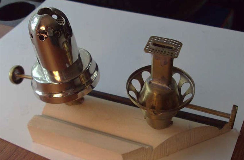

Post by Rich Eagle » Sun Jan 13, 2019 10:52 am
Part of the fun of keeping an old car is being able to make needed parts for it. Touring and maintenance have kept me busy and I haven't had to make anything lately. I thought some parts I made years ago might be fun to post now.
When the nice repro E&J burners were only $85 I decided to try to make some from scratch. Here is the post from 2012:
http://www.mtfca.com/discus/messages/25 ... 1326907131
Whether 5 weeks making 5 of these was worth the savings is debatable but the satisfaction was more that worth it.
There isn't much we can't make if we really want to. Forum members and other car nuts have proved that.

Very impressive as usual, Rich.
Not infrequently I find reproduction items don't quite work like they should, or one detail or another is lacking. I try not to look askance when that happens, as I know how incredibly difficult the work can be from my own experiences making "stuff". If time is money, I'm just glad no one is making me pay for the fun I have making things !

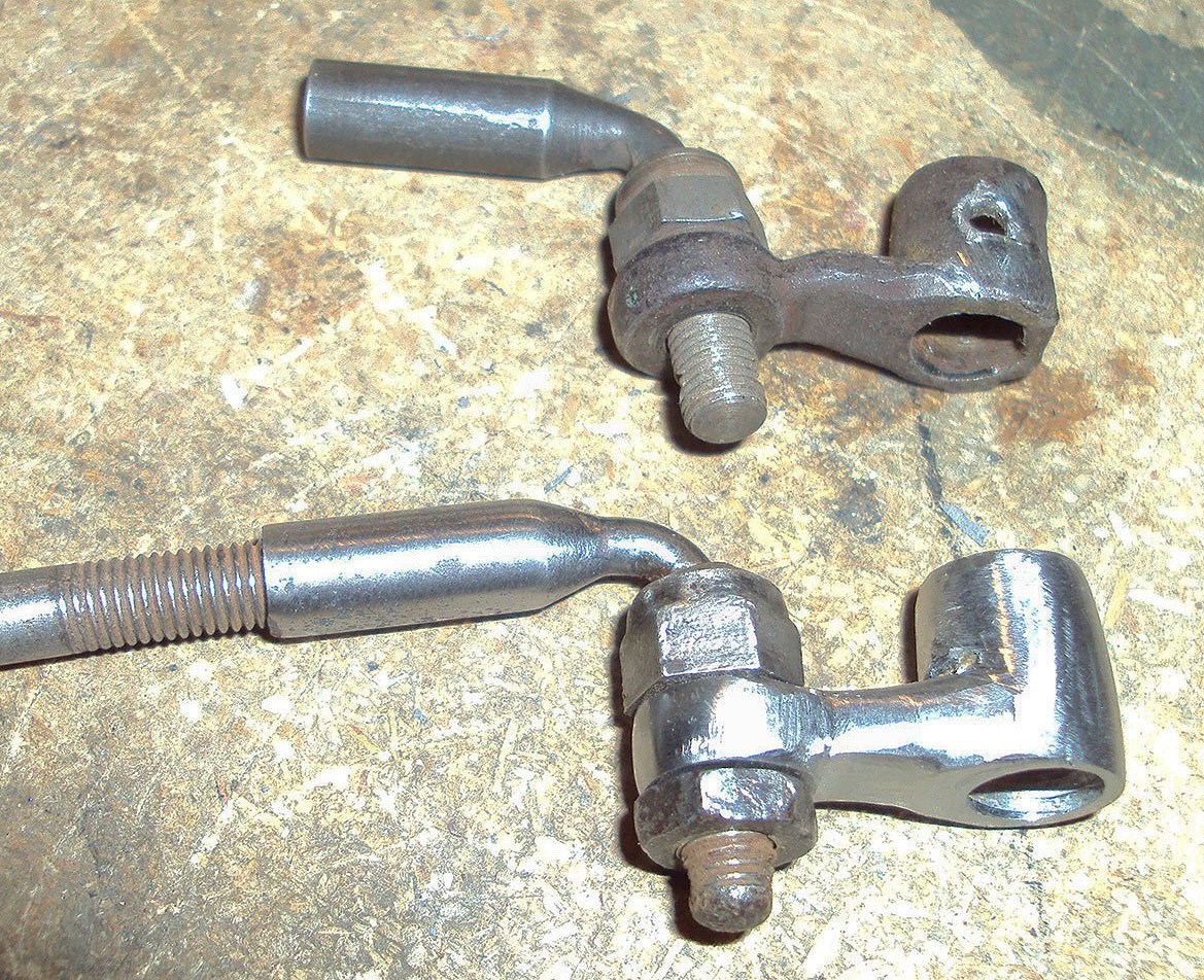

Re: Revisiting some fabrication
Post by Rich Eagle » Mon Jan 14, 2019 11:07 am
This is a simpler project. I needed a handle for my '15 hood.
http://www.mtfca.com/discus/messages/70 ... 1497523020

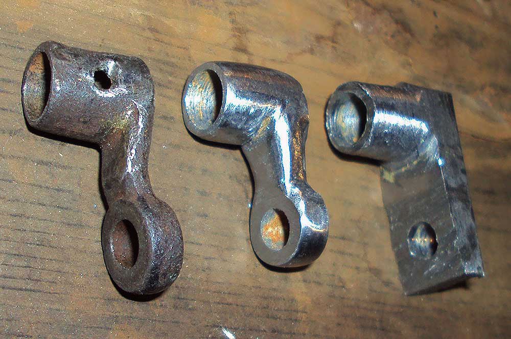

Post by Rich Eagle » Wed Jan 16, 2019 11:13 am
Making new sleeves for some top irons is show in this thread.
http://www.mtfca.com/discus/messages/70 ... 1510684831

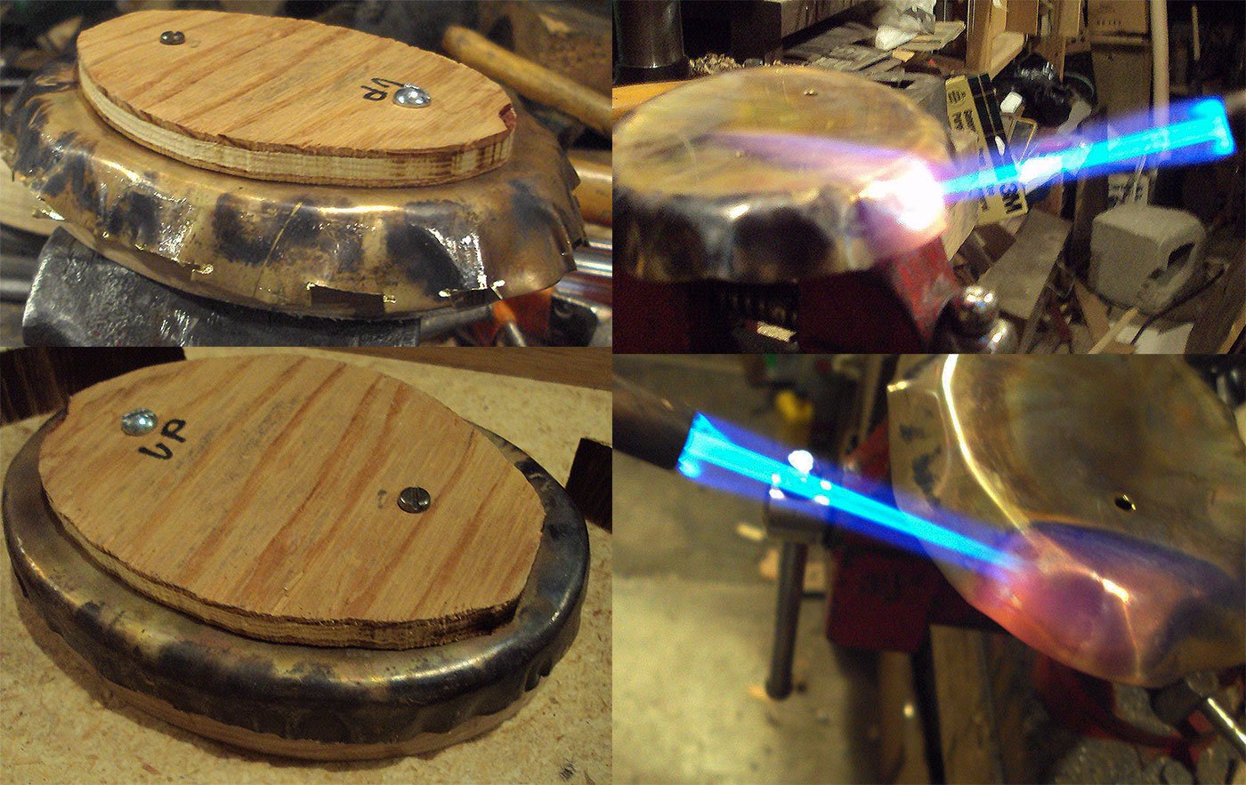

I don't know how you formed those lamp burners. When I form parts they always look home made. My hood handles look wonky & uneven and yours look die formed.
Post by Rich Eagle » Wed Jan 16, 2019 1:47 pm
Maybe we make it look too easy when we just show stuff that turns out. Many of my parts do look horrible at some point and as if they can't be saved. I have a pile of things that didn't turn out. With some persistence most can be tweaked, tapped on or filed and polished to a better look.

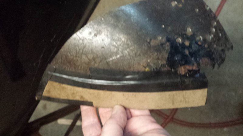

Straightening panels seemed to elude me so I started building a few new ones. The more I did the better results I had. Getting the feel of working the metal helped me learn enough to tackle things I couldn’t do earlier.
I wanted to try to save this quarter panel for my ’14 Touring as it was the only one with the correct fender bead. It was so bad I had nothing to lose. Reversing a wrinkle without stretching the metal any further is the key. Using simple tools I used in fabrication I could persuade the metal nearly straight again. Clamping large areas with lumber and pressing steel flat are shown here. Further smoothing and flattening might return this to show quality by someone with more time and expertise. As this car was not to be given a glossy finish the work done was good enough for now.

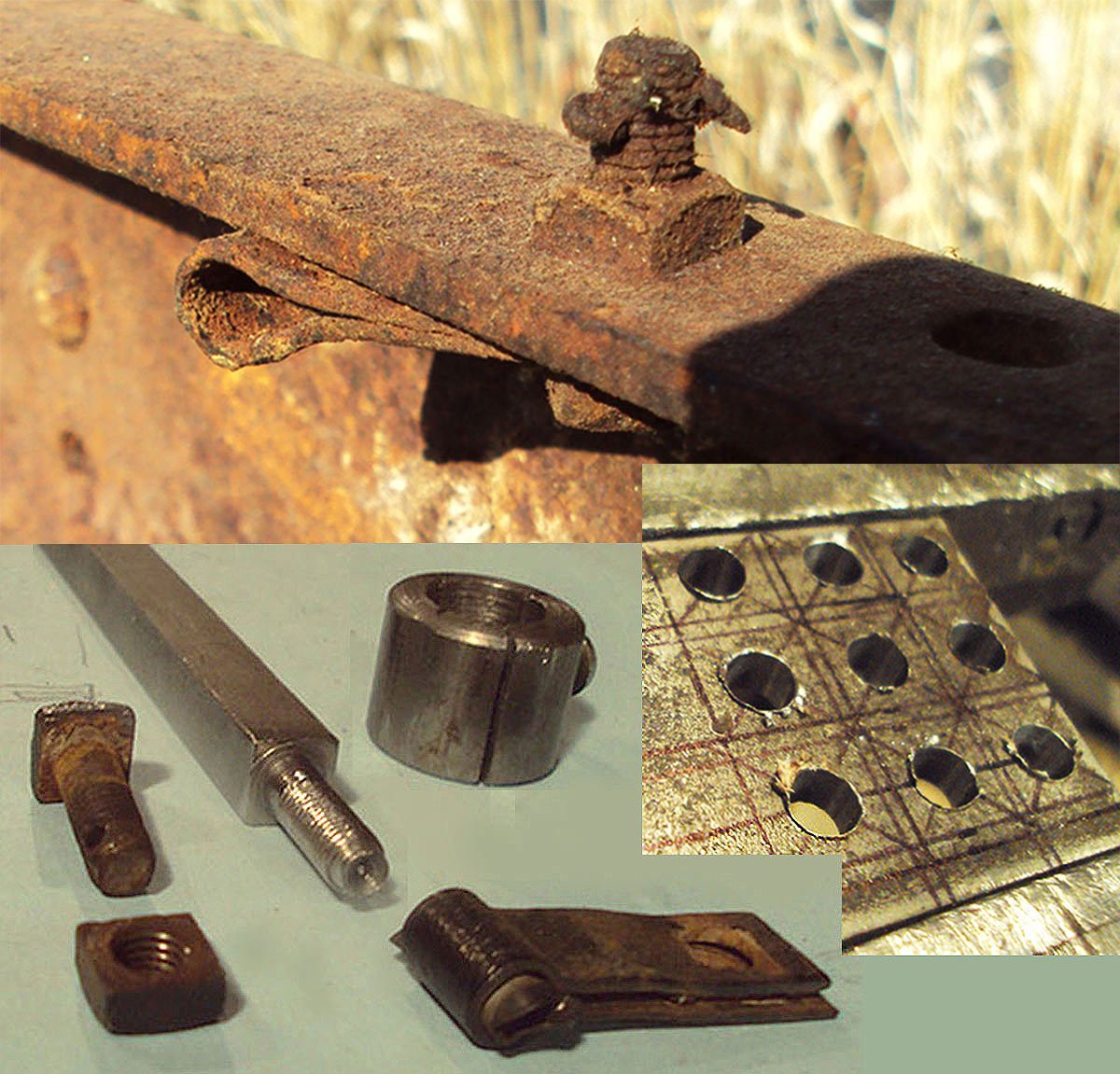

Post by Rich Eagle » Mon Jan 28, 2019 6:17 pm
While this isn't a Model T unit the techniques could be used on anything. The rear axle brakes on my 1907 Buick were cobbled together such that they were dangerous. I tried to improve the mechanical advantage but couldn't improve the makeshift parts. I happened upon some Buick patent drawings for a different model but thought it might work. Scaling the drawing to my drum size I could trace out the parts and cut them from steel. The band is just cold rolled bar shaped around a maple block. Screws and pins are riveted and hold it together. Welding might work better but I rivet better than I weld. These work as well as a 26-27 T hand brake now. The Buick planetary had no brake. Just reverse and low drums so I need the rear brake.

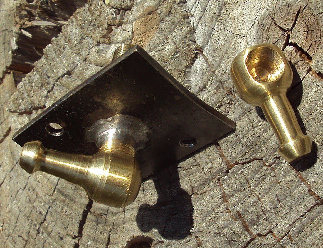

Post by Mike Thomas » Mon Jan 28, 2019 9:13 pm
I broke what I call the regulator handle on the side window on my 1925 coupe. Looked for several years, and seemed I would never find one. One day, I decided I would make one. Took three pieces, welded them up, and nickel plated it. I thought it turned out pretty good.

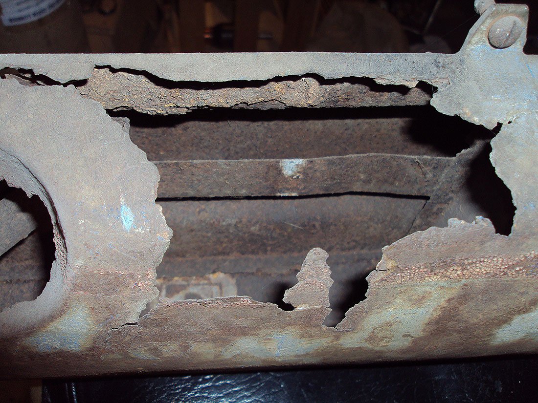

Post by Rich Eagle » Wed Feb 06, 2019 11:31 am

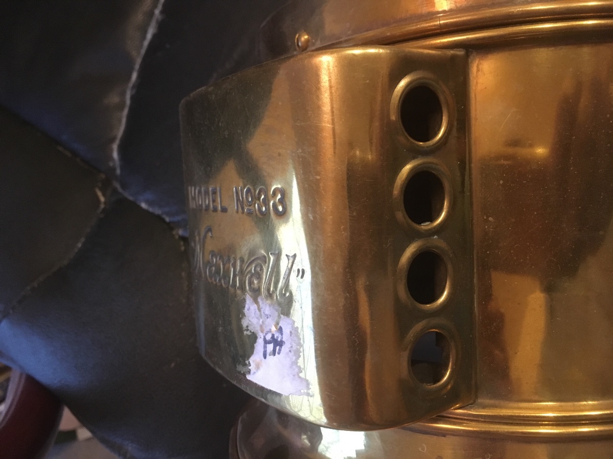

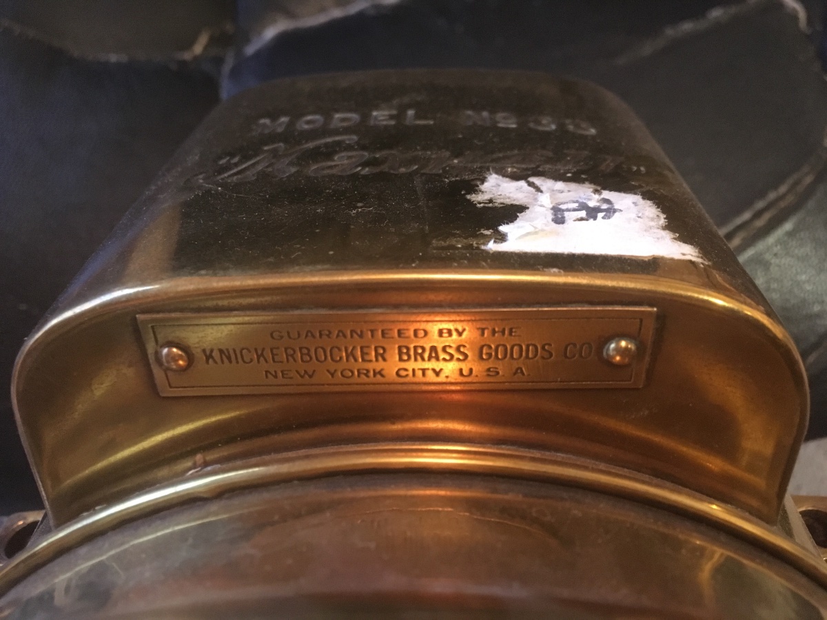

My brass radiator was missing a side. These are available but I had some sheet on hand and decided to make it. This shows some of the steps and tooling.

I have built heater shrouds and doors for my two closed cars with heater manifolds. I had a tattered old shroud to work from but had not seen many doors so I designed my own. In addition, new carburetor stove pipes had to be made.
These were for my 1922 Coupe. The grille is made out of 22 gauge and has a .100" lip around it. The slide door is 20 gauge The pictures were taken it may of 2013.

The battered horn for my '14 needed a door for the screen at the front of it. I have one with my better horn for another car I used as a pattern. Forming .025 thick brass over a maple form was my plan. You can only form the brass so far before annealing.
The brass buckles badly but can be worked. I started out with soft hammers of rubber, leather and hardwood but soon steel seemed to be the only thing that worked. Clamping shoes left over from cutting out the form worked well at one point.
Feeling the propane torch wasn't fast enough I got out the acetylene torch and annealed a hole right through the piece. Oh Scrud! It is best to take your time. Soon the piece looks like it is beyond repair but have faith.
I made a second form the right thickness to allow trimming and filing to the final dimension. Too much extra material made the buckling bad but kept me from not having enough. It's a learn as you go thing. Hose clamps worked well at this point.
Low and behold, with a little patience the bumps work out and the brass can be filed and sanded and then polished. As the wrinkles work out the brass becomes thicker as it is being compressed. By the time you file and sand it it gets close to the original thickness again. Pretty neat. This was one days work forming the brass. Another day could make it much nicer but this one is good enough for this horn. Yes that is the same piece I started with and the hole I burned through will not show. Now, where did I put that screen I bought 20 years ago?

"Hose clamps worked well at this point."
Rich, were you using the hose clamp to keep the flange from moving around while you tightened up the corner radius ?
Dick
Post by Rich Eagle » Tue Mar 19, 2019 2:43 pm
Tapping on the upper part of the curvature tended to spread the metal way from the form. The hose clamp kept the outer edge tight. It really made a difference.

A few pieces had to be made for my 1914 headlamps. I have used screws but rivets would be more correct on this lower baffle plate.
The burner base curve is done using wood blocks. A standard pipe nipple is close to what the original was. A tapered rod was turned to size and swells the hole to the right size and configuration.
These elbows are just a simple machining project.

Rich as always, Love your posts. Between you and Hank , It is quite inspiring. I have a Maxwell chimney that I have been looking for, I know that you guys could make one. I might just give it a try... :? Thanks, jw
Post by Rich Eagle » Fri Apr 05, 2019 9:03 am
Hi John. What does the chimney look like? I have a few Maxwell lamp parts. I have several things like that I would like to make but don't know when I might get around to it. Work for others is a tough one as things take me so long. There have been other requests and many are beyond my abilities.
John Warren
Posts: 1070
Last Name: Warren
Location: Henderson, Nevada
Post by John Warren » Fri Apr 05, 2019 9:32 am
Rich, It's for a # 32 or a # 33 Maxwell head lamp. I have one of each and am trying to get a pair of one or the other. I'll get a photo this afternoon. Thanks jw
John Warren
Posts: 1070
Last Name: Warren
Post by John Warren » Fri Apr 05, 2019 10:01 pm
My bad actually a #33 or #34
Thanks jw
Post by Rich Eagle » Fri Apr 05, 2019 10:20 pm
It sure looks nice John. The lettering is far beyond anything I have ever done. I have thought of doing some like that by soldering a panel in the front and back. The main shape would be easy enough to do and the holes wouldn't be a problem. Some lamps I have need that. If I ever try it I would let you know. Hopefully you will find a good original first.
There are some plain ones that look similar but probably not the same size around here somewhere.
I wish I had better news.

Another part I couldn't find in 1996 was a good original type rain gutter for my Tudor. I had the remains of one side so I tooled up to make some. The main tooling consisted of 2 pieces of 3/8 x 1 1/2 bar with holes drilled 12" or so apart. Also a 1/2 x 1/2 bar with grooves ground down it's length. Bending some sheet metal sheared to a measured width to 90°was the first step. Then pounding a plate or pressing some rods formed the gutter groves. I tried both methods for different gutters. The gutter is nailed to the car and a filler piece covers the nails. I pressed the filler into place but others have slid it in from the end. A filler form a measuring tape works as well as the fabricated piece I made. With some trial and error I made gutters for 2 cars. Some nice repros are available now but this was my solution.

It's fairly easy to whittle out pieces like this spark rod lever with a hacksaw and file. Not perfect but works well.

My '14 frame had an original clip for the acetylene line on it. (frame upside-down in top photo) It was fairly simple to make some identical clips. I decided to make the bolts and nuts also so they would be very close to the same dimensions. The split collar allows me to mount square stock in a 3-jaw lathe chuck. The plate with holes and markings are the nuts before cutting them out. One small collar is for chucking the threaded bolt for chamfering the head. The other is for drilling the cotter pin hole.

Thanks for showing this Rich. I am fairly new to my Rockford economy lathe. I made probably 75 bolts for the 8in1 bed out of elevator bolts but now I know how to make the square bolts and nuts thanks to these photos. Just had titainium plates installed in the C-spine today so looking and learning is about all I can do for now. Normally Im sleeping at 2:50 am but not today.

Dallas, I don't recall where I saw that collar trick but I spent hours setting up on a 4 jaw chuck before I did. There are a million tricks out there we won't learn.
Larry, I didn't rivet to the top tank. That would have required taking the front or back of the tank loose and my soldering is not that great. It seems I drilled holes to clear the existing rivets and soldered around them. I know what you mean about the lengths to make a good radiator. If I did radiators all the time I could make a better radiator but the time would be several times others take and not many would pay for that. At least I wouldn't. I respect your wanting thing right.
Mark, your words are always good to hear. I will note that much of my inspiration comes from this Forum lately. Also, posting things here makes them easier to find when I need to look back.
Thanks for the interest.

Today I made new brake cam sleeves. The old ones I made 11,000 miles ago were easy to form from 20 gauge (.036"). They helped at the time but the brake shoes have worn down some more. I chose some .081 thick stock (about 14 gauge) for the new ones. It doesn't bend as easily as the thinner steel did. Fortunately I had a jig from some other project (I can't remember what now) that would work to help bend the sleeves.
The pictures show how I pressed the steel into a U-shape using the jig and finish bending with a vice. The final push was back in the press.
These new sleeves result in the brake lever cam arm being nearly straight up (just a little before) when the shoes engage the drum. This is where the most mechanical advantage is. With the thinner sleeve the arm was about 25°to 30°forward which was not nearly as effective.
Vendors sell these but I am not sure what thickness they are.
