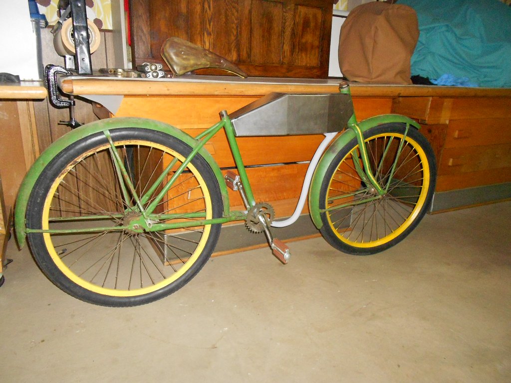

Re: What have you done on an old non-Model T vehicle.
Love the bike!!!

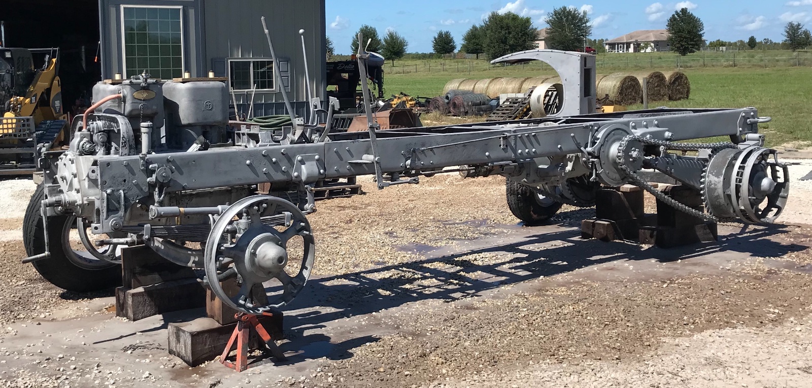

Doing some cleanup this week.
Hopefully moving into the cleaner assembly stage.
Before : After: Now that’s a piece of art :
Art? It sure is! That drive is gorgeous Paul and those sprockets look great! What color? No wait, show us when painted.
What a $#@! BEAST !!!
Hmmm...wonder what color it could be ?
That is a behemoth, very cool !!
It will be modeled after our other Wrecker with similar accents, but I’ll have to change the color from ‘Coal Black’
- to gloss ‘Black’ in accordance with the model year !
Engine cylinders, squirrel cage, wheel hubs, sprockets (and possibly chains ?), as well as winches/cable pulleys (safety) will be accented as our TT.
All aluminum (block, pan, and transmission) and brass/copper will remain exposed (possibly clear coated to prevent oxidation).
A lot of work yet before that happens.

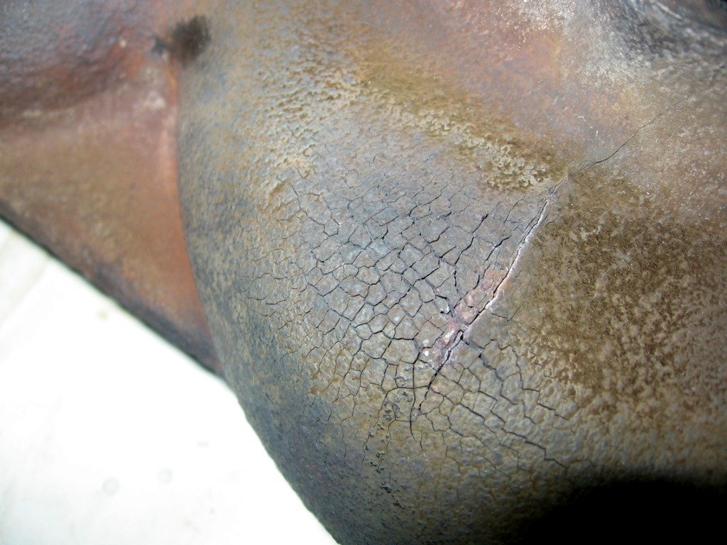

Now that's pretty interesting to me because just last month I had to replace the manifolds on the 350 in my '71 GMC. People on the Chevy truck forum and elsewhere told me they had never seen this before and that I must have something wrong ranging from timing to blocked exhaust, but there is absolutely nothing wrong with how this truck has run and performed for the ten years I have owned it and everything checked out afterward.cudaman wrote: ↑Sat Aug 31, 2019 12:44 pmA couple of months ago, I finally got fed up with the exhaust manifold leaks on my 1971 Plymouth GTX. I thought that the gaskets were blown, but once I got the manifolds off it turned out that the driver side manifold was cracked into two pieces and the passenger side manifold had a circular spot with cracks radiating from it.
I purchased two good used manifolds and swapped them in, the exhaust is nice and quiet now.![]()
I started out replacing a muffler and knew that I had some leaks up front, what I thought were bad donut gaskets. While the pipe was disconnected I decided to move to the front and do the gaskets and that's when the pipe wiggled in my hand and I knew something bigger was wrong. The left side manifold had a heat shield over it, so I never could see this happening. The right side was starting to do the same but it wasn't obvious yet. Seems to be right there where all the heat concentrates where it dumps out the middle. Maybe it's a junk 1970's iron thing.
Looks very similar to what happened on my GTX, I wonder if it's just age and heat cycles catching up with the cast iron?
It almost makes me think it's something to do with the era because I've worked on a lot of older stuff that has seen a lot more abuse and miles than my truck and I've never seen a cast iron manifold do that before. My truck only has 105,000 miles on it.

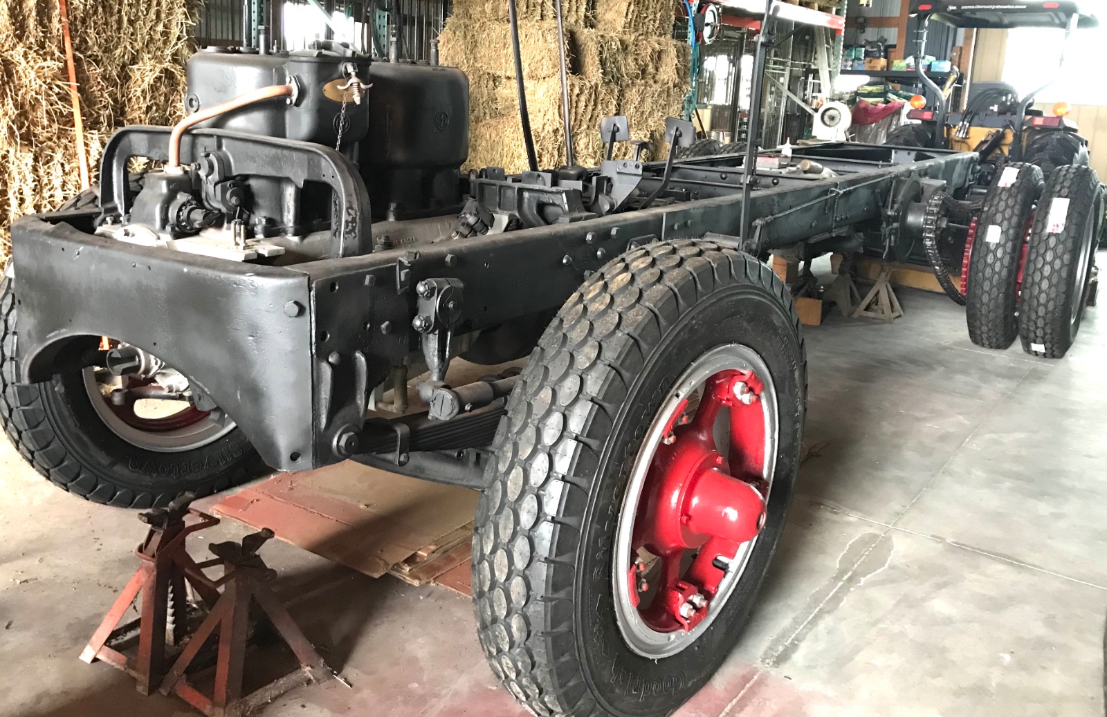

Finally got the new shoes on. First time on its own rubber in over 12 years. Had to get them on to be able to move it easier during the assembly.
Good work. Those tires will last forever. Not cheap tho are they?
Looking great!
Looking great!
- Posts: 239
- First Name: Paul
- Last Name: Grohsmeyer
- Location: Central Florida
They came with a lifetime warranty
1k each.
1k each.

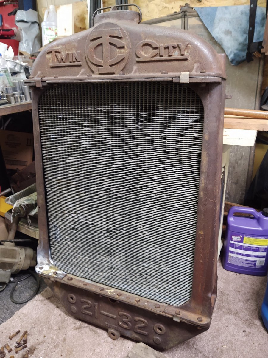

I still work away at study and moving forward with my non-vehicle project/projects. Deep in the rabbit hole, I've even noted hose clamp fixes and fails on 90 year old foolishness. Much to do!
Great thread Rich! Excuse this late night OT.
One more little 130 pound piece of a puzzle.

Had to do a bit of mock up this week.
Since everything is based on the cab assembly, I had to temporarily remount the cab and cowl
on the chassis in order to do a fit up of the new fenders and running board fabrications.
Still have a bit of work to do on the fenders.
But it’s lookin good over all.

Thats looking great. You have been busy.

That old AC Bulldog is coming along nicely ! love it !

The Mack is looking really nice Paul! How many cubes is the engine?

You have me as the 4 cylinder engine behind my radiator above is at 413 cubes at 4-11/16x6 right now.
4-3/4 is my limit at 425 cubes.
Big Mack engine! No wonder you ponder cranking. Me too. I don't happen to have enough belt pulley parts and a belt to spin...
I'd bet you'll rev your Mack engine a bit higher than my 1075 max...
I'm pushing just about 50 horse perhaps. Your Mack, a bit better!
For the Mopar fans? Burger?
I have two engines in 1928 (OT) 17-28 tractors 26038 and 26068 that are 340 cubic inch, Twin Cam, 16 valve @ 1000 rpm.
Company literature say the engines will make 40 hp. Grunt! A Twin Cam monster will come here yet at 641 cu. in.
5x6 is a big engine. Thanks Paul!
Keep posting pics if you would. Love your beautiful truck!

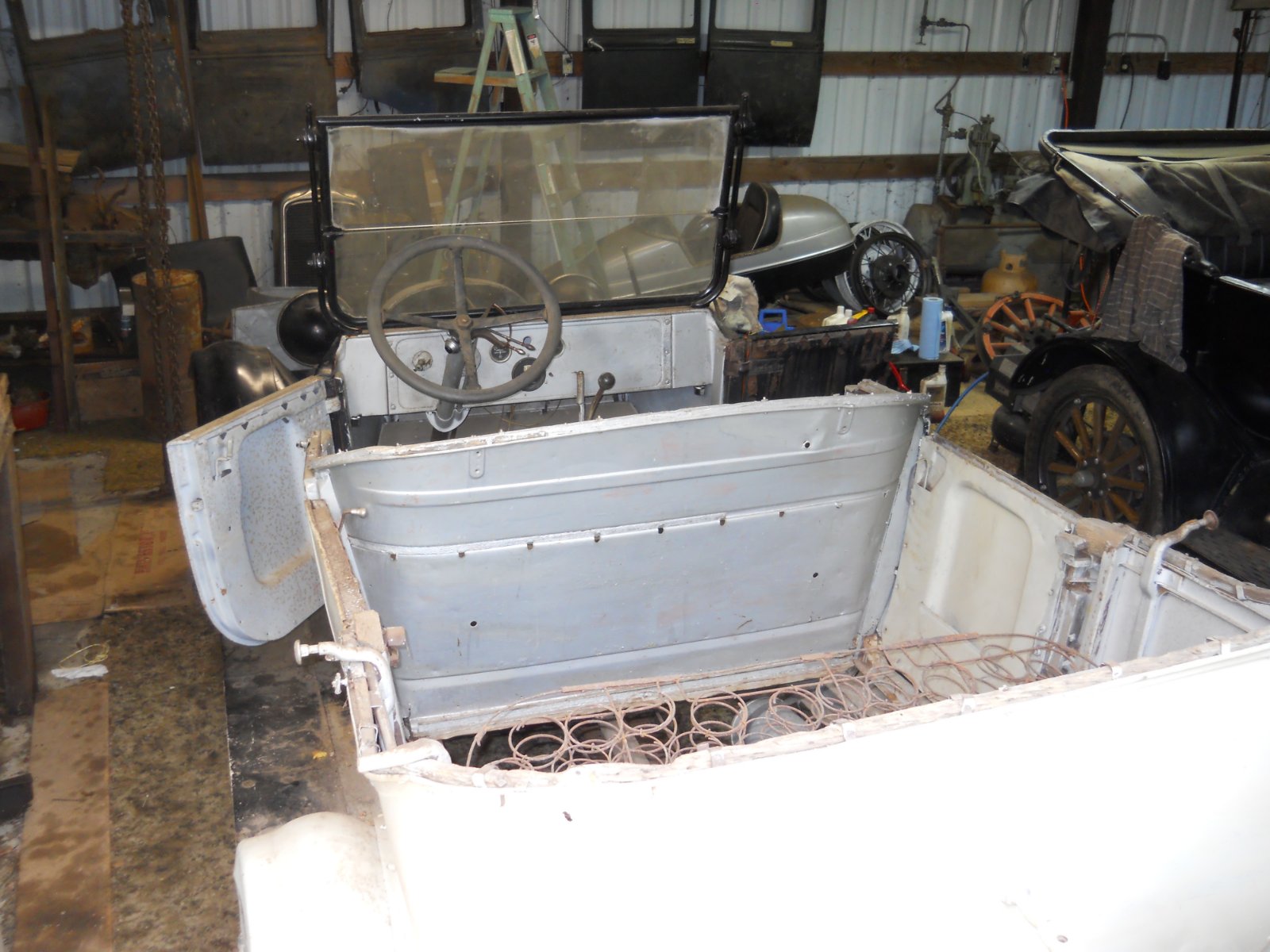

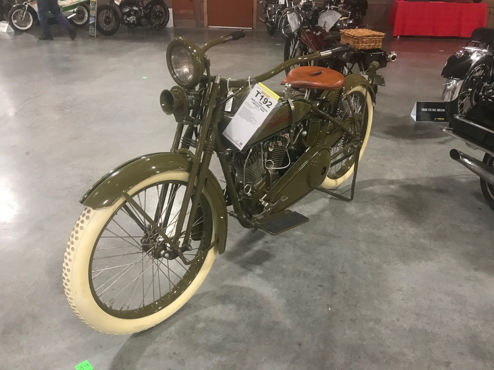

I love you guys sharing your projects , keep updating please. Rich, I went to an auction here in town and was thinking of you and your bike.

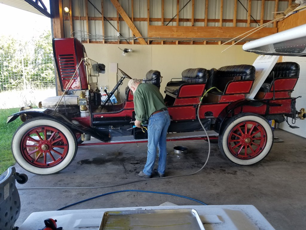

That is a great looking '20. I wish mine were that far along. It also reminds me of our show last Summer. That is what I should be doing today.
Thanks for sharing those.

May not be Poetry, but it’s (finally) in Motion.
Now to take it all back apart, and prep for paint.

Oh Yes! It is Poetry too!
That is Great!

Very nice Paul !! Can’t wait to see it painted.

Good news on the Dodge Mark! I like it!
Rich, thanks for posting about the V-8 Fords.
When I was young I thought they were dumb...until I was at a showgrounds and watched an old fire truck pumping water for tractors or engines or something. DING! That's cool and smooth!
The '45 school bus come dump truck way back sure ran nice when I had it out.
I whole-heartedly agree this OT forum being a plus!
Some people only T and that's great, yet plenty of us are multi-faceted in our interests. Or else have ADD...
I think I'm a little Autistic maself.
I have looked at things from this T bunch I never would have dreamed...
Thank you.
I just text my Twin City tractor dealer/friend that I have more enjoyment ahead of me than I can shake a stick at.
I need to get the 18 PsychOdelic Runabout home. What a year!
Busy under-grounders doing our thing at home!

After I got the information on where the engine number was (the guy that posted the info is from Australia and was posted between 11 and 12 our time) on one of the 3 spare engines I got with the car (along with a bunch of other parts) I was out in the ship at midnight looking for it. Found out it's Dec 1916 engine. Normally it's over the water inlet (wonder where they got that from?
), but the early engines was in a different location. Dodge used 3 point suspension for the engines, the front point being a ball shape that slides into the snout of the timing cover and pan and rides in a carrier on the front cross member.
The rear somewhat like the Model A. The engine less the bell housing and transmission are a big chunk of iron.
Now that’s nice.
If my short term memory gets any shorter, I won’t even have thought about what I’m going to forget.
17 TT Holmes Wrecker
22 Mack AC Tiltbed Wkr
30 A Rdstr PU
58 Mack B-61 Semi Tractor
30 A Rdstr PU
- Posts: 2832
- First Name: Dallas
- Last Name: Landers
- Location: N.E. Indiana
How cool is that! Its come a long way! Great job on bringing back Mack!
- Posts: 1556
- First Name: Duane
- Last Name: Cooley
- Location: central MN
Woohoo! Been waiting for an update Paul.

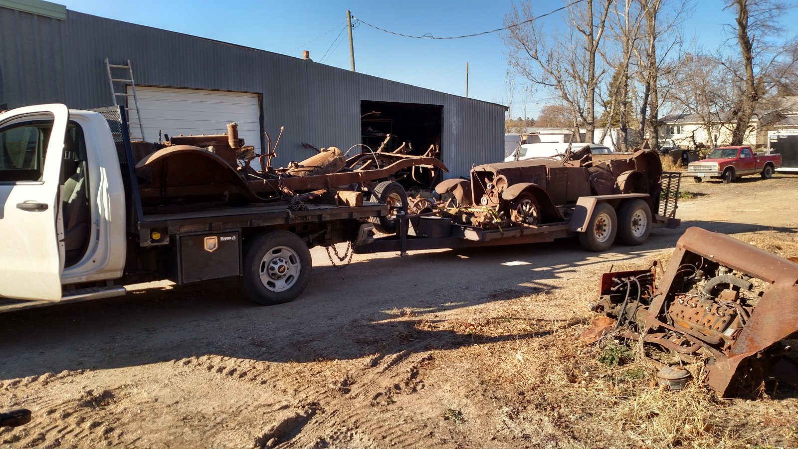

As found in the wild! 2016
Not really found but allowed to purchase. A pair of 1920 Cleveland six model forties. Both engines were rotted through the oil pans in the dirt. two more parts engines from 2 other states and four years and
I have a heartbeat! Overhead valve in 1920 wasn't that common.

How lucky are you? That is a great car. Have fun with it.
I hope to hear some more about it as time goes by.

Was the wire wheel in the foreground part of your haul? Are the other 3 hubs and wheel centers on the chassis? Acquiring a full set of hubs and wheel centers is 90% of the effort when it comes to converting a car to wire wheels. The rims are almost always toast, and don’t plan on using the spokes for anything more than patterns. If you have the hubs and centers, a set of wheels can be completed with ease

Funny! When I loaded this picture l actually thought of you because of the wheel in it! I'm pretty sure sure they survived. The owner is noKevin Pharis wrote: ↑Sun Jul 26, 2020 9:56 pmWas the wire wheel in the foreground part of your haul? Are the other 3 hubs and wheel centers on the chassis? Acquiring a full set of hubs and wheel centers is 90% of the effort when it comes to converting a car to wire wheels. The rims are almost always toast, and don’t plan on using the spokes for anything more than patterns. If you have the hubs and centers, a set of wheels can be completed with ease
Stranger to the site. He may chime in.

Looks like a Houk #5 wheel center and hub... the wheel center is not all that uncommon and of no particular value by itself, and an unidentified application hub has about equal value.
But if you have a car that you desired to convert to wire wheels... it is near unheard of to find a complete set of wheels and hubs that would directly mount to your specific application. So if that is a Cleveland chassis... you should keep an eye on it

My non Ford vehicle project was a bicycle. A friend gave me a 1950's J C Higgins sears bike to play with. I rebuilt it into a fun look alike toy I have always wanted but out of my league. Les

Re: Exhaust manifolds burning out with that "alligator hide" look: I I used to see some of that on fairly clean vehicles. I assumed it was caused by lean burn emissions settings and AIR injection reactors. I think that may be a factor, but I notice some people had similar failures with earlier vehicles which did not have the emissions equipment, but had restricted exhaust problems that led to burned out manifolds. I recall that around that era, late 60s/early '70s, some Chevrolet vehicles, and probably other GM, had a double layered exhaust header pipe from the manifold(s) to the muffler or Y junction. In some cases, the inner pipe layer would erode or corrode and somehow get wadded up inside the outer layer of the pipe causing severe restriction in a pipe that looked perfectly good on the outside. That could explain some of the burned out manifold issues.

Dividing time between the Mountain Wagon and the Stanley sedan, but getting the engine back in the Mountain Wagon is getting to be a real priority

Dan - how about a little education on that engine ? Is that first pic 2 - 2 cylinder engines, with external cranks ?

Stanley steam enmgines....

He has two Stanley steam cars? He does!

Hi, Paul -
The photo with the little rusty engine was staged by a friend; he placed his little 10 hp Stanley engine on the big 30 hp engine - we named them "Baby Bear" and "Papa Bear". The 30 hp engine was briefly passing through his garage in Pennsylvania on its way to the west coast and he wanted to take the opportunity to compare the two size extremes. The 20 hp size is, not surprisingly, half way between those two sizes. The big engine really is a moose. In my younger days I could lift a 20 hp engine, there's no way I can lift this 30.

Thanks Dan. Was wondering if your Wagon used some sort of an APU for something.
When you get it running, would be interested in seeing a video of the engine starting and running.
Good luck.

The main APU is the pump handle that sticks out of the floor between the driver and front seat passenger! Until the car is rolling there is nothing to drive the pumps, so hand pumps are provided. It looks like a gearshift lever and is often mistaken for one. The forward stroke on the pump handle pumps fuel, the backward stroke pumps water. Either of the pumps can be cut out of the circuit, so you don't pump unwanted water while pumping fuel or vice-versa.
Once steam is up and the car starts moving, the power pumps are driven by the crosshead. Every back stroke of the crosshead will pump water and fuel, every forward stroke pumps water and cylinder oil. And again, if the boiler doesn't need water, the pumps do not stop, the water they pump is diverted back to the water tanks. Same with fuel, if fuel pressure is up to 140 psi, the fuel pump can't stop, but the surplus liquid fuel is diverted back to the fuel tank.
The power pumps on a non-condensing Stanley work at engine speed, the power pumps on a condensing car are much larger and run off the rear axle (instead of the engine crosshead) and they are geared to run at 1/4 engine speed. Condensing car pumps are way too big to run off the engine and non-condensing pumps are too small to provide the needed volume to feed the boiler if they were run at slow speed off the rear axle.
The later (1915 and later) condensing car pumps are very quiet and smooth, the earlier pumps slap and clatter at speed.

I know it's not much, but this is the sight when the car is steaming up. I don't have video I can post of it running.

playing with the pilot light, turned low and turned high

Dan - thanks for that. Way cool !
Don’t know that I fully understand your description, but understand your process building up steam.
That is a neat machine. Great that you’re keeping it operational !
