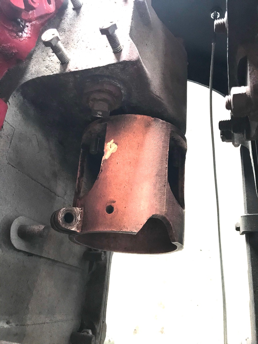

Doing some cleanup this week.
Hopefully moving into the cleaner assembly stage.
Before : After: Now that’s a piece of art :

Art? It sure is! That drive is gorgeous Paul and those sprockets look great! What color? No wait, show us when painted.

It will be modeled after our other Wrecker with similar accents, but I’ll have to change the color from ‘Coal Black’
- to gloss ‘Black’ in accordance with the model year !
Engine cylinders, squirrel cage, wheel hubs, sprockets (and possibly chains ?), as well as winches/cable pulleys (safety) will be accented as our TT.
All aluminum (block, pan, and transmission) and brass/copper will remain exposed (possibly clear coated to prevent oxidation).
A lot of work yet before that happens.

I wanted to clean up a spare generator for the '35. It was reluctant to come apart. After soaking it with penetrating oil and then soaking it in water it was still stuck. I thought maybe a gentle nudge in the press might push the armature through the case. I used some steel and a socket for spacers and put some pressure on. With no results I finally put all 12 tons to it. Still no movement. I added a little pressure each day and finally used a longer jack handle. I expected a BANG! if it ever let loose, but didn't expect the armature shaft to penetrate the 1/8" steel into the socket.
I thought some of you might enjoy this as it isn't that common at my shop.
At this point the armature was showing some movement and did come out of it's shell. My next task is to remove the punctured plate from the shaft. The parts may clean up and work. Or not.I thought some of you might enjoy this as it isn't that common at my shop.

That was really stuck!

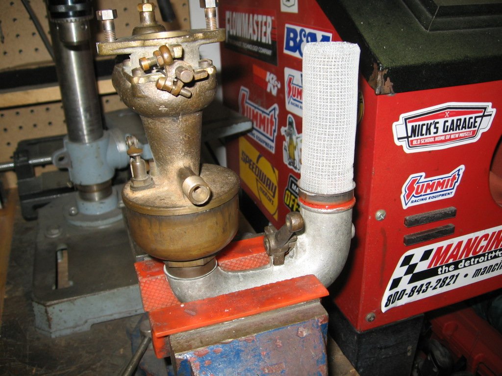

My Cleveland got it's original carb reinstalled. Some sketchy guy in Montana who will go unnamed rebuilt it.

The guy in Montana knows a heck of a lot more about carburetors than I do.

How do you keep the carb clean after polishing it ?

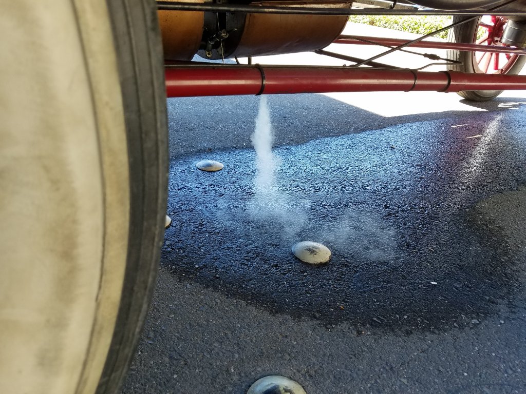

Dividing time between the Mountain Wagon and the Stanley sedan, but getting the engine back in the Mountain Wagon is getting to be a real priority

Dan - how about a little education on that engine ? Is that first pic 2 - 2 cylinder engines, with external cranks ?

Stanley steam enmgines....

He has two Stanley steam cars? He does!

Hi, Paul -
The photo with the little rusty engine was staged by a friend; he placed his little 10 hp Stanley engine on the big 30 hp engine - we named them "Baby Bear" and "Papa Bear". The 30 hp engine was briefly passing through his garage in Pennsylvania on its way to the west coast and he wanted to take the opportunity to compare the two size extremes. The 20 hp size is, not surprisingly, half way between those two sizes. The big engine really is a moose. In my younger days I could lift a 20 hp engine, there's no way I can lift this 30.

Thanks Dan. Was wondering if your Wagon used some sort of an APU for something.
When you get it running, would be interested in seeing a video of the engine starting and running.
Good luck.

I know it's not much, but this is the sight when the car is steaming up. I don't have video I can post of it running.

A friend came over yesterday, our intention was to add gas, fix any fuel line leaks, and then try to start my 1912 Flanders 20 for the first time since I bought it. We didn't get very far - there are no leaks in the fuel line, but the OEM Flanders carb floods horribly. We took the carb apart to check the float action and level. The OEM cork float and needle appeared to move freely and the needle seals well against its seat (at least when doing the sucking on the fuel inlet test). We lowered the float level as far as we could while still allowing enough float travel to let the needle lift off the seat and reassembled the carb - no improvement. When I tried pushing on the float "tickler", it didn't feel like there was any resistance - the float wasn't pushing up against the tickler plunger when there was fuel in the bowl.
My current theory is that the float is rubbing/jamming against the inside of the float bowl, preventing it from rising and pushing the needle onto its seat. I'm going to disassemble the carb again and try to simulate the presence of the float bowl with some flexible plastic so that I can see if the float is getting jammed up when the float bowl is on. If it is, I'll sand the OD of the float down for clearance, then re-seal it with hot fuel-proof dope.
