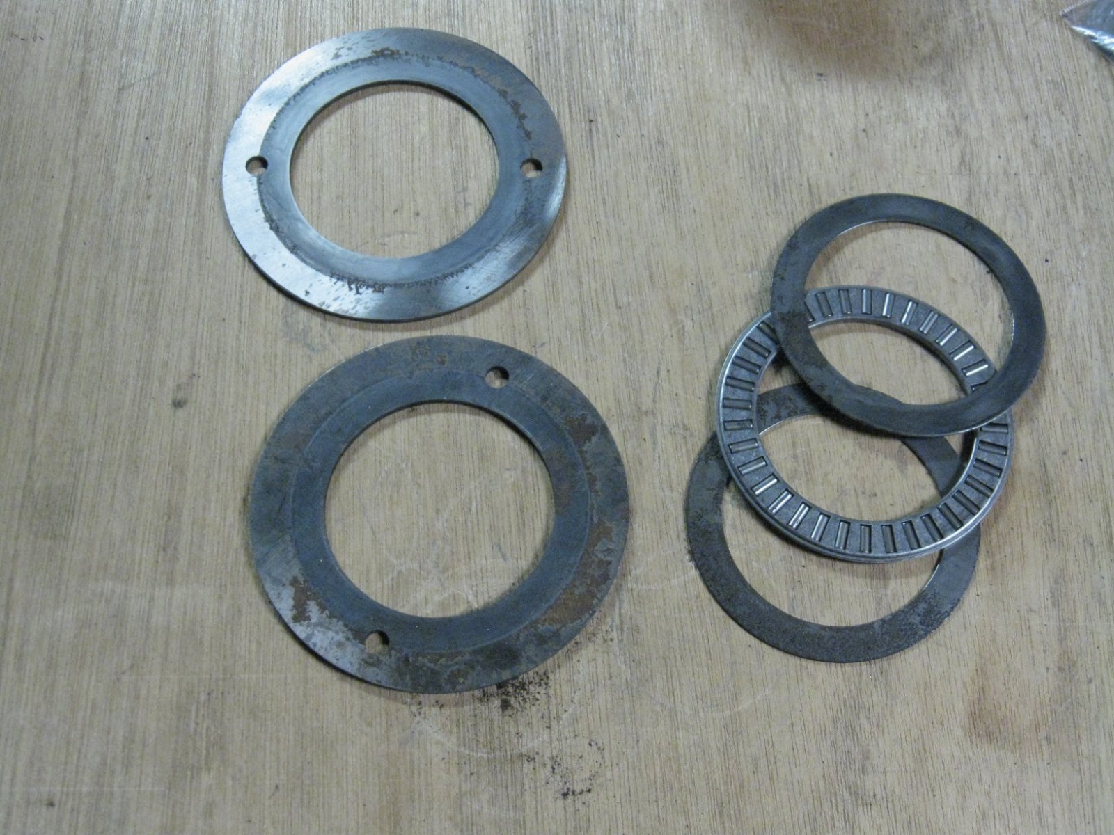

Your T to experiment with non-stock parts, try 'em. My experience was poor, after take down of rear end to rebuild as a Ruckstell.
The tiny round needles in that bearing were flattened on some, and some were displaced and were stuck and couldn't rotate. My guess is the thrust or load on these little guys was too much, as the outer diameter of these is 1/2 that of the normal bronze thrust. Plus you have to rely on these providing the ring and pinion gear clearance, but you can't shave them down like the big round and fat bronze thrust washers, which help when rebuilding today with good used parts in your axle. IMO, Ford way is the simple and better.
IMG_7860 (500x375).jpg (103.26 KiB) Viewed 7612 times

The needles or rollers in those bearings would have to be tapered to rotate correctly. The straight ones, like the ones you buy today, will have to do some skidding as the assembly rotates. That's what wears them flat. The straight ones seem to me to be a poor design.

The most recent rear axle rebuild that I had done had the replacement thrust bearings in it. The left side bearing was fine, but the right side had issues:
There was a significant amount of rust on the steel thrust plates, the bearing races, the cage and the rollers, but only on the right side. Also the rollers had flat spots on them where they were sliding instead of rolling. The pitting on the races and the rollers was pretty bad especially considering that they were swimming in gear lube (no water or moisture in the rear axle). The same issues were discussed in an earlier thread from the old forum:
http://www.mtfca.com/discus/messages/41 ... 1420001041
New brass/bronze thrust washers were installed during the rebuild.
