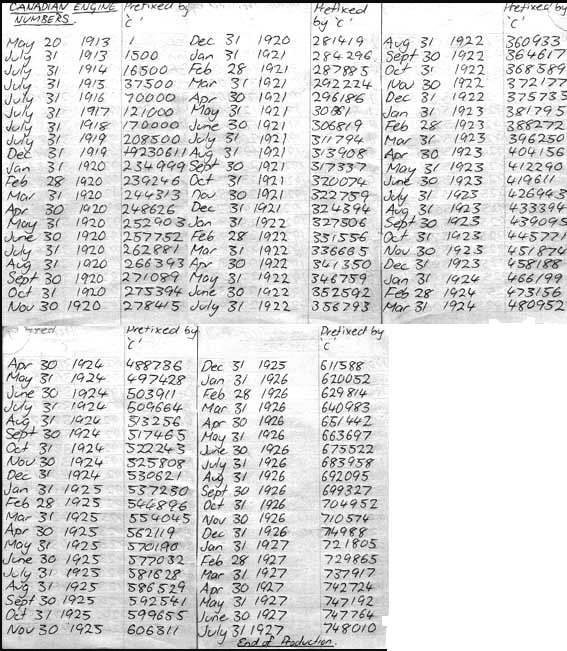

This 27 Roadster I have now has a Canadian registration number. Is there a data base to find info on the Canadian cars? Thanks

Here is a chart that was placed on the Forum a few years ago with Canadian engine number sequence.
and total car/truck production
