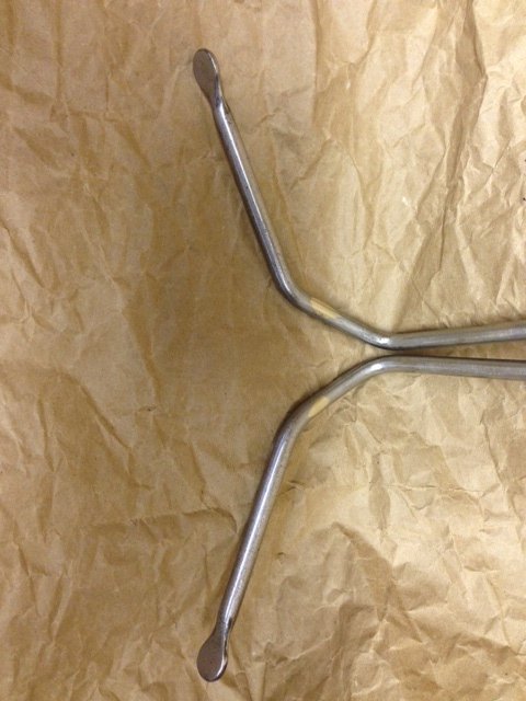

Hello all,
How on earth do I get the old levers off the steering gear case and still be able to put the new ones back on?
Thanks in advance.
R/ Roger.

Heat the tabs on the steering gear box. Let the tabs cool then pry the tabs just enough to get the spark or throttle rods out. To install heat the tabs and again let them cool. Replace the rods and gently tap the tabs closed over the rods. Brass will break or crack if you try to pry or tap the tabs when they are hot. I've done this several times with much success.

Just did that task 2 weeks ago. Thought that propane would heat enough, nope. needed to get red with the acetylene torch.
This case prior to nickel plating, had the rods removed by cutting them off and sliding thru the tabs. So the tabs were closed like factory fitted, and plated over.
To open the tabs back up, heated each one to just dull red, and gently pried them apart just enough to so the new rod would fit.
If you look close you can see the discolored nickel where the heat was applied to the tabs. Just softly hammered close with the ball pein.
In goes the fresh nickel plated case with new s.s. rods ...... ;)

Copy all: Heat, cool, pry. Heat, cool, crimp.
