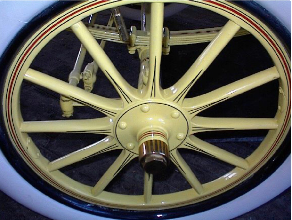

I know some people think Henry only made black wheels. I believe they started offering varnished spokes in May1925. That’s millions of cars that could have had varnish from new.

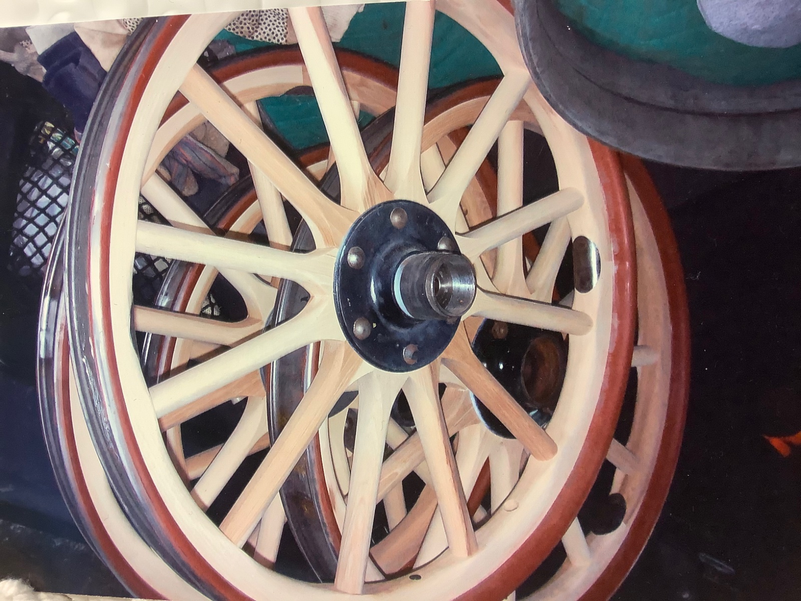

If I were going to paint a set when done, I would do things differently. At the very least, good primer and paint where the wood is going to attach. I don’t think I’d send finish painted parts off to him, nor complete powder coated stuff unless demountable rim wheels for a driver quality car.. That’s just me. Powder coat is so much more durable than paint, but still leaves lots of chance at damage. Seems like wasted work as you would just need to paint the spokes , why not paint all at once when respoked. At least you would have some corrosion protection between the new wood and metal.
This picture shows how I got a set back that is getting a real nice paint job. There is good epoxy primer under all the wood to metal parts. I’ll do a nice prep job like Walter described above, get some finish primer and paint paint inside the clincher rim, install the tubes, tires, inflate the tires, deflate the tires and then prep for final paint. Mask the tires , paint. Shown is the set of wheels, all ready for that show quality process to start.
Dropacent
Posts: 3384
Last Name: Morsher
Location: Norwalk Ohio
Re: What is procedure for Stutzman?
Post by Dropacent » Wed Aug 26, 2020 4:28 pm
IF you send him powder coated parts, as I described above, this is what you will get back.as you can see, the metal isn’t perfect, but is powder coated for a good driver quality wheel, that will last many lifetimes now. Henry’s wheels weren’t meant to last many lifetimes. If you send him rustygreasycruddybare metal parts, that is what you I’ll get back. I guess it’s up to you how nice a job you want. As we know, people can be penny wise and pound foolish. They do baby buggies to 12’ wagon wheels, they really don’t care. ( also penny farthing humongous bicycle rims, finger jointed steering wheels, etc)

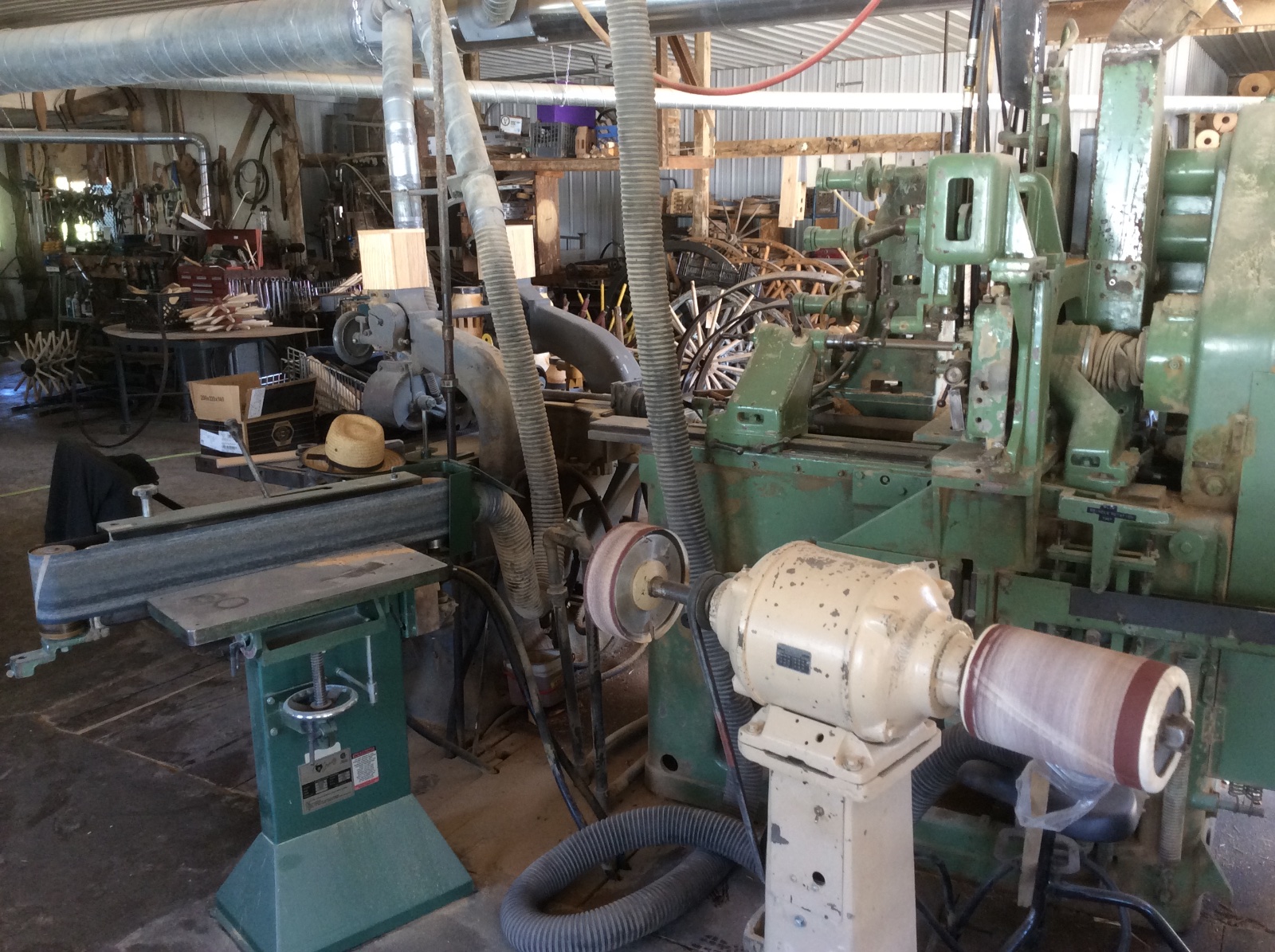

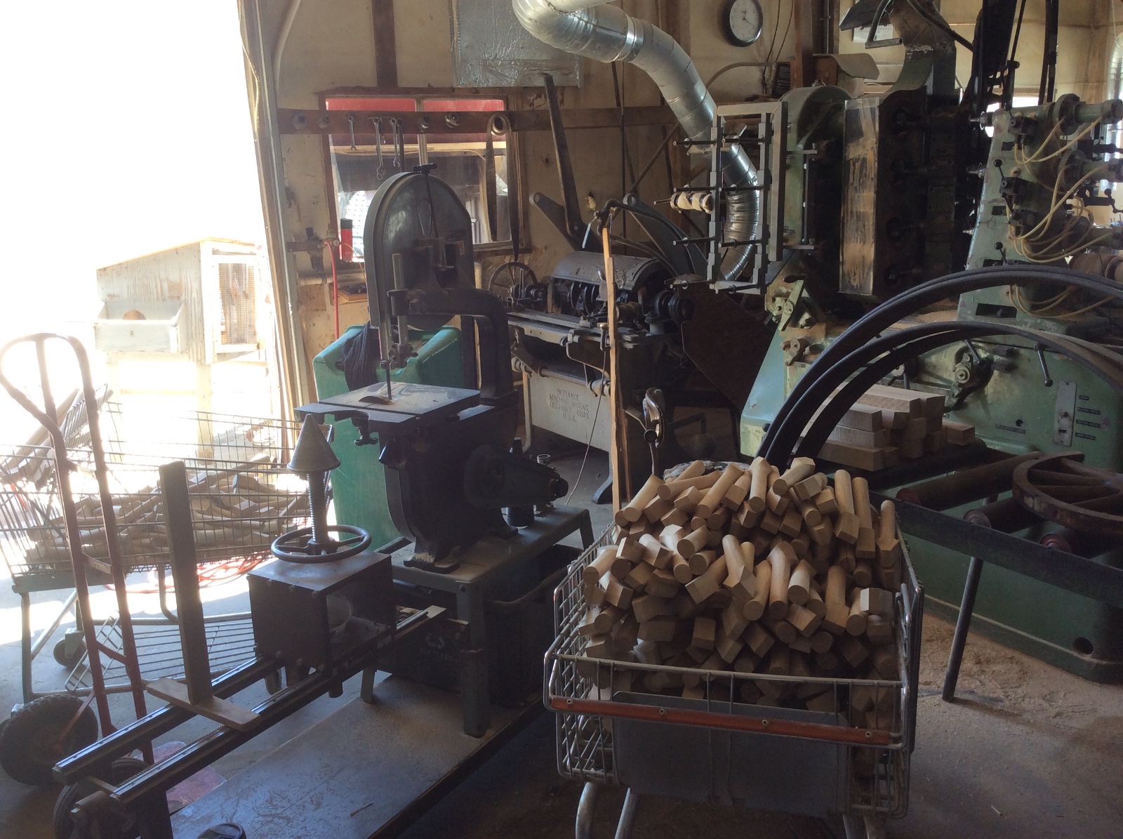

I've been to his place a couple of times and in Noah's office is an impressive assortment of stuff. His exact words to me, "If it is round and made of wood, we will make it". For the early bicycle crowd he has even made wooden bicycle rims with an aluminum extrusion hidden inside such that when it is assembled you cannot see it. I'm not a bicycle person but it looked pretty slick to me.

Since the thread is reference to Stutzman wheel shop in Baltic, Ohio , thought I’d share these pics. I’d guess any good wheel shop would be similar, but I don’t know. Need to mention, I’m not a shill for them, don’t intend to speak for them in any way. Just a happy customer after at least a half dozen jobs over 15-20 years, with many friends with the same result. Good craftsman in any field are getting harder and harder to find, and I celebrate the good ones I come across, and just mumble to myself of the clinkers I too often get. PLEASE NOTE the sets of T wheels, in sets as they were sent in to them, in process. They are Amish, so I respected that and had permission to take these pictures while they were having their lunch break. Many use phones and computers, but powered by a generator, or solar panels. For religious reasons, some Amish do not allow their pictures taken , and I respect that. I’m the same way , but it’s because of the FBI most wanted list.

Dropacent
Posts: 3384
Last Name: Morsher
Post by Dropacent » Thu Aug 27, 2020 12:08 pm
Dropacent
Posts: 3384
Last Name: Morsher
Post by Dropacent » Thu Aug 27, 2020 12:12 pm
Their relations own and operate huge sawmills in the area, but they have capabilities right on site, also. The area is fascinating, small family owned factories all over the farmland area. Cheese, chocolate, meat, wood wheels, what could be better?

Post by Steve Jelf » Mon Aug 31, 2020 10:53 am
Coincidentally it was five years ago today that I sent Noah a check for $670.50. That was for three wheels and shipping, so they were $223.50 each with shipping. I was and am very pleased with them. Well worth the dough.
I was quite disappointed when he quit selling spokes individually. It makes pressing my own demountable wheels more expensive.
After thinking about Tim's comments, I believe I will change my procedure if I ever have wood-felloe wheels made again. I'll prime the metal parts again, just as I did, but I'll use a black primer.

Post by Burger in Spokane » Thu Sep 10, 2020 11:34 am
As delivered:

Post by Burger in Spokane » Thu Sep 10, 2020 11:36 am
A photo of the stained and installed wheels. I will give them more color from time
to time to get them good and black. Hickory is slow to take color and will take many
applications. No peeling paint for me.
