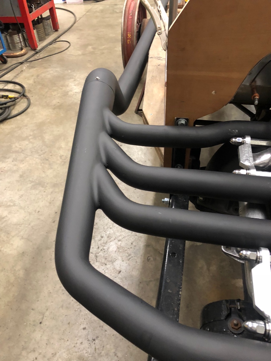

Posts: 5605
First Name: Henry
Last Name: Lee
Location: South Pittsburg, TN
Re: Building Speedster Header from Scratch
Post by Henry K. Lee » Fri Feb 22, 2019 8:19 pm
Building continues with some added safety features, ie, heat shield for the passenger. Made from a semi truck stack guard.
Started the carving of the welds using a carbide bit with canning paraffin, keeps the bit from chattering and keeps heat down. Keeps them sharp longer too

Posts: 5605

Posts: 5605
First Name: Henry
Last Name: Lee
Post by Henry K. Lee » Sat Mar 02, 2019 6:54 pm
Patiences and time pays off for sure. These are all made from 11 gauge pipe with the welds carefully ground and sanded all the way down to 180 grit.

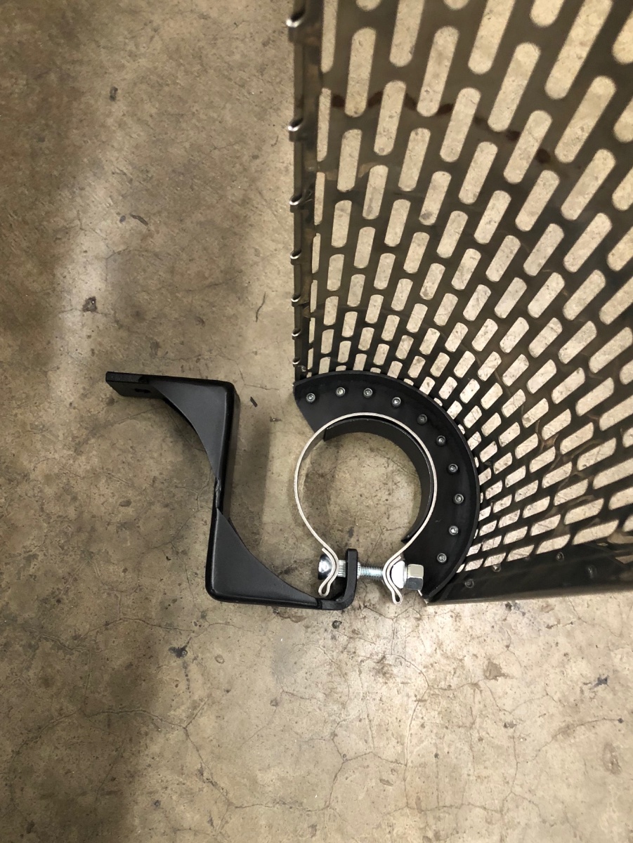

Posts: 5605
First Name: Henry
Last Name: Lee
Post by Henry K. Lee » Sat Mar 02, 2019 7:03 pm
More pictures of the completed carbon choke and mounting for the main pipe. Using an old method, with a 3 in 1 clamp, ie, clamps the guard, holds the pipe, and the mounting bracket to the body. This is a bonus system as it allows the frame to flex with no fatigue transfer to to pipe system.
The header mounting bolts are also made to be in a staging assembly, ie, installing the exhaust first, then attach the intake with the pinch clamps. Keeps from looking like an octopus.

Posts: 5605
First Name: Henry
Last Name: Lee
Post by Henry K. Lee » Sat Mar 02, 2019 7:25 pm
Thank you Scott, But I just fake you out Sir. It has chokes inside of the pipes for that purpose. he can remove them if he wants to up the Annie with a larger cam. I knew someone of your caliber would catch me! LOL!
Hank
Posts: 5605
First Name: Henry
Last Name: Lee
Post by Henry K. Lee » Sat Mar 02, 2019 7:46 pm
Scott, the heavy wall does not put out as much heat as that thin wall does, but yes burns will happen. Dave can have them ceramic coated after they season themselves as this really keeps them running cooler. I did install removable exhaust chokes for controlled back pressure with a moderate cam. Have found this controls head temp better and idle.

Posts: 5605
First Name: Henry
Last Name: Lee
Post by Henry K. Lee » Sun Mar 03, 2019 2:11 pm
More detailed photos showing the 3 in 1 clamp system. Also the steps and mounting.
