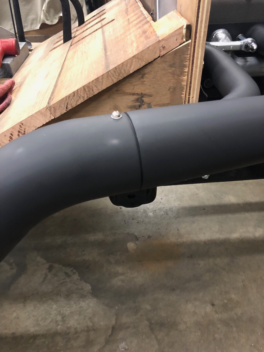

Progress report, Finished up the carbon choke (these prevent exhaust leaks at the megaphone plus easy removal).
Fabricated the rear exhaust cut out with a side dump such as the style used on Indian Motorcycles of the era

Hank, can you sketch out the carbon choke. Is it just a ring of some sort? Sounds like some good engineering. Thanks.
Topic author - Posts: 5509
- First Name: Henry
- Last Name: Lee
Re: Building Speedster Header from Scratch
John it is pretty simple, the inside pipe reduces down by about an 1/8" towards the rear. this keeps the carbon in a slight restriction/back pressure before the seam. With the next connection going over it, you only need two sheet metal screws to hold it. I normally give a light coating of red RTV at the seam to prevent corrosion. Makes for a nice flex point since the Model T's frame has flex to it. You can may find some heavy wall pipe that will slide inside the piece you are working and pen the edge over slowly. I have a power roller which does my shrinking for me. Another method is to purchase various adapters with the edge as needed, cutting to your liking.
- First Name: Henry
- Last Name: Lee
More pictures of the completed carbon choke and mounting for the main pipe. Using an old method, with a 3 in 1 clamp, ie, clamps the guard, holds the pipe, and the mounting bracket to the body. This is a bonus system as it allows the frame to flex with no fatigue transfer to to pipe system.
The header mounting bolts are also made to be in a staging assembly, ie, installing the exhaust first, then attach the intake with the pinch clamps. Keeps from looking like an octopus.

More detailed photos showing the 3 in 1 clamp system. Also the steps and mounting.
