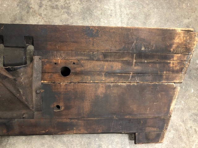

I don't know if they are made from crates, but the original appearing floorboards in my 1925 coupe certainly look like they are made from scrap. The upper boards consist of eight pieces dovetailed together, one id even tapered from about 3/4" to a little over 1" over its length. The side edges are dadoed or grooved and boards are inserted to stiffen the floorboard.
