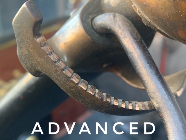

The advance lever, though the commuter rod, has to send the timer through a certain range of motion in order to generate a spark in the cylinder at a certain amount of degrees before or after TDC. I would believe this range begins with the advance lever fully retarded which should translate to 15 degrees after TDC. I have set that end of the range by following guidelines on this forum.
The other end of the range, at which the advanced lever is set to its most advanced setting on the quadrant should translate to a certain amount of degrees before top dead center which I don’t know. Figured it was equal to or great than 45 degrees.
So that’s question 1... how many degrees before TDC should a timer generate a spark when the advance lever is full advanced on the quadrant?
As I was working on the T today, I noticed my advance lever wouldn’t stay full advanced... it can be taken down the quadrant to that position but then it rebounds some. I looked at the end of my steering column and noticed it is because my commuter rod, when fully advanced, makes contact with the steering column then rebounds back a little when I let go of the advanced lever.
This made me think that I may not have an appropriate full range of motion of my timer, thus diminishing the performance of the engine.
So, question 2. Is there a table or guidelines to show what physical range of motion of the timer is sufficient to ensure the full range of timing which should be available to the engine? I measured mine today with masking tape on the engine and on the timer, making a mark at the beginning and end of that range. It was just over a half an inch.
I have attached pics of my commuter rod’s position at the extremes of the advanced rods positioning on the quadrant. If you look at the commuter rod in the retarded position... it appears it has more travel range possible as the physical connector could lean/travel more toward the steering column. If I took advantage of that range, then I could gain the unused range on the quadrant when the commuter rod is more advanced but butts against an obstruction then rebounds.
So question 3, how can I get that connector to sweep more toward the steering column when set in the retarded position? It seems that connector is held onto the rod passing though the steering column, and up to the advance lever, with a screw passing through the middle of the rod. So it seems like the connector cannot simply be made to rotate since the screw is holding it in a fix position.
I apologize for the lengthy post, this is something which would be more efficiently handled in a Model T club meeting. But we don’t have those right now.
Thank you for those who made it though this post. I’m still in a steep learning curve and hope this post didn’t sound too ignorant.

Darin, The fully retarded spark lever should correspond to spark at or just past TDC. 15 deg is way too much. To answer your question #1, there is no corresponding degrees of advance for a fully advanced spark lever, it is the limits of the arms and spark rod. If you have the fully retarded position set to 15 deg past TDC then you have reduced the fully advanced position by about 15 deg. The only adjustment to make is to set for the fully retarded position. I remove the #1 spark plug and insert a long wire into the spark plug hole, crank the engine over and look for the wire to indicate just past TDC, then I rotate the timer to get a spark at the fully retarded lever position. For question #3, there is no way to adjust the position of the arm on the spark lever shaft short of bending the spark lever, the arm is pinned to the rod and is not intended to be adjusted. All adjustments are made by bending the rod that goes from the spark lever arm to the timer, and that adjustment is for the fully retarded position, not the fully advanced position. If your rod is binding on the steering shaft you can bend the rod to clear the interference and you will probably need to bend it elsewhere to set fully retarded/TDC.

I agree with Humble. I would add a couple things. One would be excessive play in the linkage which would allow you to move the lever up or down without moving the timer. Try to get all the slack out. You might need to put a shim around the rod where it goes through the hole in the timer, and/or install a very thin washer. The other thing would depend on whether you are running on magneto and coils or on battery. When you run on battery, the spark will advance continually as you move the lever down. Whereas if you are running on magneto, you will find at least 3, sometimes 4 spark positions where your spark will advance and in between those positions, it will remain the same. Only if the coils are not set the same for each coil, you might find one or two coils more advanced than the others if you run right on the edge of one of those positions. When you drive the car, try to find the best position for the speed of the car. The faster the engine is running, the more advanced the spark should be set.

What I am seeing is; the rod has been rebent and maybe not enough bend now to clear the steering shaft;

The reason I referenced setting 15 degrees after TDC was from reading on this forum and articles written on the T ignition system. I didn’t know if this was a Ford recommendation or simply a rule of thumb.
Jeff and Norman - Thank you for mentioning commuter rod slop and bending issues. I do have slop in it as the spark lever has to be moved a certain distance before it will actually move the timer. This slop is taking away from my T’s ability to advance the spark properly. After looking at the Lang’s catalog I believe I may not have the right commuter rod setup as I don’t have a swivel joint end... the rod is simply one solid piece of metal. Also, the spark rod lever has been previously repaired in a way which got the job done but adds to the slop. So, I’ve ordered a new commuter rod setup including spark rod lever and pin.
Art - I’ll be curious to hear your results.
Mark - I’ll see if this new setup clears the steering column. If not, I’ve noted the commuter rod would simply have to be bent due to the pinned lever.
Oh and due to a severely underperforming mag, I do run off a battery when driving the T.

The photos above show the incorrect lever on the spark rod from the steering column. Where is the swivel, and the correct commutator rod?

Darn it Larry, you took the words right outa my keyboard!!

Larry and Tim - 100% agree. I didn’t even pay attention to the commuter rod until this issue. I’ve already ordered the correct rod and swivel from Lang’s and it should be here soon.
