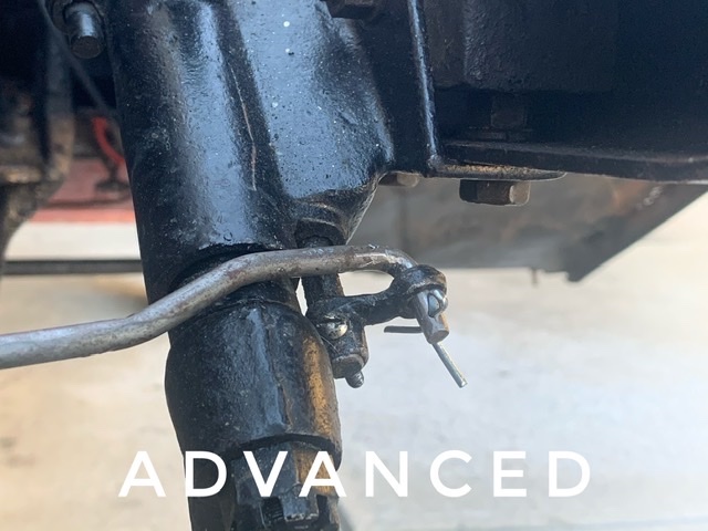

As I was working on the T today, I noticed my advance lever wouldn’t stay full advanced... it can be taken down the quadrant to that position but then it rebounds some. I looked at the end of my steering column and noticed it is because my commuter rod, when fully advanced, makes contact with the steering column then rebounds back a little when I let go of the advanced lever.
This made me think that I may not have an appropriate full range of motion of my timer, thus diminishing the performance of the engine.
So, question 2. Is there a table or guidelines to show what physical range of motion of the timer is sufficient to ensure the full range of timing which should be available to the engine? I measured mine today with masking tape on the engine and on the timer, making a mark at the beginning and end of that range. It was just over a half an inch.
I have attached pics of my commuter rod’s position at the extremes of the advanced rods positioning on the quadrant. If you look at the commuter rod in the retarded position... it appears it has more travel range possible as the physical connector could lean/travel more toward the steering column. If I took advantage of that range, then I could gain the unused range on the quadrant when the commuter rod is more advanced but butts against an obstruction then rebounds.
So question 3, how can I get that connector to sweep more toward the steering column when set in the retarded position? It seems that connector is held onto the rod passing though the steering column, and up to the advance lever, with a screw passing through the middle of the rod. So it seems like the connector cannot simply be made to rotate since the screw is holding it in a fix position.

What I am seeing is; the rod has been rebent and maybe not enough bend now to clear the steering shaft;

Jeff and Norman - Thank you for mentioning commuter rod slop and bending issues. I do have slop in it as the spark lever has to be moved a certain distance before it will actually move the timer. This slop is taking away from my T’s ability to advance the spark properly. After looking at the Lang’s catalog I believe I may not have the right commuter rod setup as I don’t have a swivel joint end... the rod is simply one solid piece of metal. Also, the spark rod lever has been previously repaired in a way which got the job done but adds to the slop. So, I’ve ordered a new commuter rod setup including spark rod lever and pin.
Art - I’ll be curious to hear your results.
Mark - I’ll see if this new setup clears the steering column. If not, I’ve noted the commuter rod would simply have to be bent due to the pinned lever.

The photos above show the incorrect lever on the spark rod from the steering column. Where is the swivel, and the correct commutator rod?

Larry and Tim - 100% agree. I didn’t even pay attention to the commuter rod until this issue. I’ve already ordered the correct rod and swivel from Lang’s and it should be here soon.
