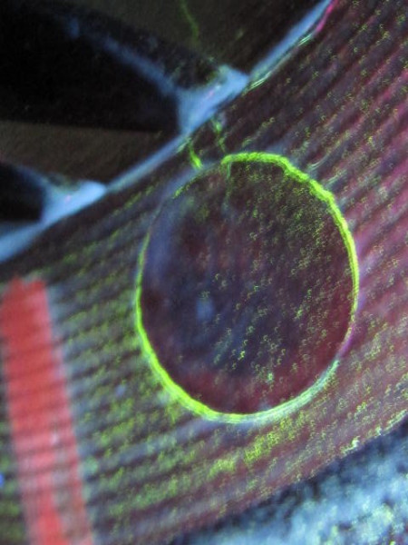

All I can say is be careful. If you are spending the time to pull the engine and do the work have the drums magnafluxed. J&M Machine did mine and found cracks that I never would have been able to see. So could you use your drums? Sure they would work. However, it could be a grande waiting to explode. If it does you could destroy a lot more of the trans and motor. So you just have to ask yourself how much excerptible risk are you wanting to take. Good luck with your project.

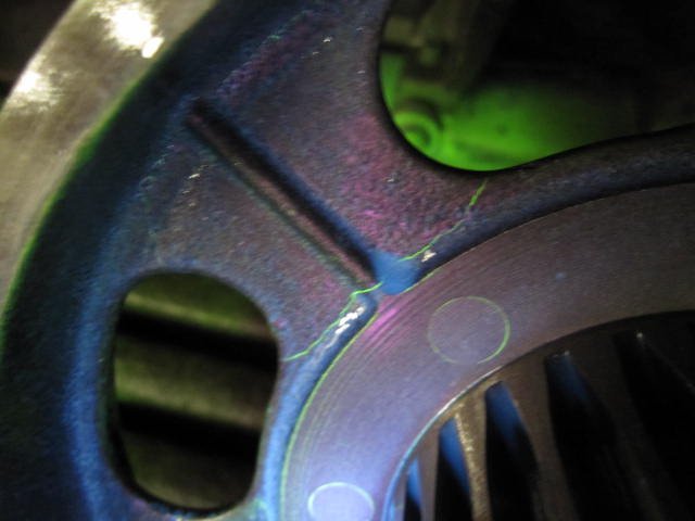

The Dye isn't as effective as the true magnetic inspection machine. I've shown a typical examples.
We are the manufacturers of the drums and gears that Snyder's sells. Our drums and gears are made to exact Ford blueprint in shape and form.
Yes they are more expensive as it is being sold as a unit not just the drum. it is all brand new. We just sold a complete set of drums to Bavaria.

There are cracks to be avoided and cracks of little consequence. The J & M photos show both. The cracked web in the drum makes that drum a throw away. The small one around the rivet is of little consequence. It goes to the inside of the drum hub, and was most likely created in the riveting process when the gear was installed.
That said, I have removed drums from transmissions that have been in service, and have found web cracks and even drum wear surface cracks successfully bronzed and put back into use. The new drums made available mean we do not have to resort to these means and I am thankful for that.

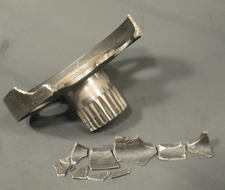

The crack in the rivet hole would lead to the drum failure as every time the pedal is applied the drum is loaded.
In this instance the drum would come loose and end up broken, basically any crack on a load bearing part is not recommended to be reused.
Since we are in business; we can't put bad parts in that would jeopardize the engine or customer.
