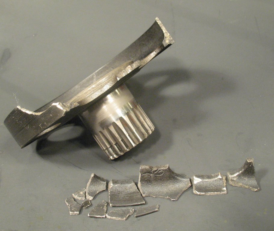

by J and M Machine » Tue Jan 26, 2021 5:00 pm
4banger1988 wrote: ↑Tue Jan 26, 2021 1:21 pm
OK
We have a spray at work that checks welds for cracks.
This spray is also used in engine construction.
Surely it is enough to examine the drums with it ?!
Do you have the one side where the drums are cheaper than Snyders?
Would you drum and statically balance the starter wreath?
greetz patrick
The Dye isn't as effective as the true magnetic inspection machine. I've shown a typical examples.
We are the manufacturers of the drums and gears that Snyder's sells. Our drums and gears are made to exact Ford blueprint in shape and form.
Yes they are more expensive as it is being sold as a unit not just the drum. it is all brand new. We just sold a complete set of drums to Bavaria.
Yes you would dynamically balance the "Flywheel" Starter wreath.

There are cracks to be avoided and cracks of little consequence. The J & M photos show both. The cracked web in the drum makes that drum a throw away. The small one around the rivet is of little consequence. It goes to the inside of the drum hub, and was most likely created in the riveting process when the gear was installed.
That said, I have removed drums from transmissions that have been in service, and have found web cracks and even drum wear surface cracks successfully bronzed and put back into use. The new drums made available mean we do not have to resort to these means and I am thankful for that.

Allan wrote: ↑Tue Jan 26, 2021 7:45 pm
The crack in the rivet hole would lead to the drum failure as every time the pedal is applied the drum is loaded.
In this instance the drum would come loose and end up broken, basically any crack on a load bearing part is not recommended to be reused.
Since we are in business; we can't put bad parts in that would jeopardize the engine or customer.

I understand your position John. Your reputation depends on doing the right thing by your customers, and only sound parts will do in that situation. However, that type of crack at the rivet hole is not uncommon, and if I am correct in my assumption that it has been that way since the rivet was bucked, it is of little consequence. There are others of the same ilk. Cracks from a valve seat into a head bolt hole need no fixing when installing hardened valve seats. Likewise, a crack from a pan rail bolt hole to the outside of the rail. Other cracks are a cause for great concern, especially those emanating from the rear main boss in the block!
