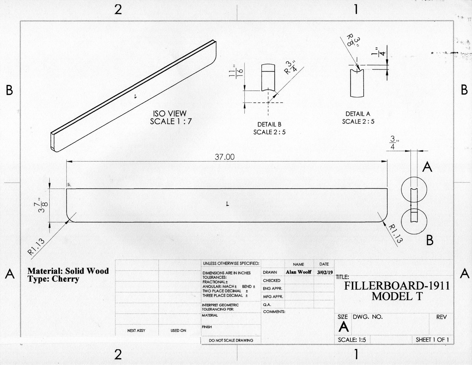

I am starting this topic to help answer Art Ebeling's question about Dash Fillerboards for the 1911 cars. My brother owns a 1911 Touring built in August 1911. This was the car that came out of the Ford dealership in Dublin, GA. During the restoration we were able to use the original fillerboard. I created a drawing from the original fillerboard on his car to answer Art's question. It is attached below and can be downloaded and printed.
The car was built in August 1911. There is no brass trim on the fillerboard. The board has radii on top and bottom. The radius on the bottom does not match the original brass trim very well. This probably typical of most cars. The radius on the top matches the windshield tubing.

The measurements are what I needed and your help is greatly appreciated. Art

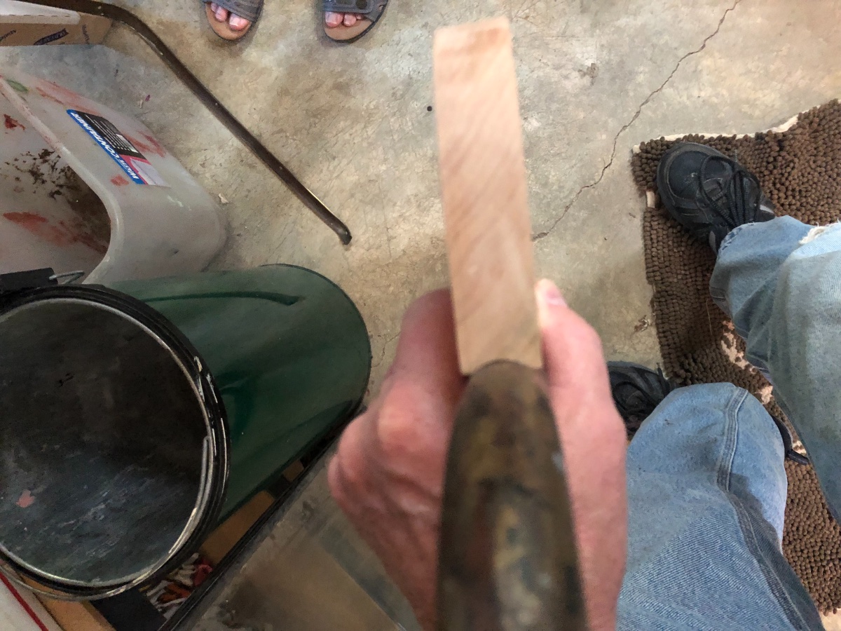

Using the plans in post 1 from Alan, this is how The finished fillerboard turned out.Thanks for the help. Art
