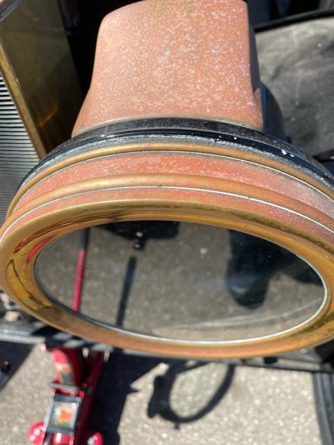

Hello,
I don't know much about brass parts on a Model T. I was wondering if these parts could be cleaned up and how to go about it.

Any idea what it's been exposed to ? Looks nasty as if some chemical fallout gas eroded the zinc from the brass alloy leaving copper. Antifreeze will do that. Usually the brass items will respond to a good brass polish. You could start there and see how it goes.

To easily get the hard crusty brown layer off, use a homemade paste of real lemon juice and baking soda. Mix it fairly thin more soupy than toothpaste. Be sure to remove this paste when you're done with clean water. Then brass polish and elbow grease.

Your radiator shell is solid brass. That brown layer might be an old damaged coating of lacquer that was applied to protect an old polish job. The fact that only the horizontal surface of the brass appears to be affected may be a indication that it was caused by the sun and the elements. If it is old lacquer it can be removed with lacquer thinner and polished with “Meguiar’s Ultimate rubbing compound”. If it is not deteriorated lacquer, the brown is most likely tarnish that can be still compounded off with “Meguiar’s Ultimate Compound”, which is what I prefer over metal polishes. Apply a dab to a folded cotton cloth like an old tee shirt and with two fingers, rub in a circular motion until the brown starts to disappear, revealing the brass underneath, then continue rubbing until you can clearly see yourself and the landscape behind you. The mirror shine you get from the rubbing Compound can be enhanced and refined with “Meguiar’s Ultimate Polish”, applied in the same way. “Meguiar’s Ultimate Paste Wax” will offer some degree of protection to the shine, without obscuring the shine like lacquer sometimes does. Jim Patrick

Oh....this is good information. I was concerned that the brass was permanently damaged or those parts just had a thin brass plating over steel and that was rust bubbling up from underneath. It sounds like the right chemicals and some elbow grease will make these look like new.

I am certain that you parts are solid brass, but it wouldn’t hurt to check them with a magnet. Jim Patrick
