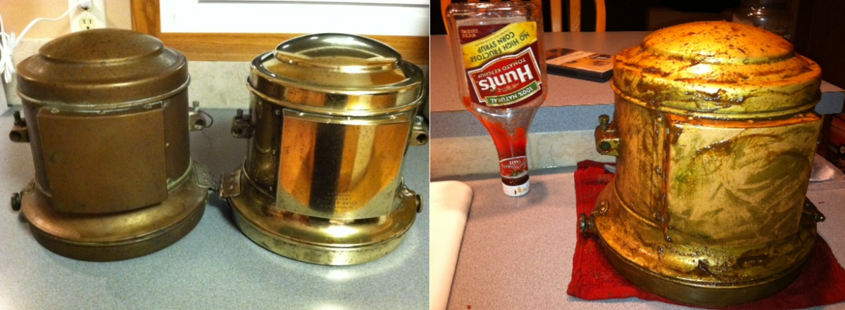

Its important to distinguish products for cleaning badly tarnished brass (copper bleeding) from products that excel at polishing lightly tarnished brass. Having said that, efforts may also be hindered by some surface coating like lacquer, spray paint or wax. Also if the item is solid brass or plated.
NOTES from the INTERNET:
1. Brass is mainly an alloy that consists of copper with zinc added. Brasses can have varying amounts of zinc or other elements added. These varying mixtures produce a wide range of properties and variation in color. Increased amounts of zinc provide the material with improved strength and ductility. Brass can range in color from red to yellow depending on the amount of zinc added to the alloy.
2. Generally, brass corrodes when the zinc, copper and tin components of brass alloy are exposed to water. This is a danger for brass pipes, exterior window casings and the hardware on boats. Corrosion in brass is easily identifiable by reddish or pink splotches on the surface of the object. In addition to the impact of water, exposure to mercury and ammonia can also cause brass corrosion.
This link gives step-by-step approach to "cleaning" brass and also several DIY cleaning solutions (most of which others have suggested). https://www.architecturaldigest.com/sto ... lean-brass
This previous discussion about "cleaning"
Used ketchup http://www.mtfca.com/discus/messages/25 ... 1329602801
Cleaning Brass parts with a solution of White vinegar and Salt. http://www.mtfca.com/discus/messages/29 ... 1203713399
Various methods this picture is one from Steve Jelf (I had also used this with great success) https://mtfca.com/phpBB3/viewtopic.php?t=6241
