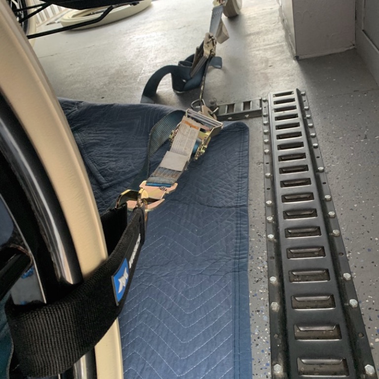

I just loaded this 1915 Model T Runabout up
in Bolton, Massachusetts.
Going from one family member to another 😉
This trip will be unique 🤔
I have to pick up another Model T in
Michigan that is also going from one family
member to another.
Since 2006 - I have personally transported over
(400) Model T’s of just about every body style
and configuration.
A few years ago - I standardized tie down
Methods for all Model T’s & Early Brass Cars.
If the wheels - spindles - bearings are secure
and in good order:
Mac’s axle straps thru the wheels
Ratcheting nylon straps from the wheel
Back to the center of the vehicle in line
This holds the car together
This helps keep the car from “ walking “
Across the trailer floor
I have etrac installed about every four feet
Width wise across my trailer
FJ
Google “ Model T Transport “
